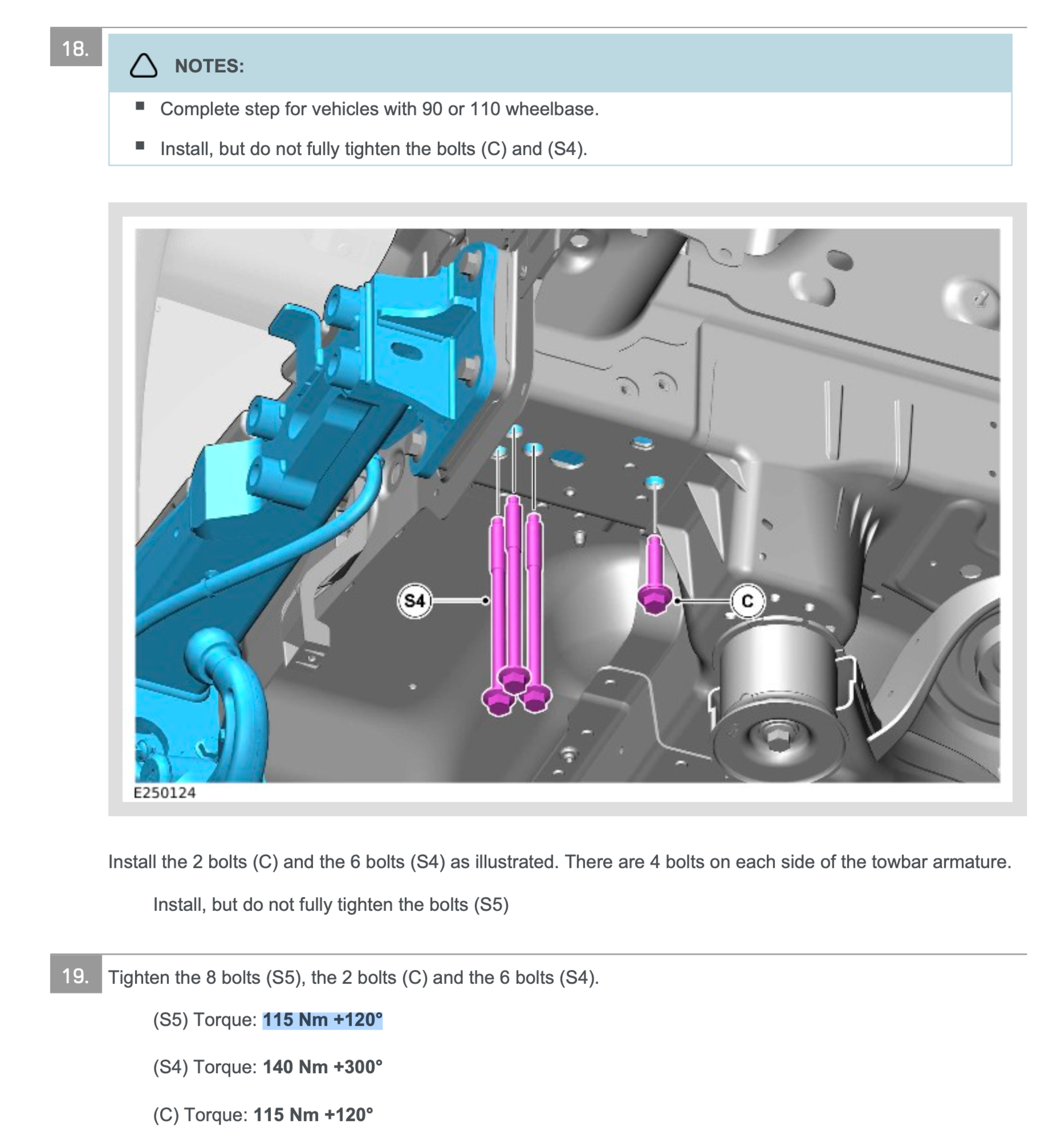

Putting the black tow hoops on my Defender SE. Does anyone know the torque spec for the 8 bolts?

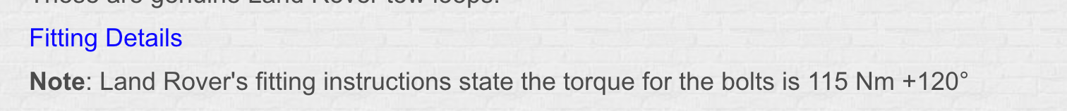

Per PowerfulUK, it's 115 Nm +120°.
In the PDF shop manual posted here, it's 170 Nm for the plate that you would screw the eyelets into. The shop manual doesn't seem to specify it for the tow loops. I'm worried Simon has the torque spec for the entire tow bar assembly instead of the tow hooks.
