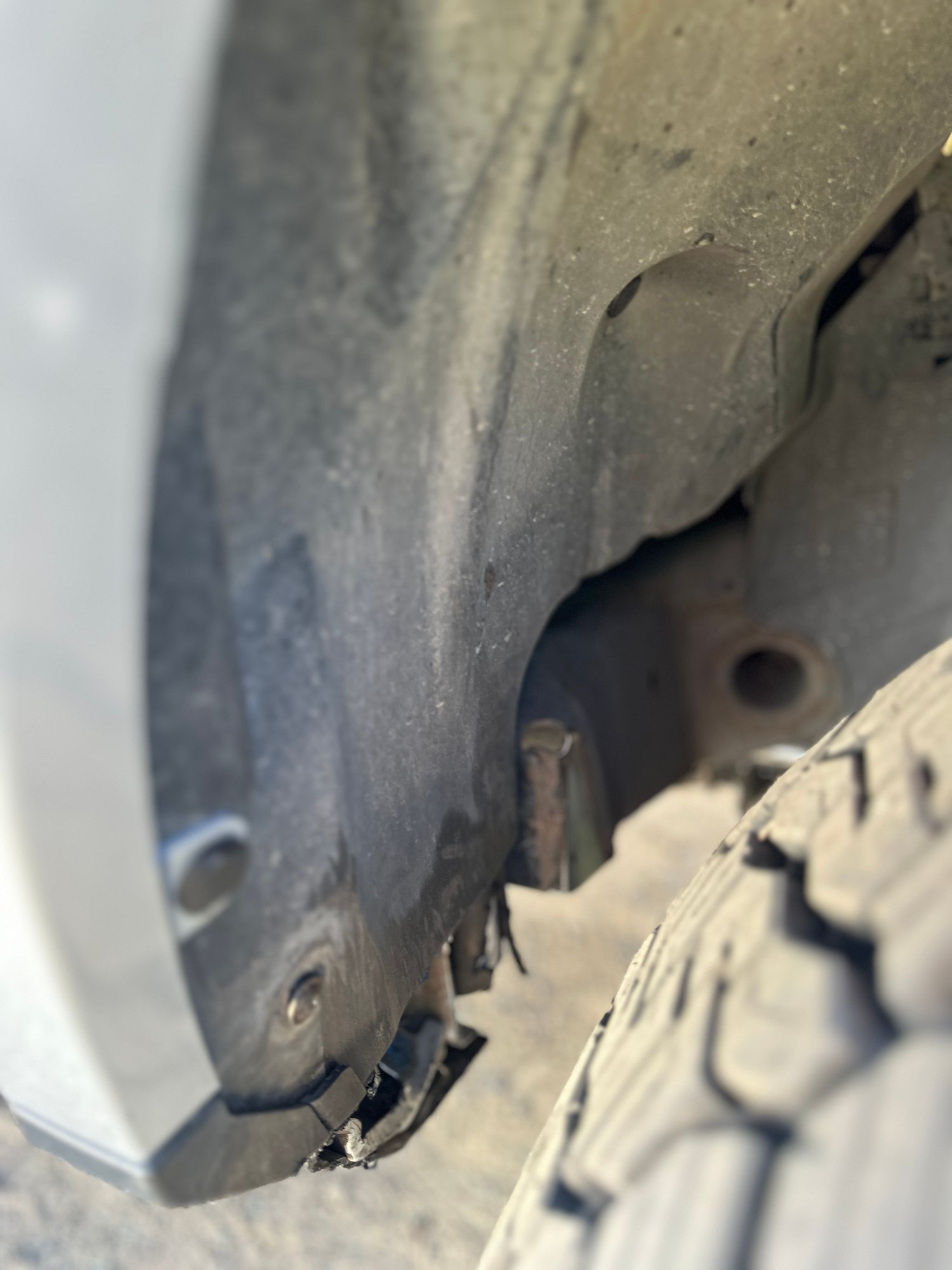

Sad part of my story -- before realizing how the laws of geometry work, I went full-bore into slicing and dicing my wheel well apart. Pic below.. Even after doing this however, really didn't fully solve issue - still massive rubbing of frame horn, and tire still came unacceptably into contact with the fluid pipe and body panel.
Happy part of story -- in a stroke of "duh" realized the spacers were working against me, pulled them out and completely solved the body panel/wheel well rubbing issue. Turns out I never needed to cut anything ($160 later and new wheel well inserts are on order). The tires still do a fair amount of rubbing on frame horns when at close to full turn - not a huge issue.. wish it wasn't there, but seems like that's the price of 33"s. Can also safely say - 33" is the biggest tire going on these trucks without permanent mods. Truck drives as awesome as ever and no noticeable difference at highway speeds. I will also add - I would think the 33"s make true offroading a bit sketchy.. have to imagine if go over any slight obstacle when turning, the suspension articulation is going to cause some pretty massive rubbing on the frame.. So I think the best answer here is to just avoid turns lol.
