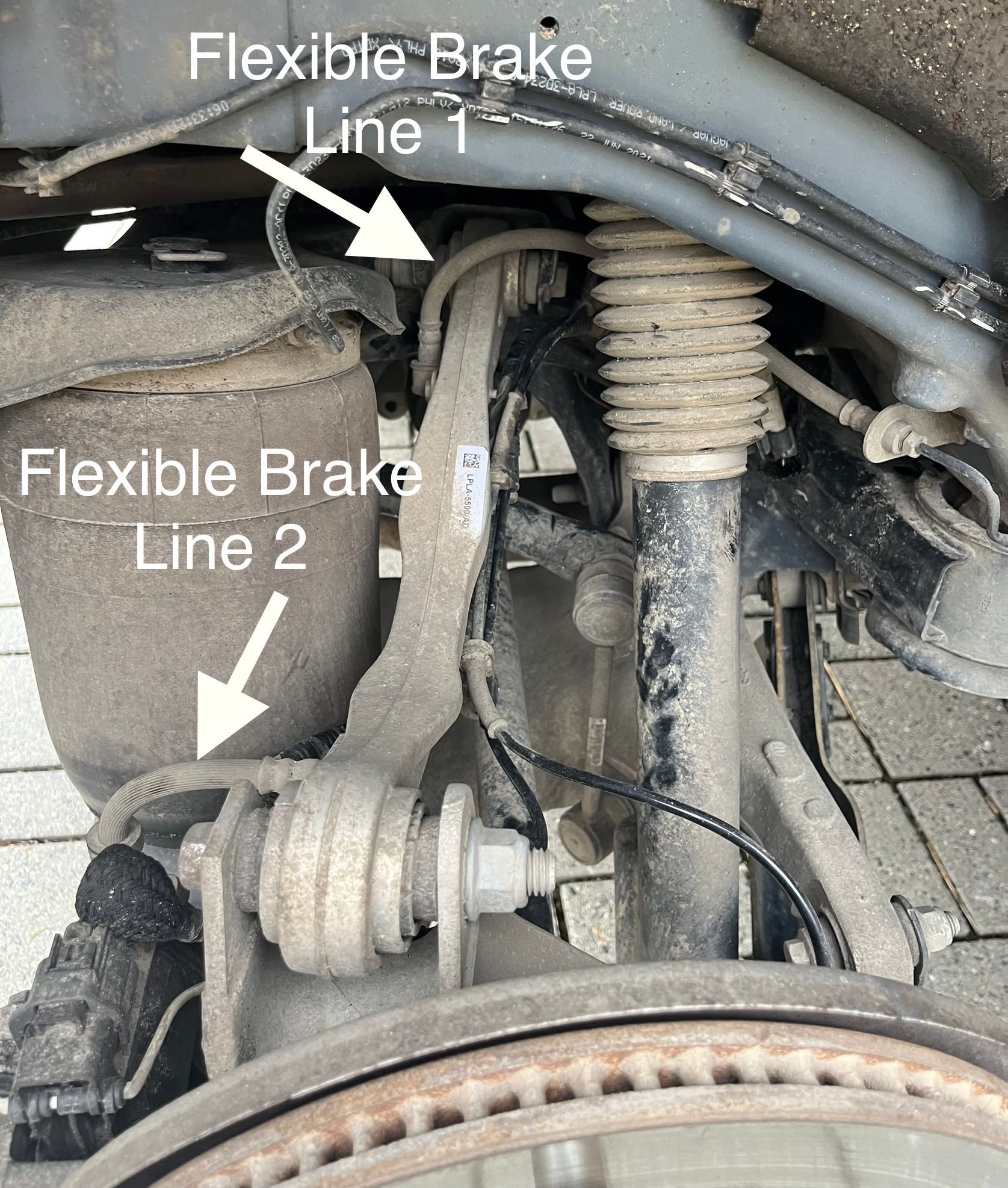

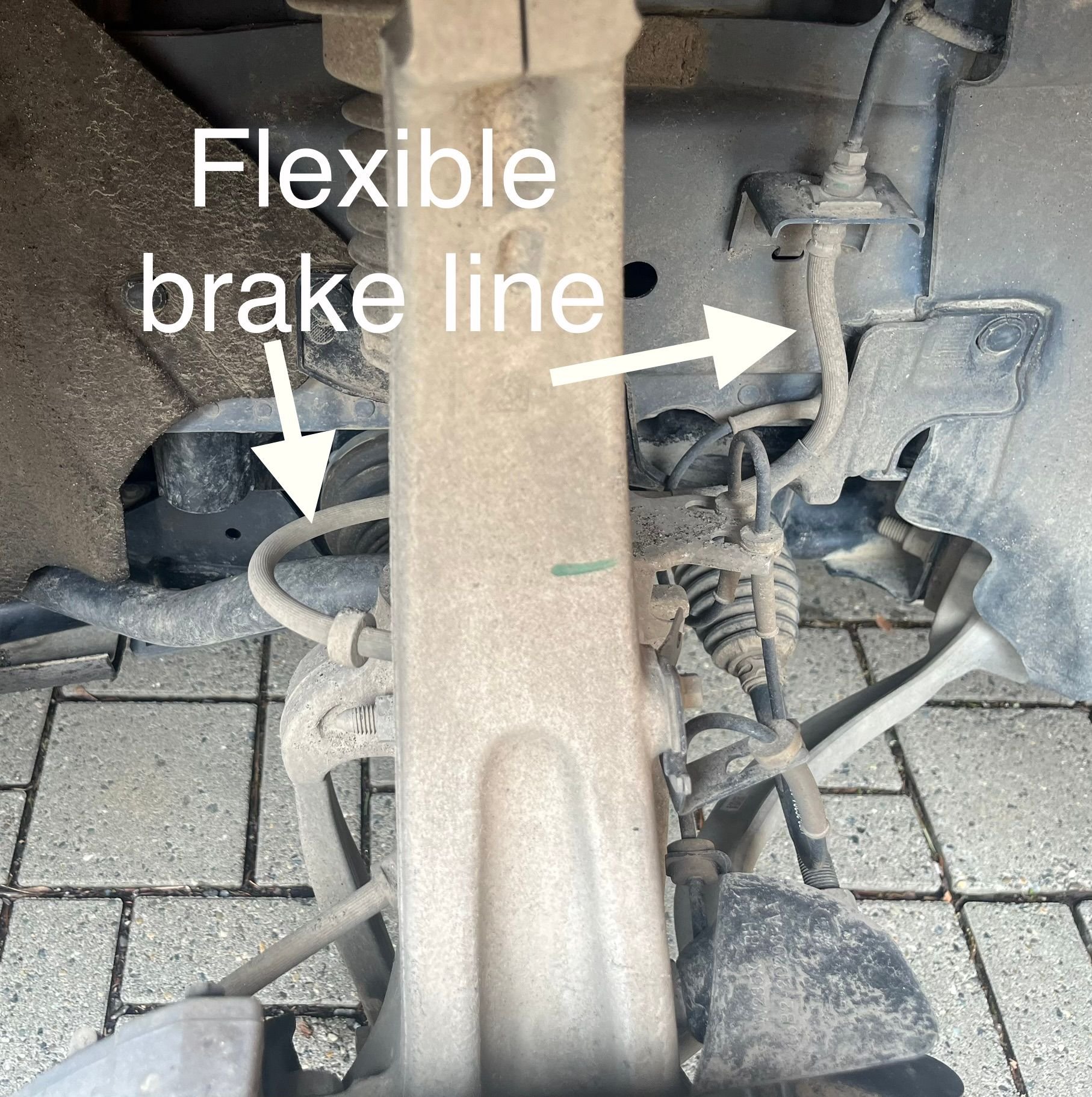

I’ve not finalized the part numbers but looks like there are two separate hoses on the rears wheels and a single one on each front.
Front  P400
Front P400
Rear. P400
Rear. P400
