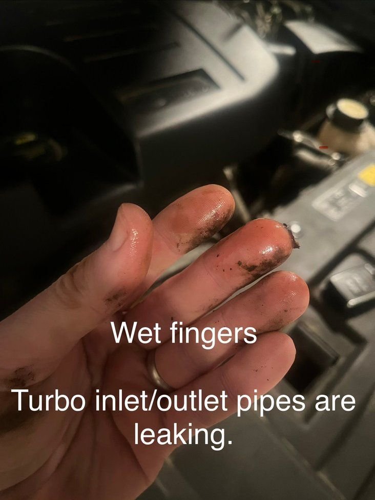

Superb info in this thread. Thanks for those who have added to it. I discovered a leak where these pipes attach to the turbo. Just reached in there and felt it. Wet where there should be dry.
Is this all the parts needed for this repair? I'll have a look at the shop manual but what's the easiest way to get to these. I'm thinking that going via the wheel well might be the best. Any tips info would be greatly appreciated from those in the know.
I'm shopping now.
Old part numbers
LR121417
LR121762
New part numbers
LR183050
LR183052
$146 plus tax and free shipping from FCP Euro. Not too bad.
