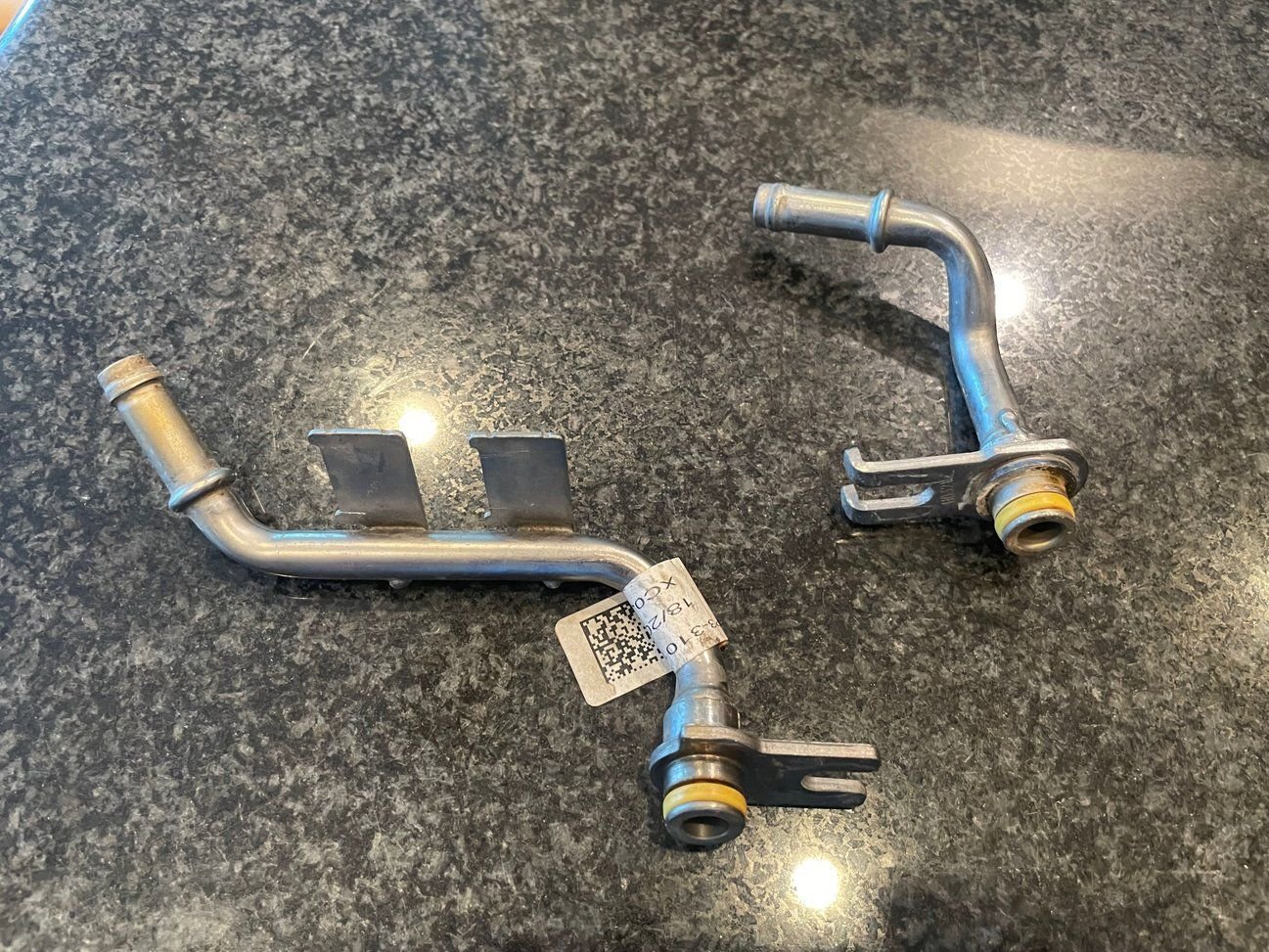

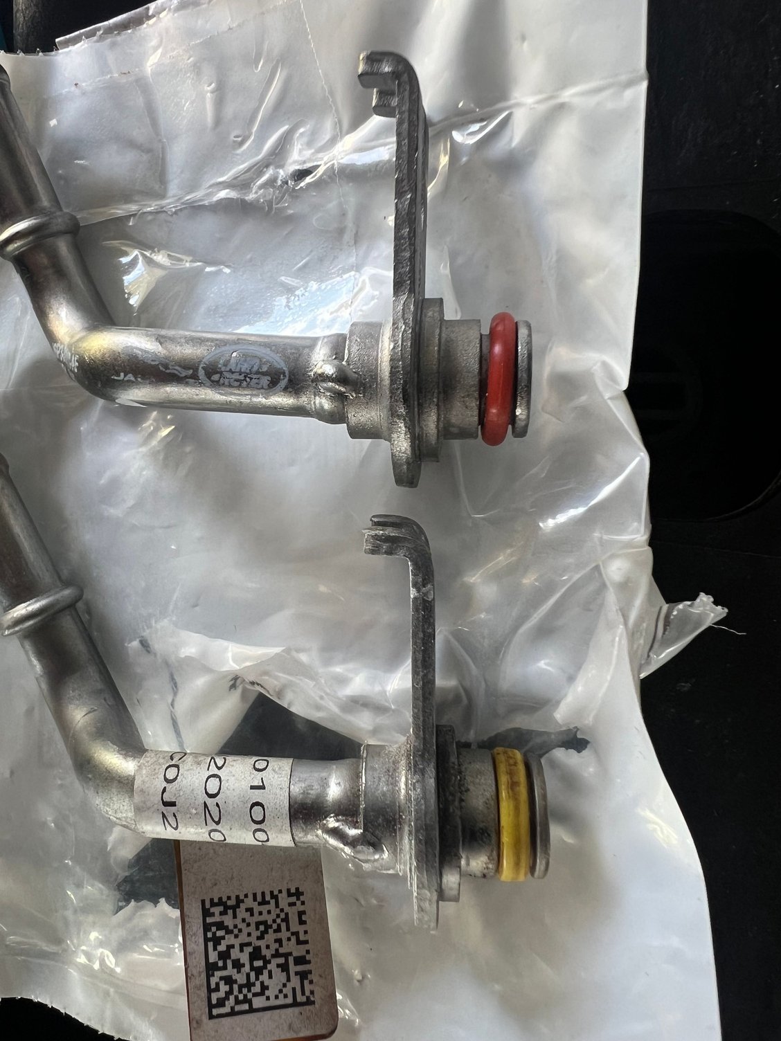

Hey @GavinC surfacing photos of the original lines on the original poster’s car here. Do the new lines you got (that you’re returning) look exactly like this, or did the design change? Based on the pics (you texted to our group) it looks the same to me. ?
Old Mar 6, 2026 | 09:16 AM
  #32
GavinC's Avatar
Joined: May 2021
Posts: 2,582
Likes: 3,655
From: Kirkland WA

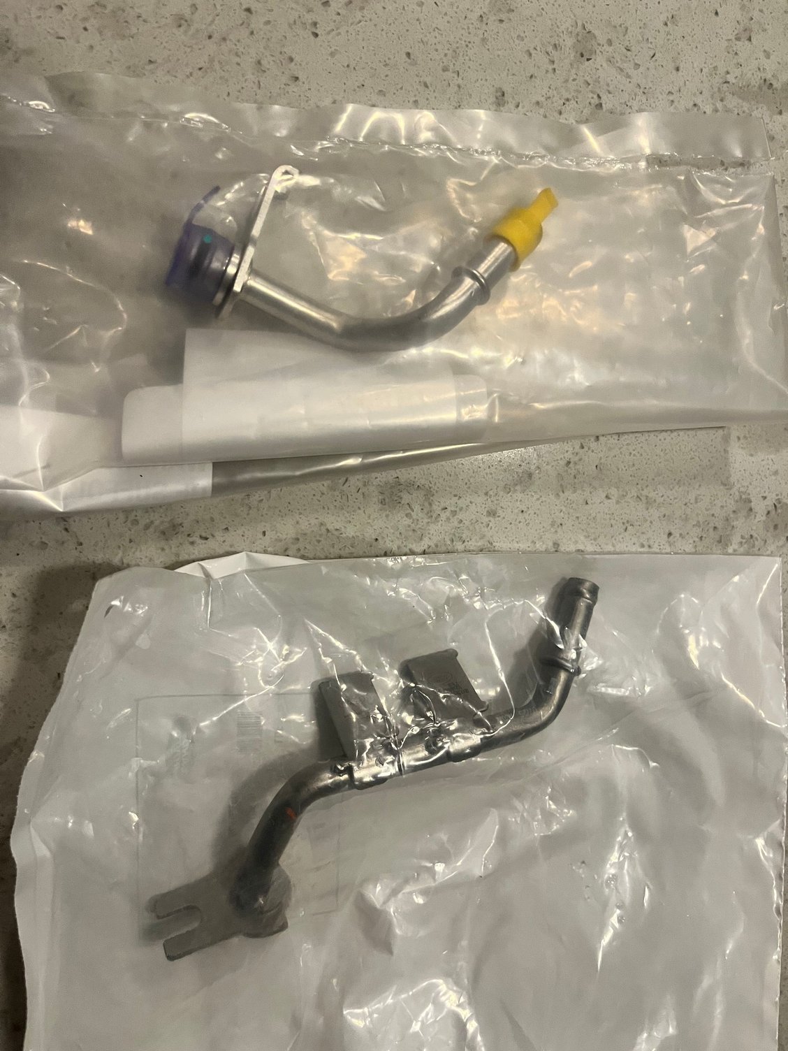

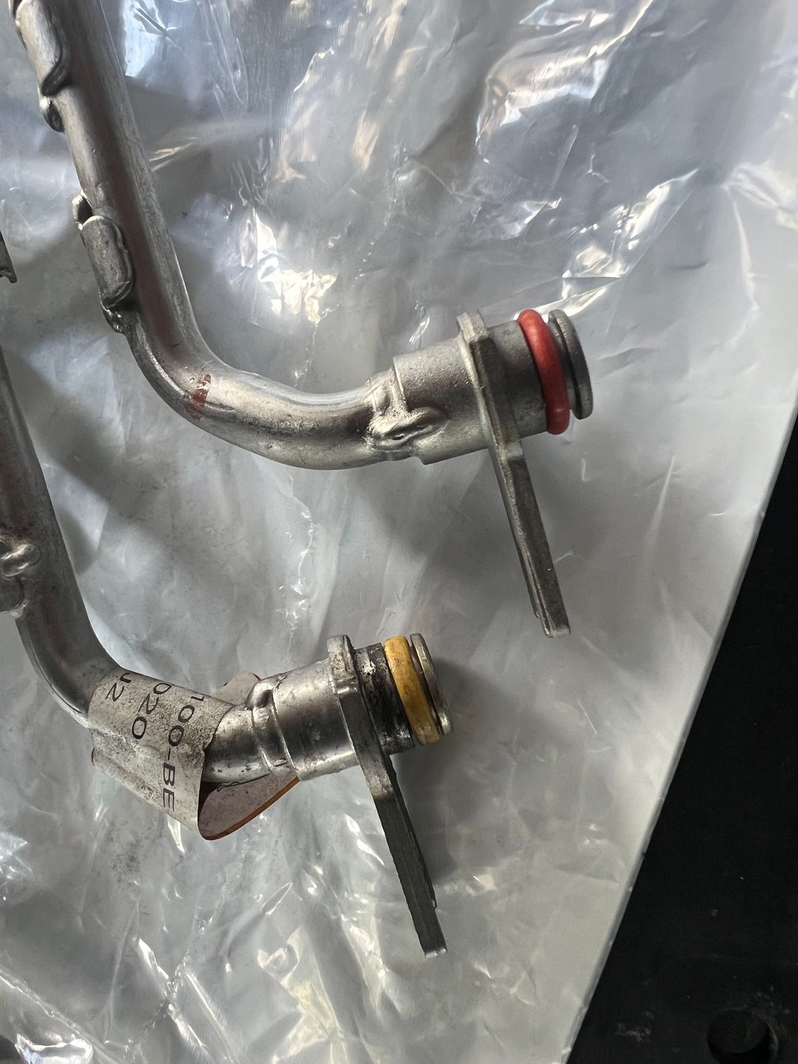

One is OEM (the longer one with the two metal tabs for wiring and a metal pipe to click on ) and has a red o-ring. One is OE (Rein Automotive) and looks like it has a black O-ring under a protective shipping plastic cap. Other than the o-ring colors, they are the same part. Identical.
I''m leaving them in their sealed packets till I try just the o-ring swap so my picture is a bit potato-quality.

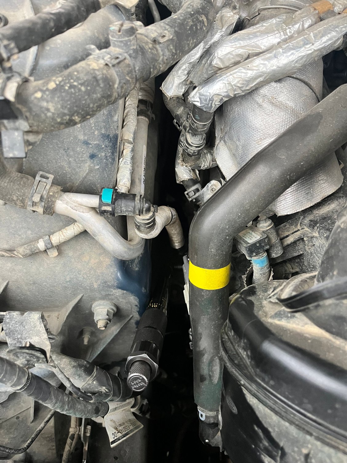

I was trying to figure out where to clamp the hoses. Both are encased in metal heat shielding by the looks of it. I'm struggling to see where I can crimp them.
The bolt is on the side of the turbo, not the rear as was thinking. Hopefully I can do this 0-ring swap from the top only.

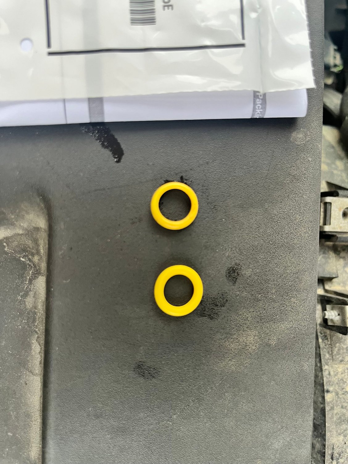

These
were the original and newest at the time when I did mine in April of 25. Yellow o rings were original, orangey red were new.

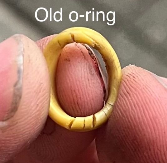

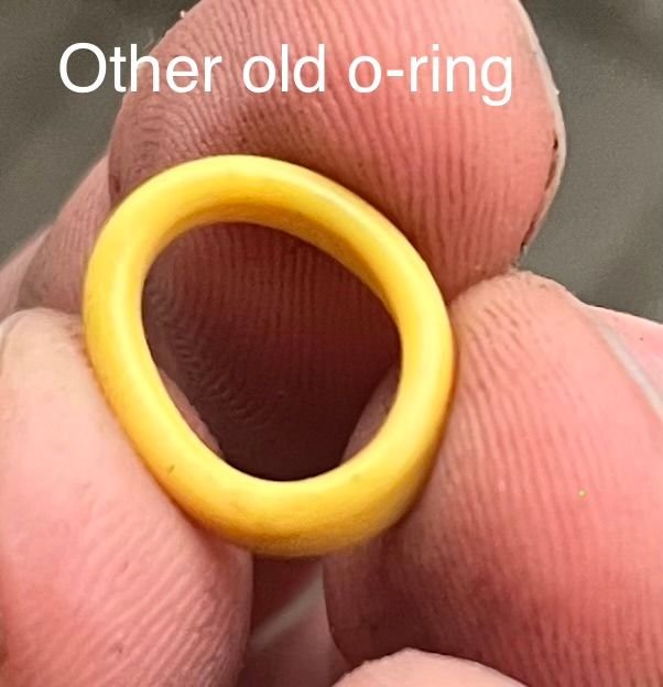

Default O-rings 20 mins. All done from the top.
I just completed this repair.
I replaced both o-rings
  • Remove the bolt
  • Disconnect the lower pipe from the turbo. It is easy to get to.
  • Swivel this up and replace o-ring
  • Unclip one wire and one narrow bore metal pipe from the other hose.
  • Disconnect this upper pipe from the turbo and finagle it up.
  • replace the o-ring
  • Everything goes back in reverse.
  • 11Nm or 97 inch pounds on the bolt.
Thasks for all the helpful posts. Much appreciated
