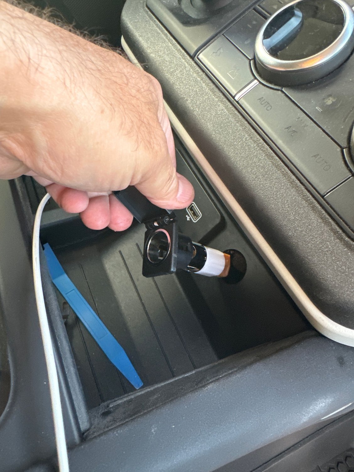

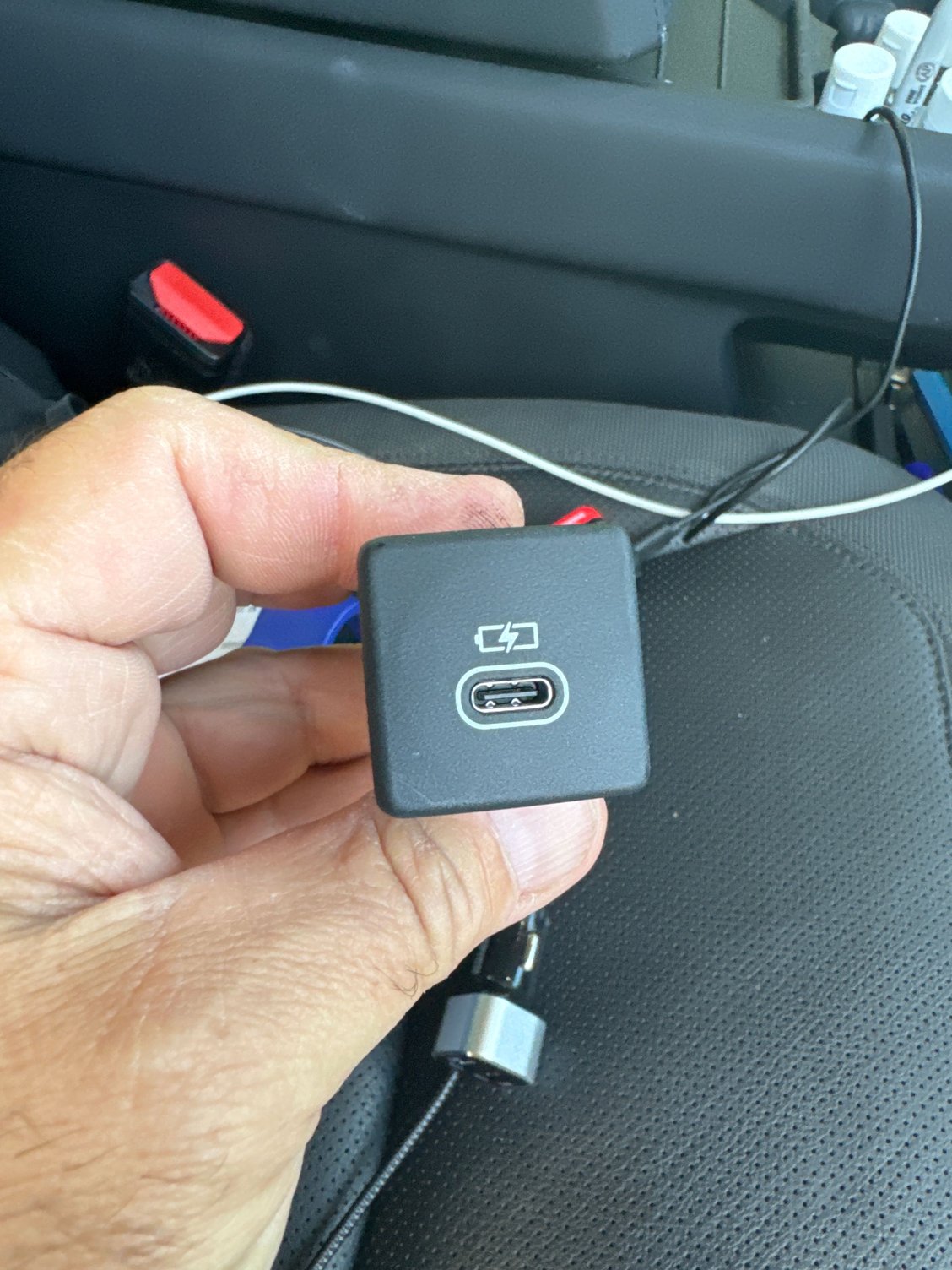

I don’t know what I did. I popped off the 12v cigarette plug and installed a new usb-c but it didn’t work. I reinstalled the 12v lighter plug and it doesn’t work anymore either. What did I do wrong?
Did I blow a fuse?

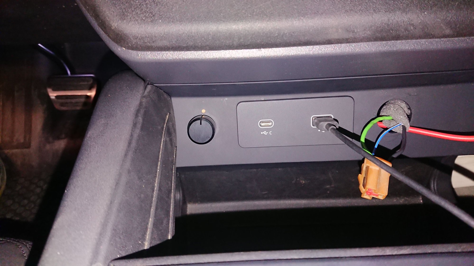

I did the same conversion, but hard wired them, so 24/7.
( Cant't get the light working)

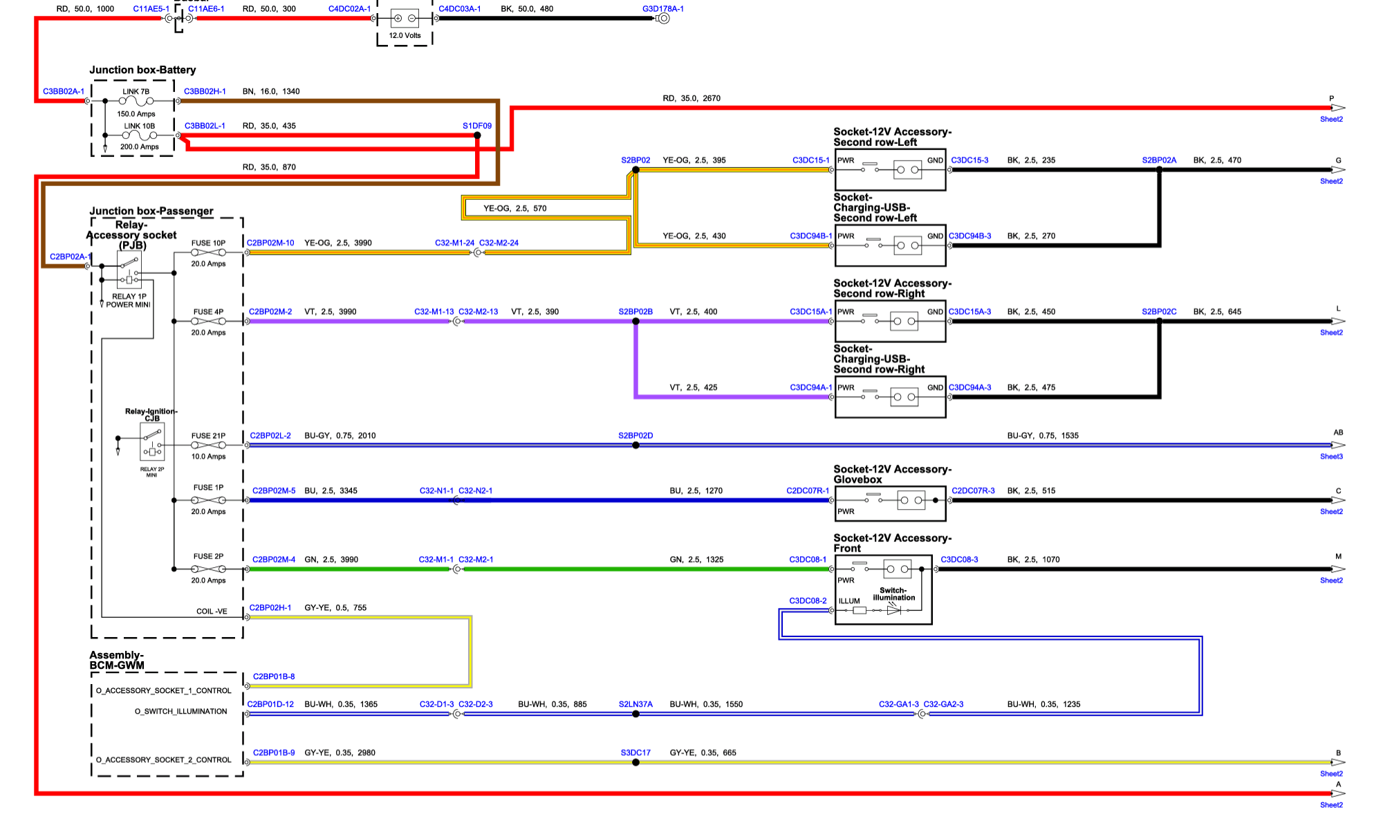

I just did cut the Green wire, isolated the original direction. Routed a new wire 12v from battery+ and connected that to the Green wire left on the socket. See last on the below diagram. Socket 12v Accessory Front
