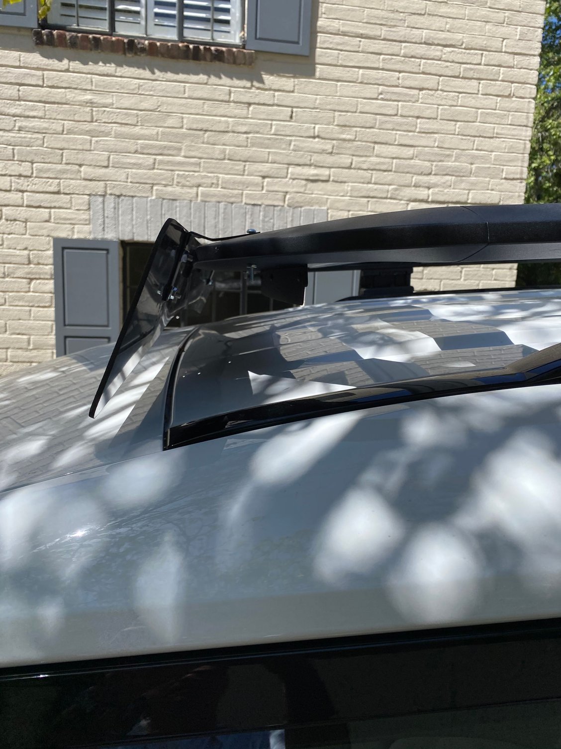

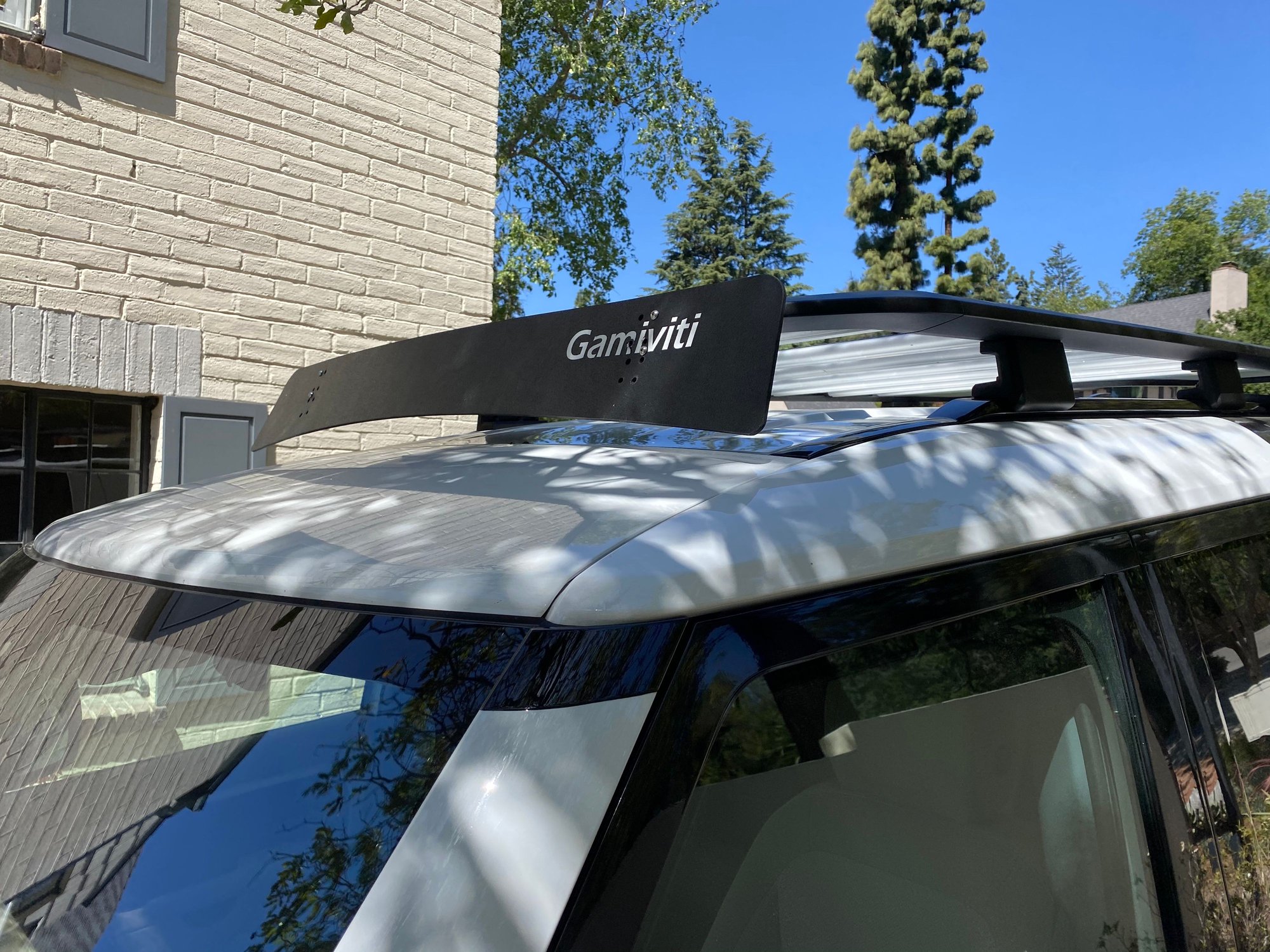

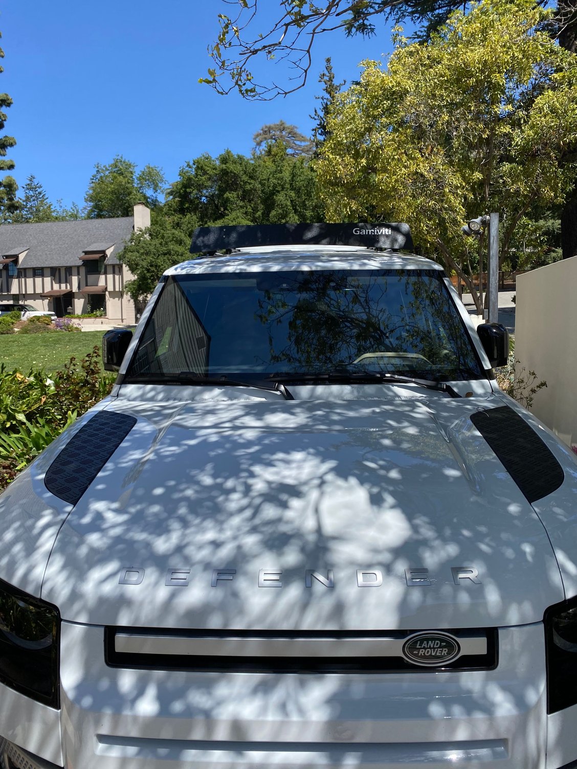

I used this old gamivetti piece
from a previous rack and attached with three inch brackets from Home Depot. Bent the bracket another 15 degrees, drilled two holes and used a 2-1/2 inch bolt. Brought the wind noise down significantly.
Old Apr 19, 2021 | 03:56 PM
Btinnermon's Avatar
Joined: Apr 2021
I used a Gamivitti piece off my FJ62 and 3 inch brackets from Home Depot. Added 15 degree bend ad put in with 2 #8 bolts. Quick fix and made a major difference in wind noise from 60-90 mph.

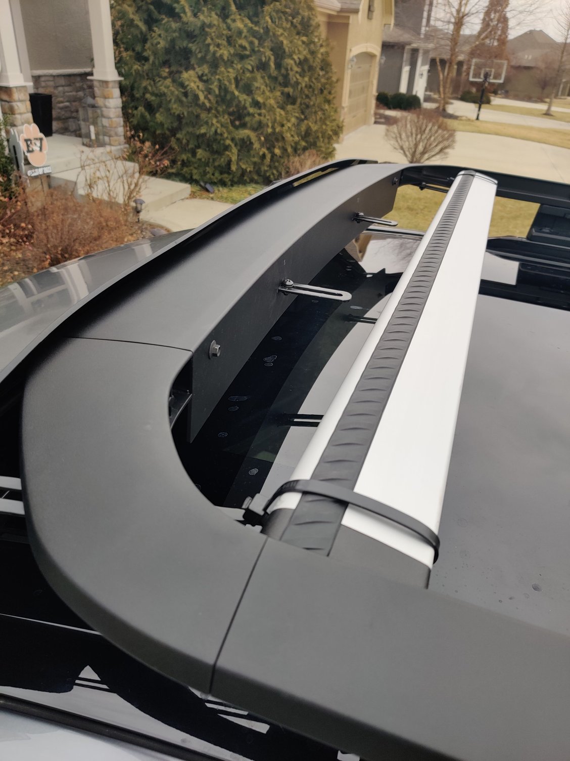

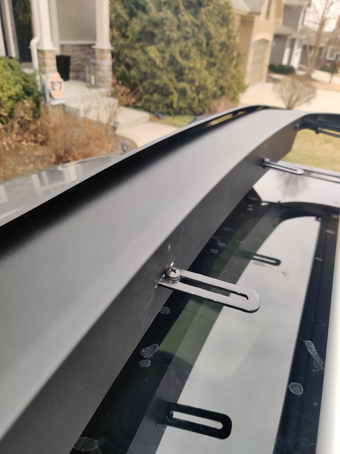

I went with Colorado Fairing Company. Took me some time and testing to arrive at what, I think, is the best setup. It took cutting two slots into the stock wing deflector. But very small/minor and could be easily patched/hidden if I ever wanted to revert to no-fairing setup. The amazing part, I was able to achieve a 7db drop in wind noise at 80mph. I can have normal conversations and no longer have to adjust the volume of my radio when on the highway. Very happy.
