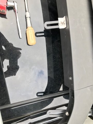

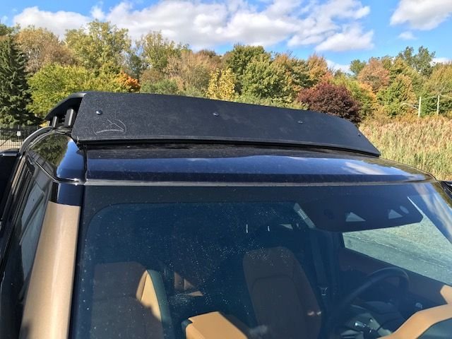

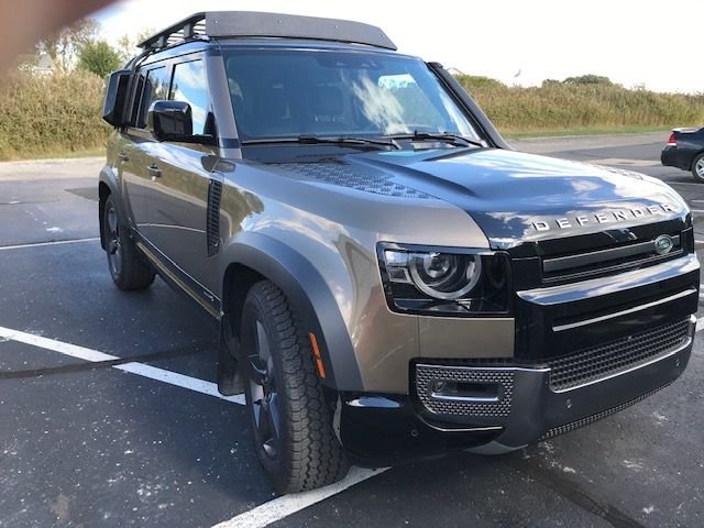

Well It is done! It took about 4hrs with my friend and I outside my garage, It is the Colorado fairing, I did make a couple changes to the original thread owners install. Mine is done more like the instructions from Colorado fairing. I did remove the front cross piece and did the work on my work bench.
#1 I changed out the exposed screws in front to Black chrome, they don't stand out as much.
#2 the side fasteners are screws, washers and self locking nuts, with there brackets.
#3 I made 1"x1" aluminum L brackets and zurt nuted them to the front rack. Then used screws, washers and self locking nuts.
As far as the results, for us it was more then worth the money. In my opinion it reduced the wind noise by 90% it is truly a life saver when it came to the turbulence noise,
