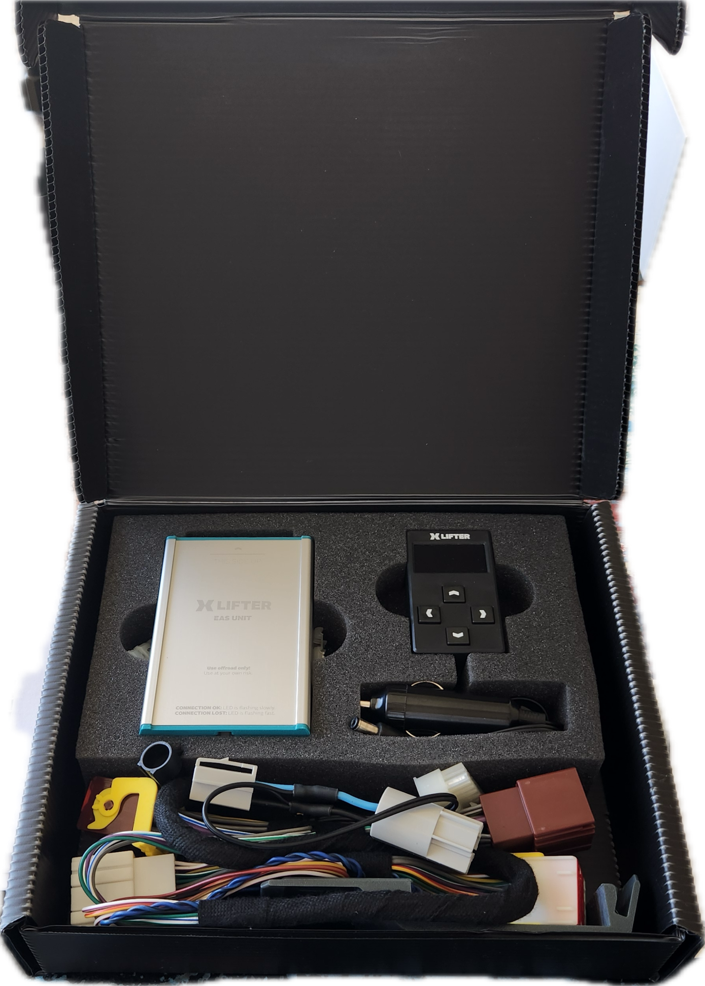

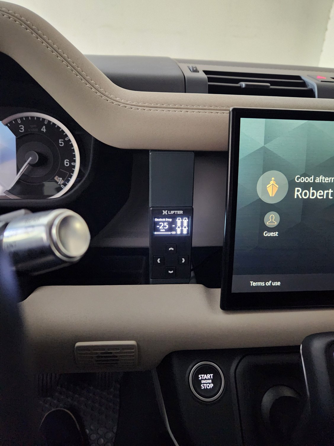

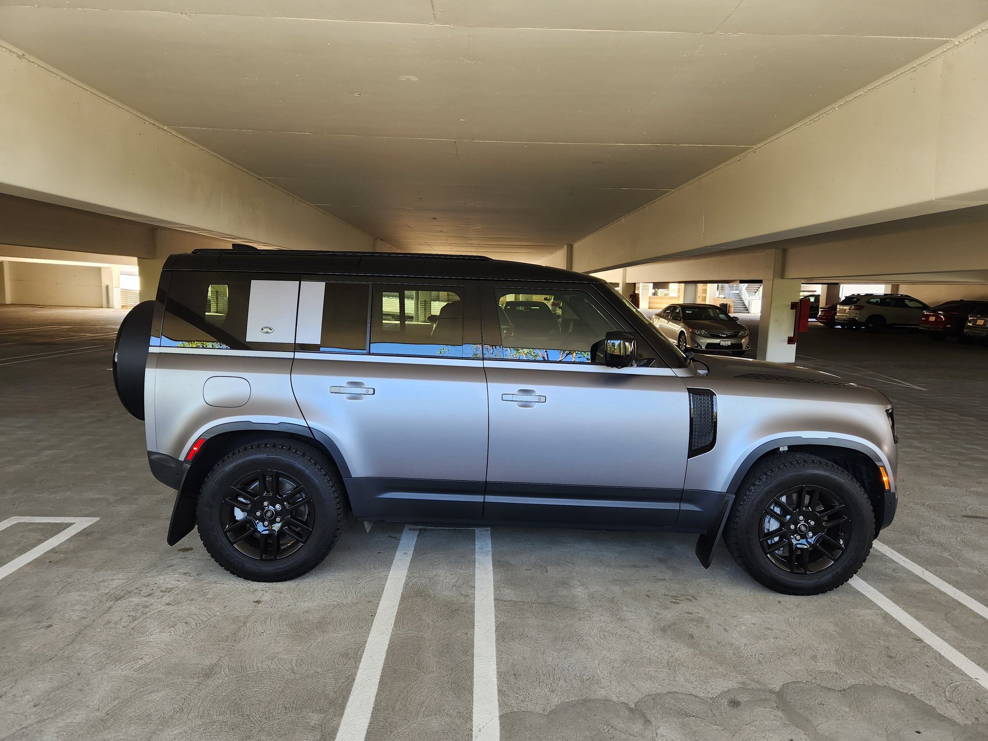

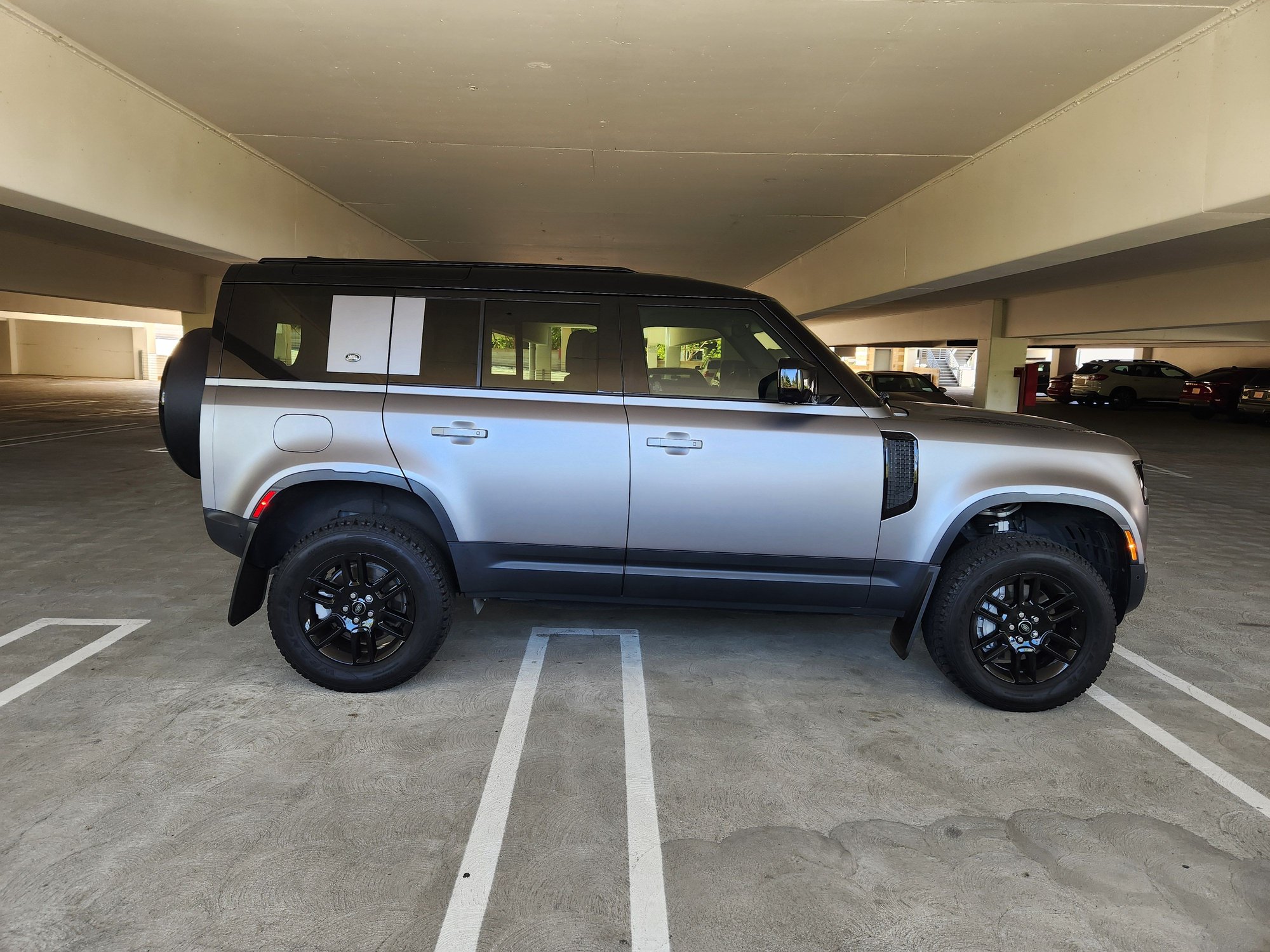

Installed xLifter on my 2022 Defender. Allows for 7 preset ride heights from minus 35MM to plus 75MM. Can adjust on the fly and has an auto leveling feature.Love driving on highway at minus 25MM drop when using the software hack for Dynamic Mode. Great product in my opinion and took approximately three hours to install taking my time.

This is very cool, love the physical controls, and your placement of them, very clean install. I was looking into this a while back, i remember reaching out to them before they had defender support. But then I discovered the GAP IIDTool, which can do all the same stuff, and it needs zero install, and is about the same price. It's also super valuable for a ton of other stuff, the height offset/adjustments are almost it's least useful function. It is obviously less convenient to make changes on the fly with the IIDTool, so if custom offsets to the default heights (so you can swap with the OEM height controls) aren't enough for your use case i see the value in the convenience. I'd still recommend getting the iidtool for customizations/diagnostics, you'll need it to properly bleed the brakes for example. Not to mention having the car remember the state of the auto start/stop button is a life changer...
