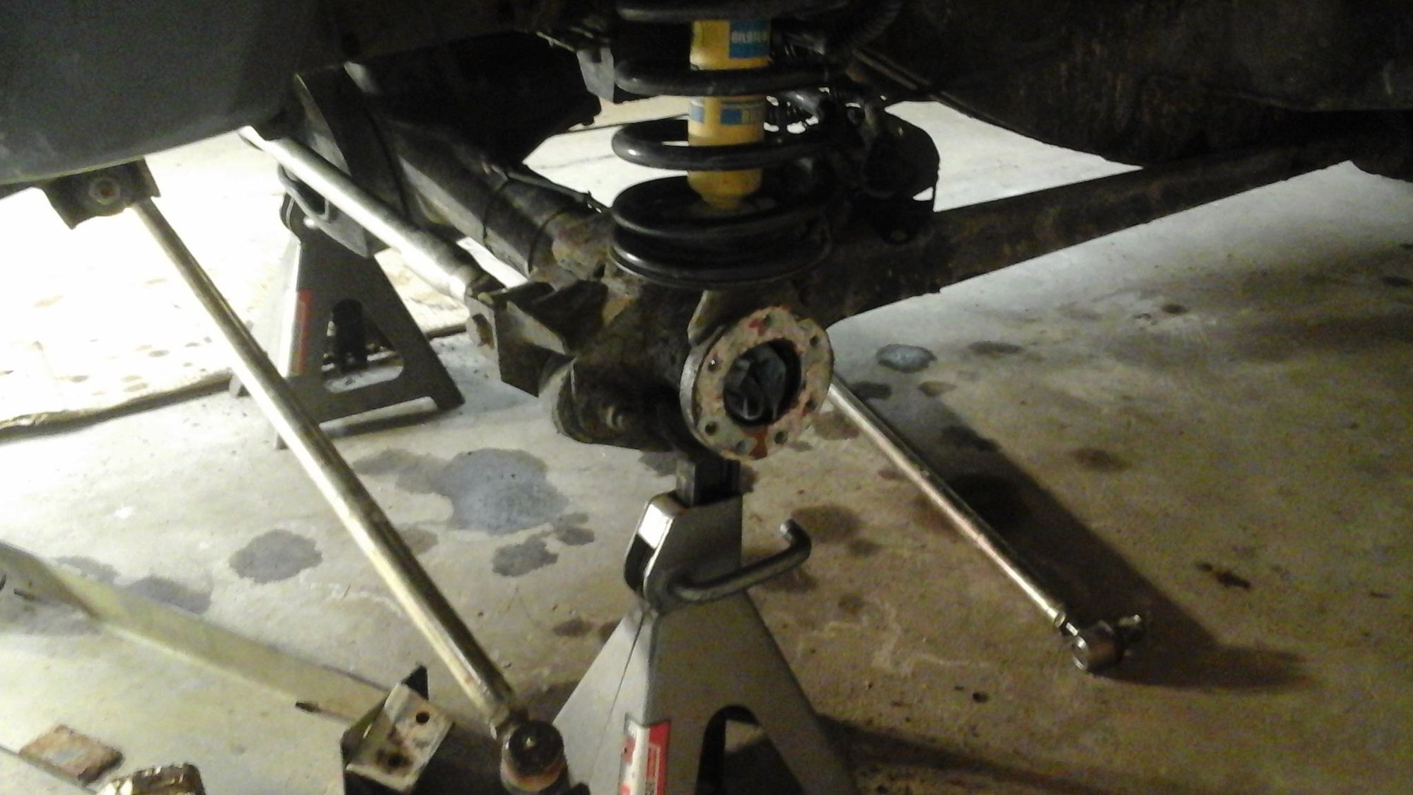

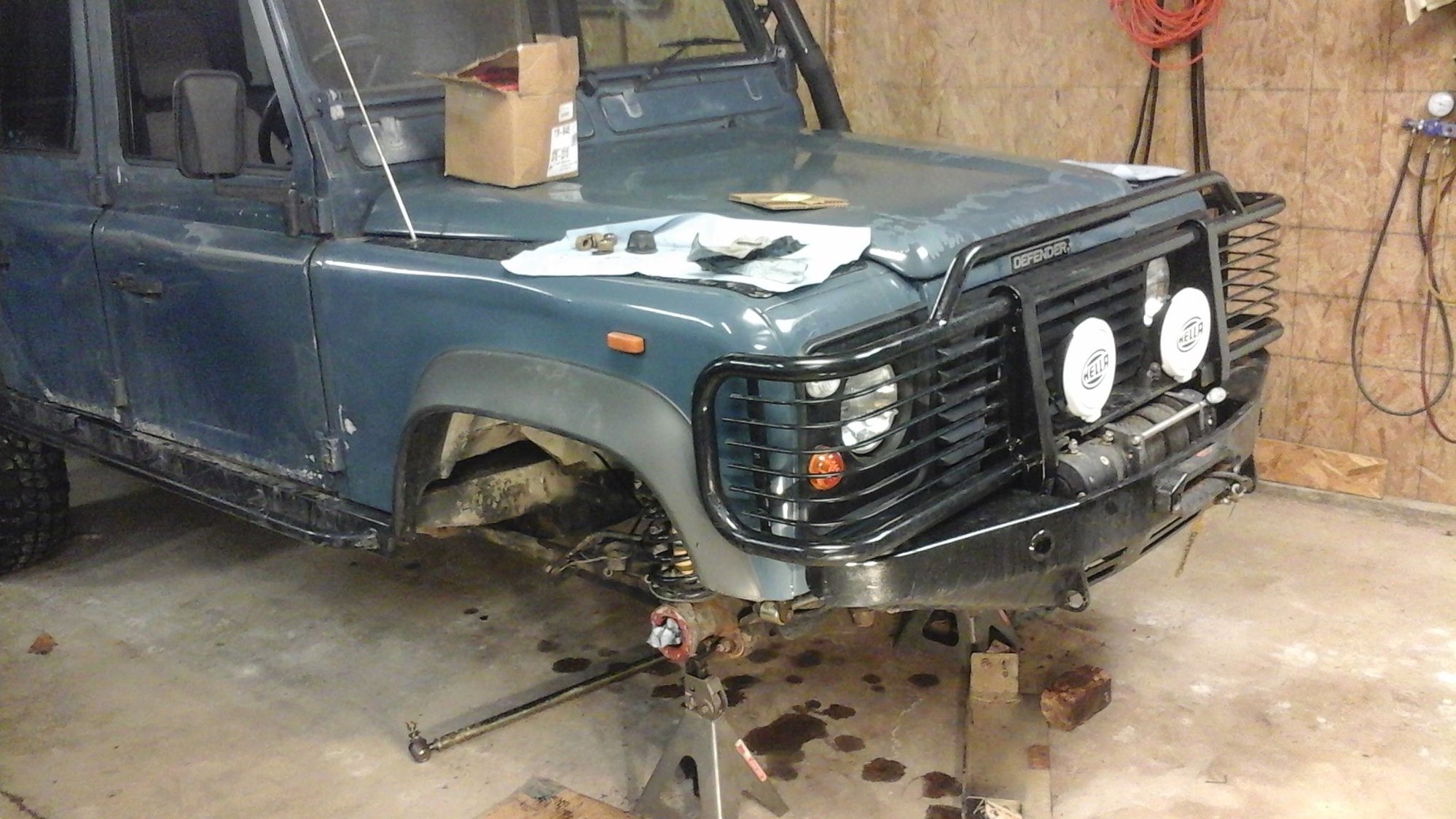

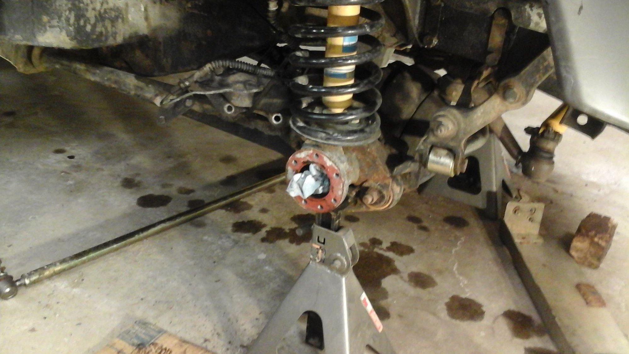

Waiting for axle seals and C/V joints and cleaning up parts tomorrow. Have swivel ball seals, so l'll get them on tomorrow. No rush for the other axle related repairs, plenty of other projects to tackle. Been working on my lift spacers, going up another inch, just need a bit more hand filing...to whip them into shape. I've been rearranging the battery compartment, so it will hold two 1100CCA batteries. Scavenged a couple nice heavy battery cables that will run directly from the battery, ground and positive, to winch and power terminal under the hood for adding accessories.

Yeah, this project was long overdue. Should have paid more attention to the swivel joints and grease level...and l 'probably wouldn't have had a C/V explode. Left side was completely dry, needs bearings and pivot assembly...but the ball looks salvageable...small...dime size pitting...along an area that just touches swivel on full lock...so l'm going to expoxy area, sand and hope for best...l'm pretty sure it will be fine. Still waiting for parts from one supplier, damn, l've received stuff from England faster. Not going to mention any names, yet...but l'm somewhat disappointed with this and lack of emails confirming shipping and tracking number.

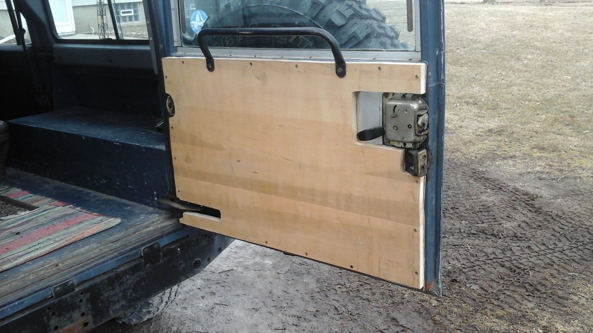

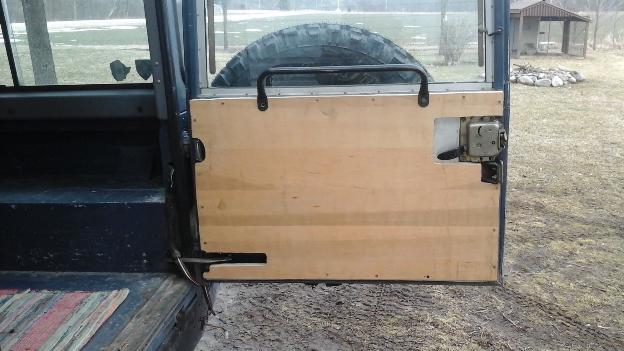

Started messing around with rear door panel. Want to go old school, wood floor, cabinet and rear door panel. This is rough stage, will come off, be sanded and stained...eventually.
Fitted a piece of aluminum behind the wood, to stiffen up the whole mess. The plastic cover will be put in place, over lower slide mechanism, when done. Using the rear wiper motor switch/or/defroster element power for rear lights on rack.
