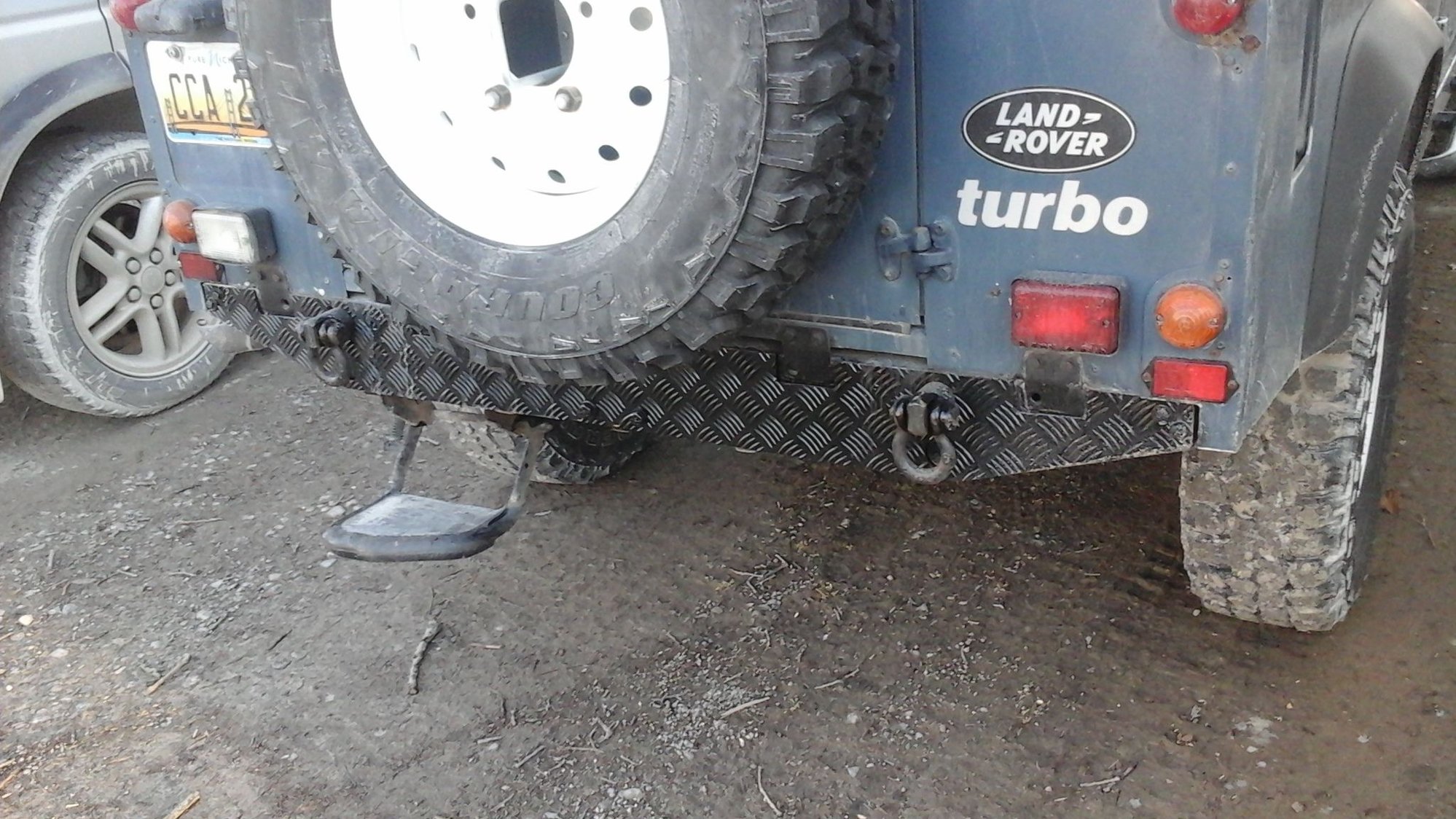

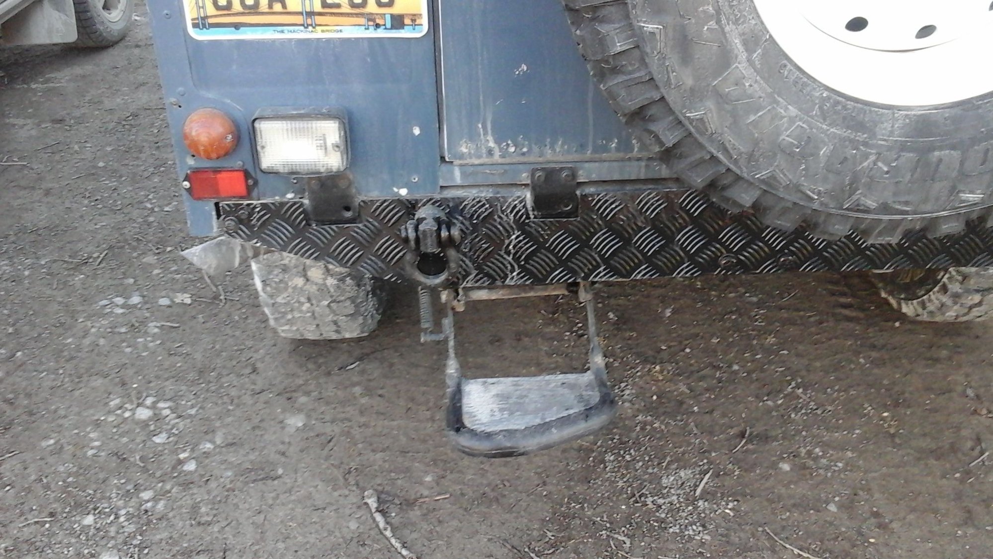

Added a diamond plate (not really diamond plate - british use a different version...chequer plate) to rear bumper and a couple recovery points.
Brian.

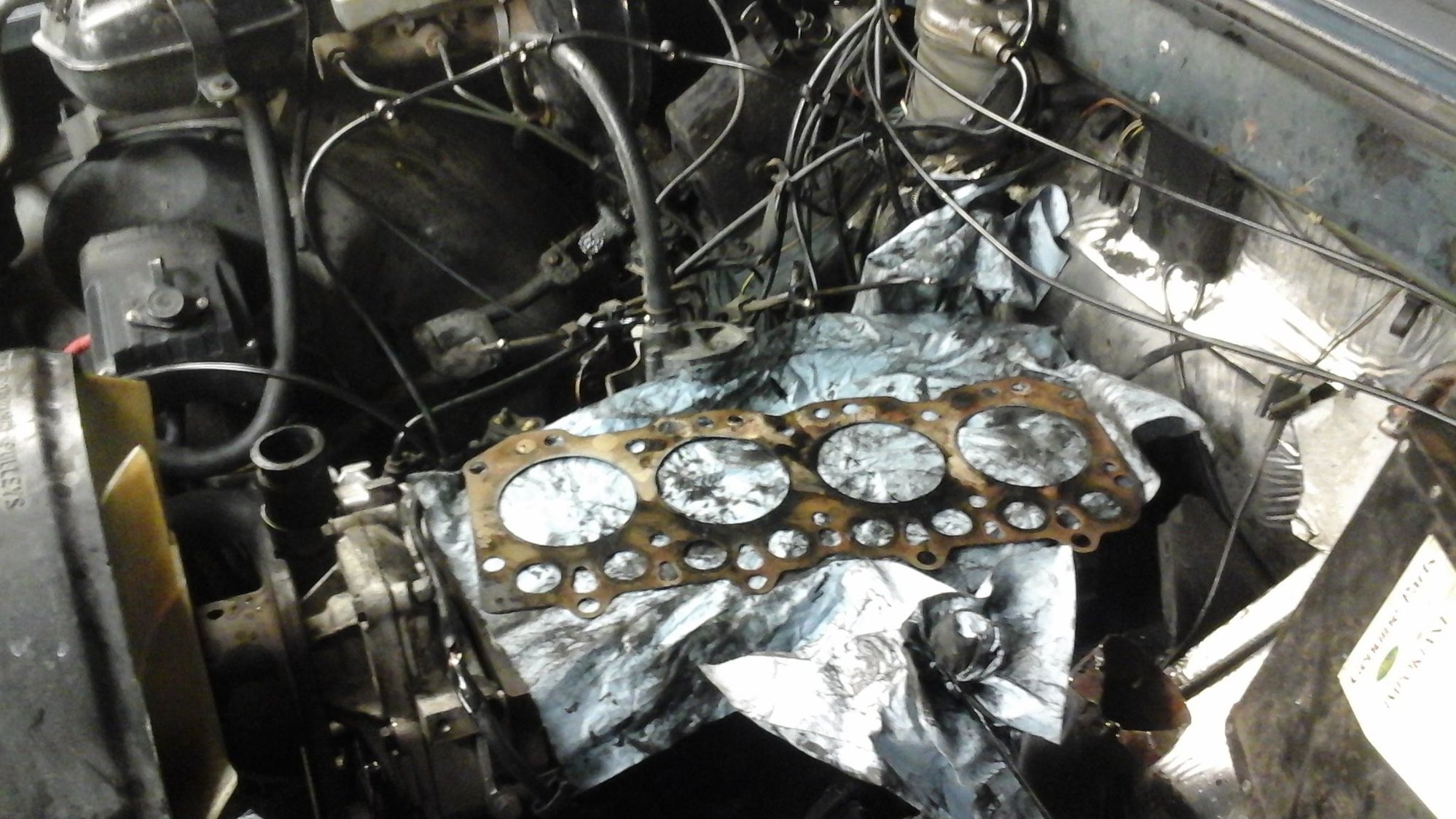

Todays project...

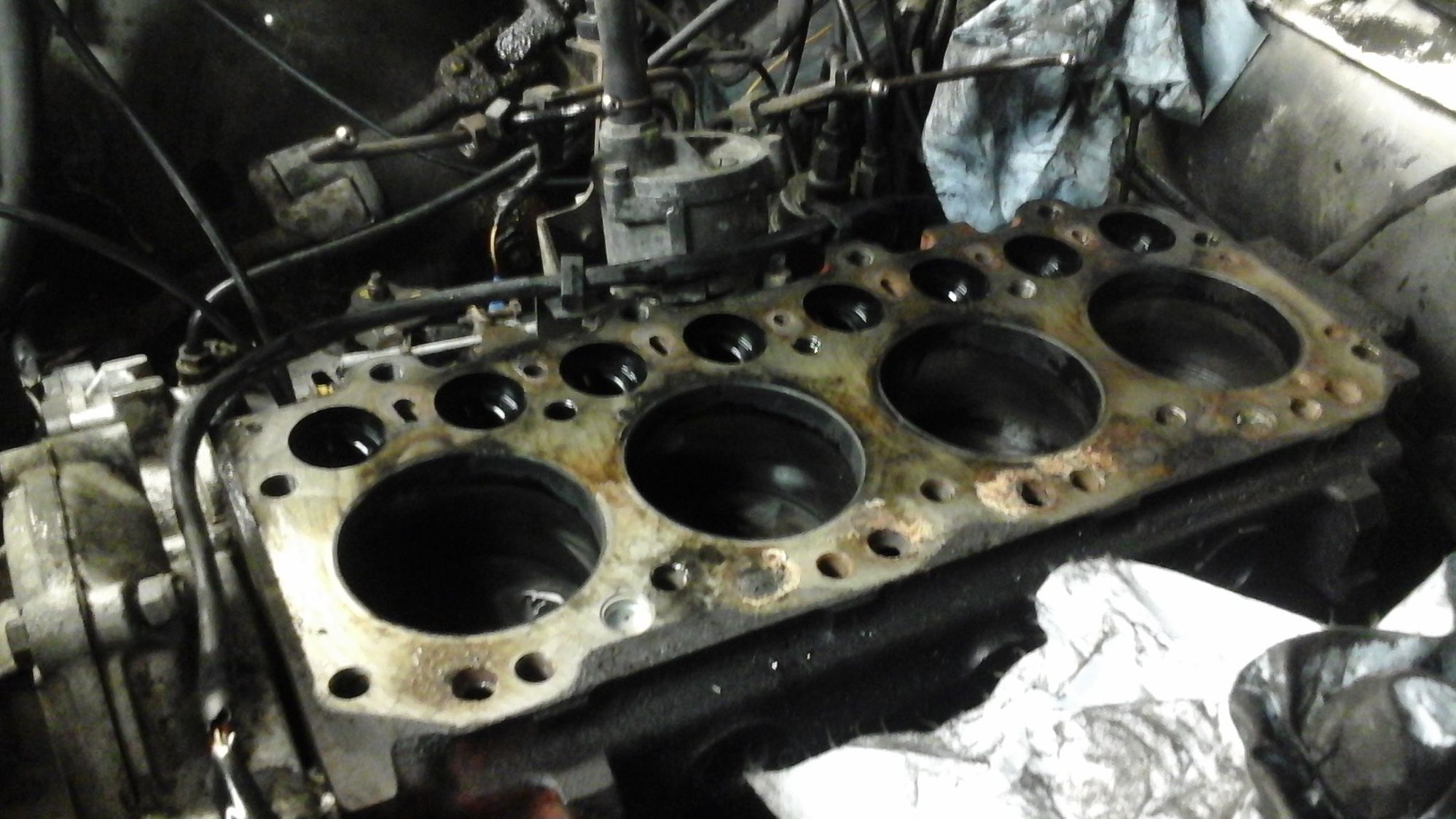

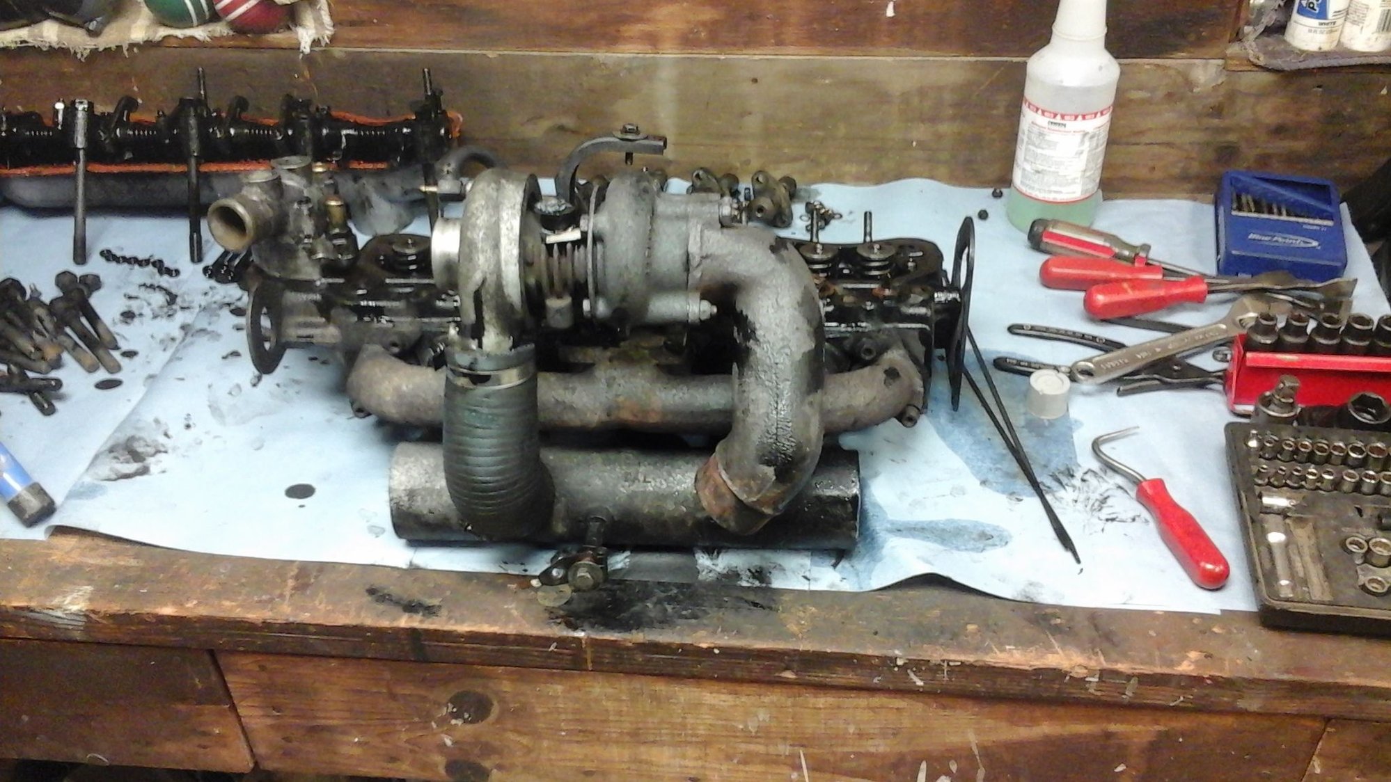

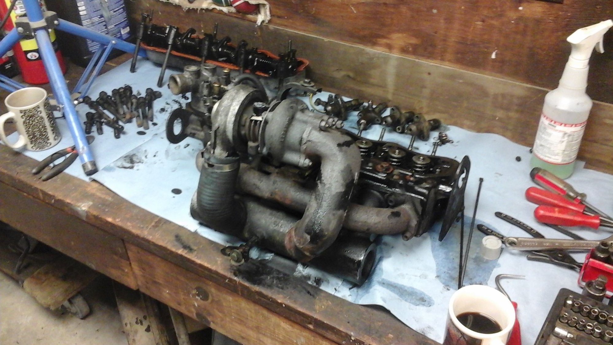

Removed head, for gasket replacement and other odds and ends. Have replacement fuel nozzles, new turbo down pipe, fuel pump and some o-rings for injector pump lower housing/fitting.
Removed entire assembly, head/turbo/intake manifold...not going back in like this...it was freak'n heavy.
Came a part pretty well. Npthing broke on engine side of things. Did snap both bolts on bracket that holds washer reservior. No biggy, l'll grind them off and weld new ones in place.
Had a little anti-freeze leak at rear of head and oil in front corner.
The head gasket looks original to me and didn't really have any signs of being a part before.
Garage full of downed rovers...lol. If this virus thing continues much longer...maybe l'll get after the white one.
Brian.
