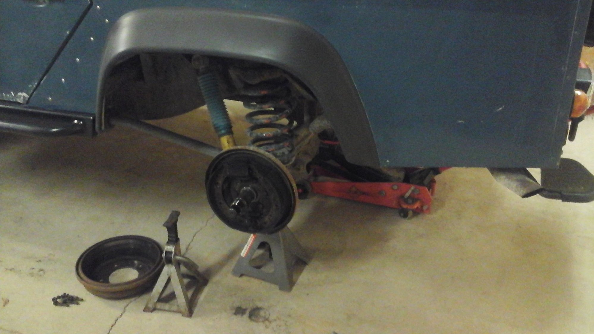

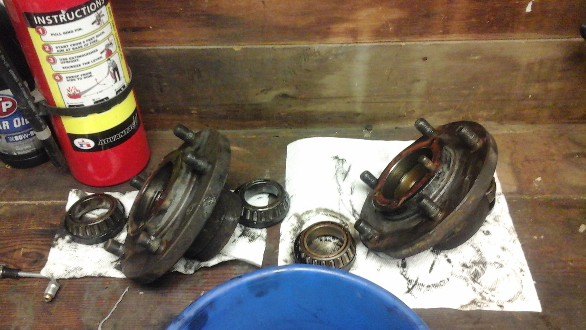

Just some maintenance today. Checked rear wheel bearings, only one was sketchy...but l'll replace them all...along with seals and gaskets. Have a pinion seal coming, too.
Old girl will be down for a while, going to start getting serious about the build.
Brake shoes were replaced last fall, still looking good.
One broken bolt on drivers side hub, other than that...she came apart smoothly.
Brian.

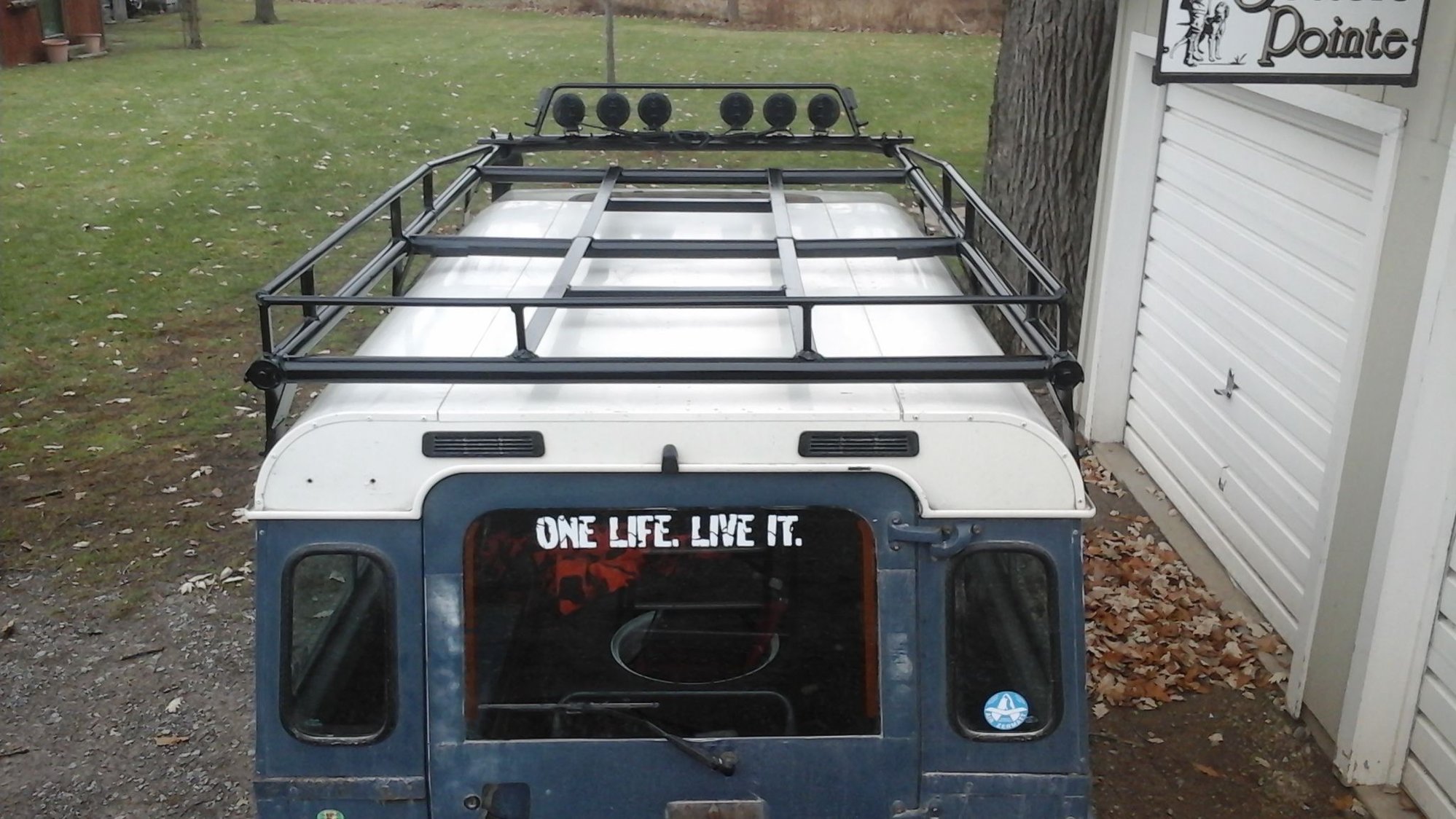

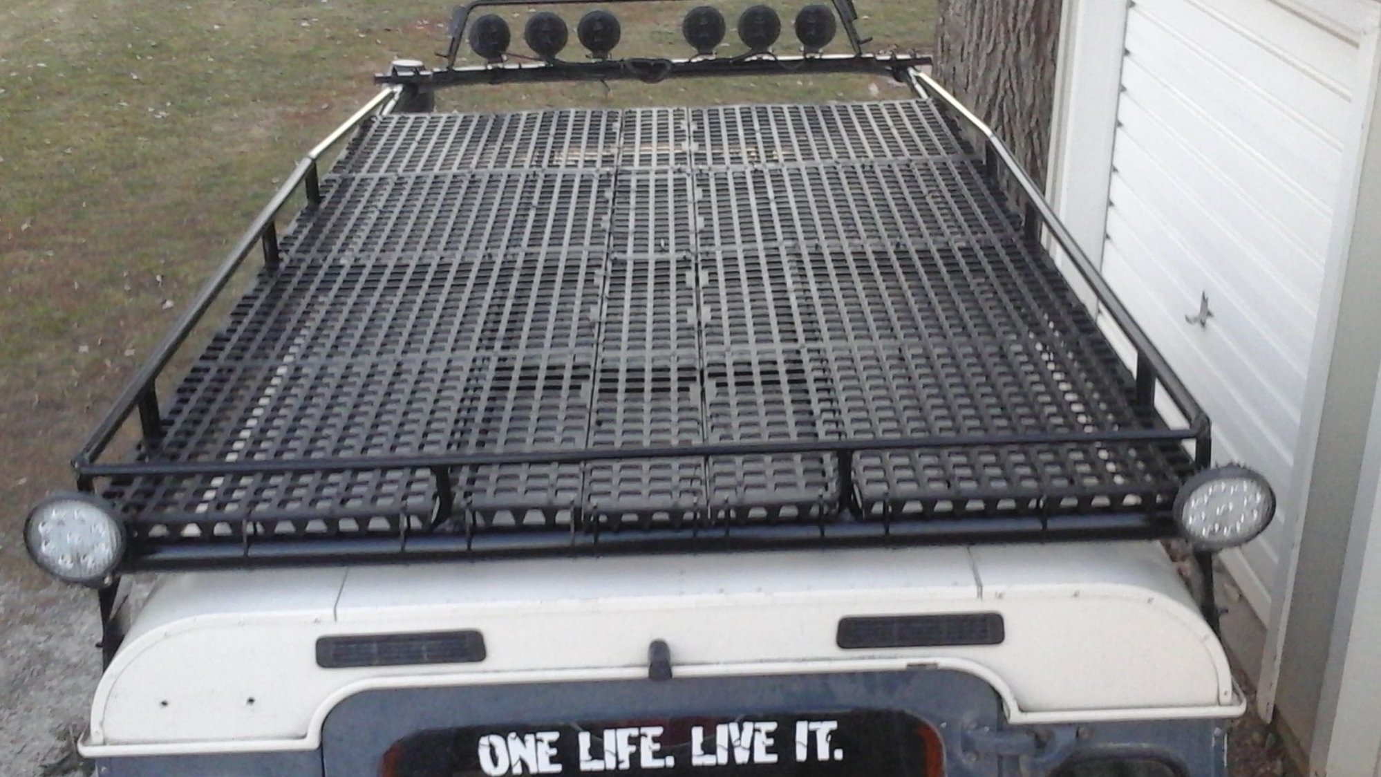

As you know, built the roof rack.

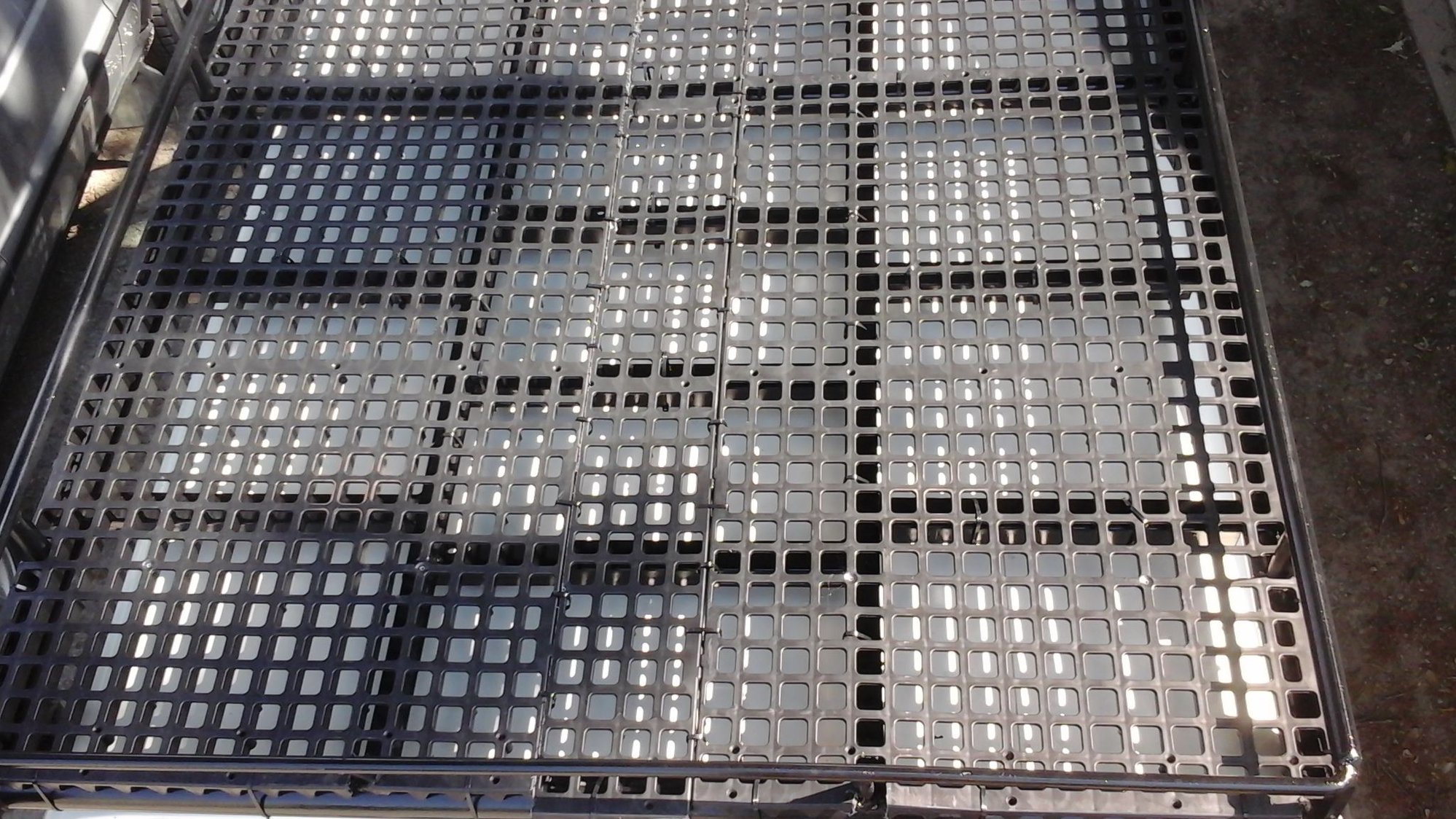

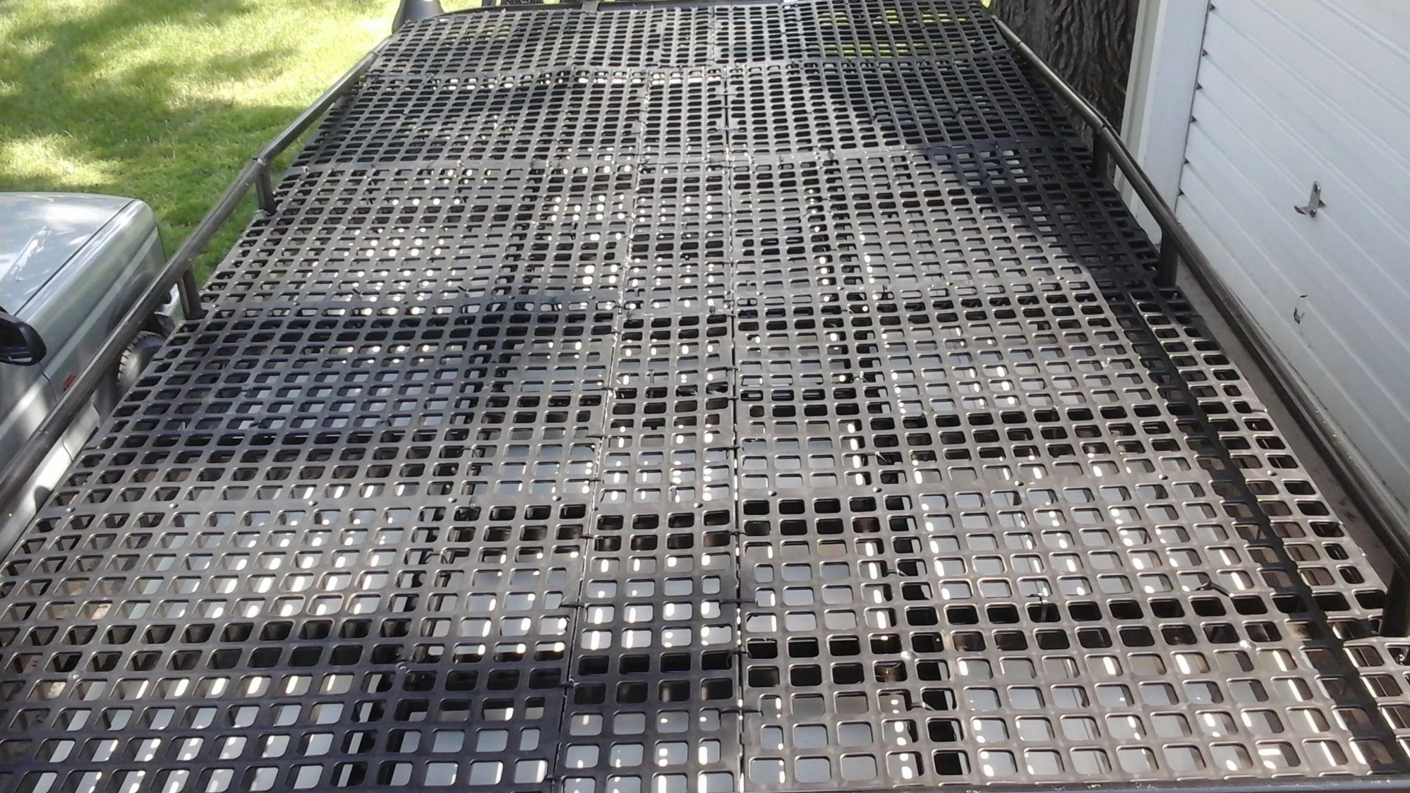

Then added plastic grate flooring and light bar up top.

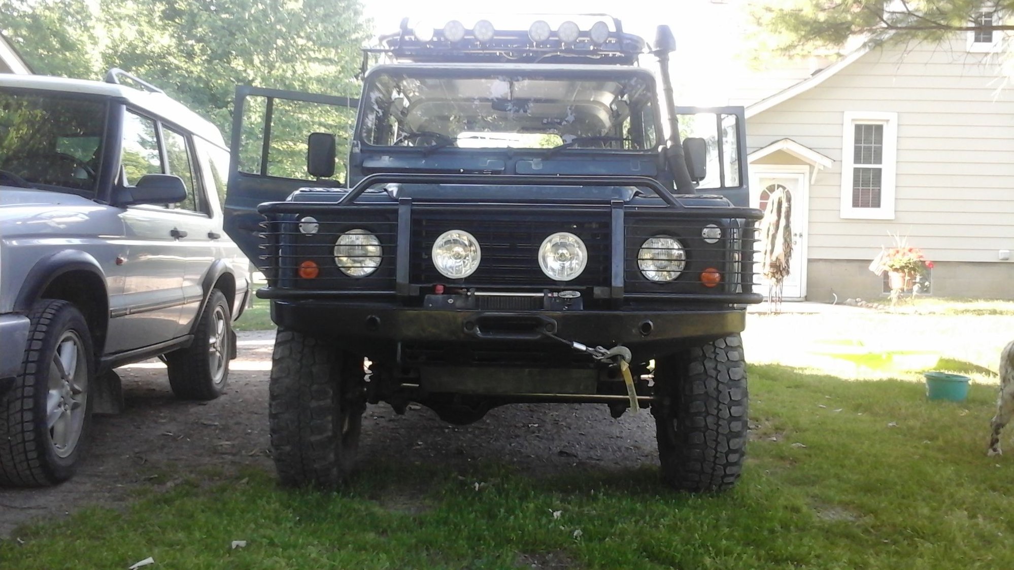

Light bar from front. Never was a hundred percent happy with this look, lights looked too small and was higher than acceptable to my eye.
As l was originally making the rack and adding supports...my "brain" said add more...but my "just want this done side" said...it will be fine. Well, we all know how these things end. Ended up having to watch where l stepped or knelt...so...it was a complete fail.
So, off came the rack, off came the light bar and off came the flooring.
Added several more supports and even extended the plastic flooring a bit farther forward than before. Which will help support roof top tent. Walked all over and it's solid now.

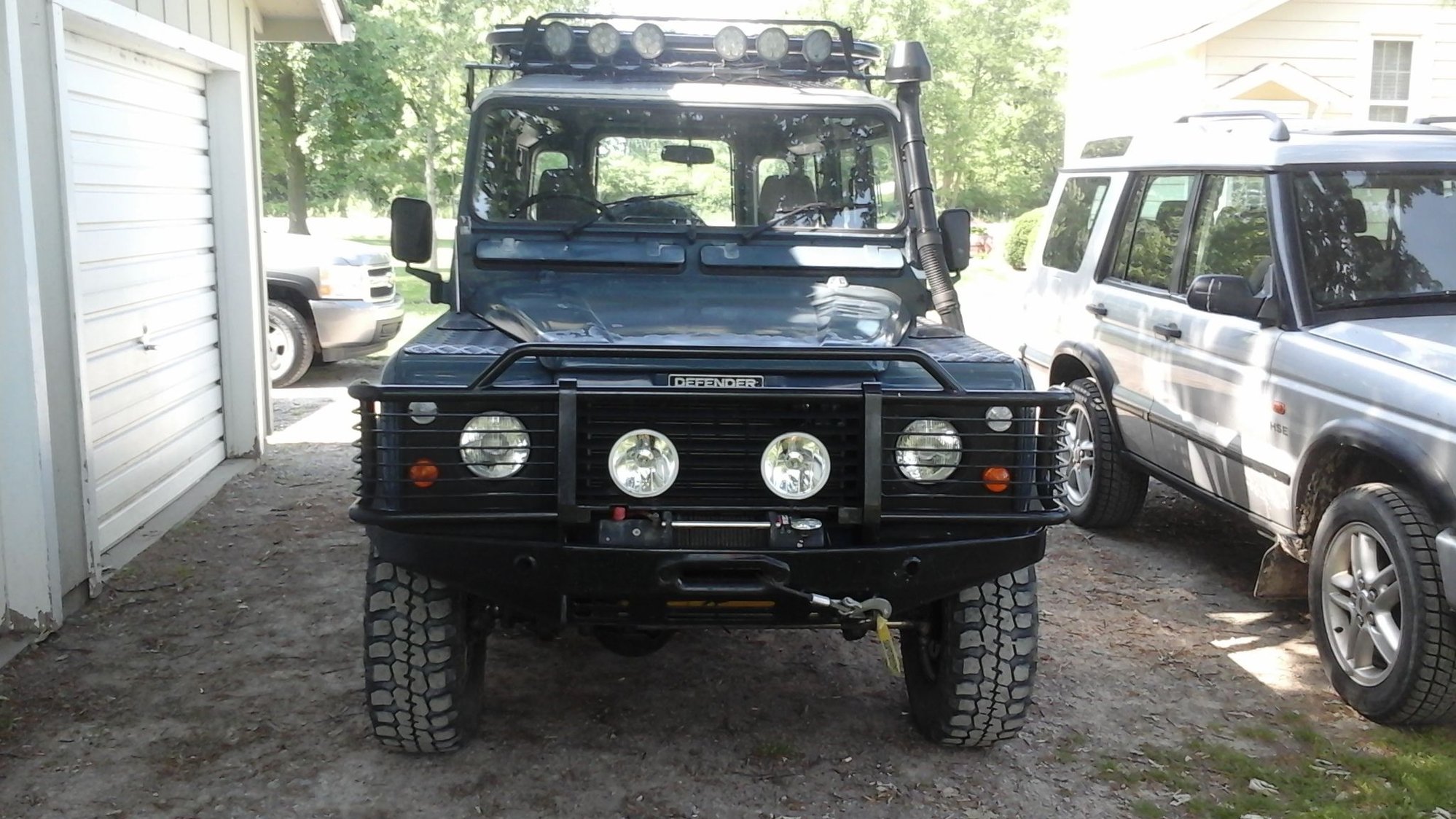

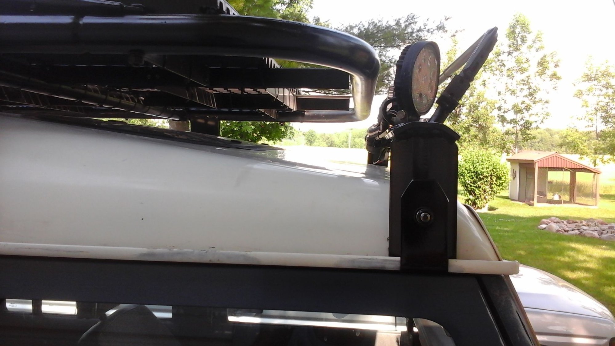

Since l've decide on a roof top tent, light bar was now not an option. So, l tucked it in just in front of the rack and making the top guard bar even with rack flooring.
Believe she looks much better with it tucked in above windshield, and now the small (4") lights look appropriate (in my opinion).
l believe a fork can be stuck in this part of the project...now. Yeah, modification will happen as we go, but the flooring is on to stay.

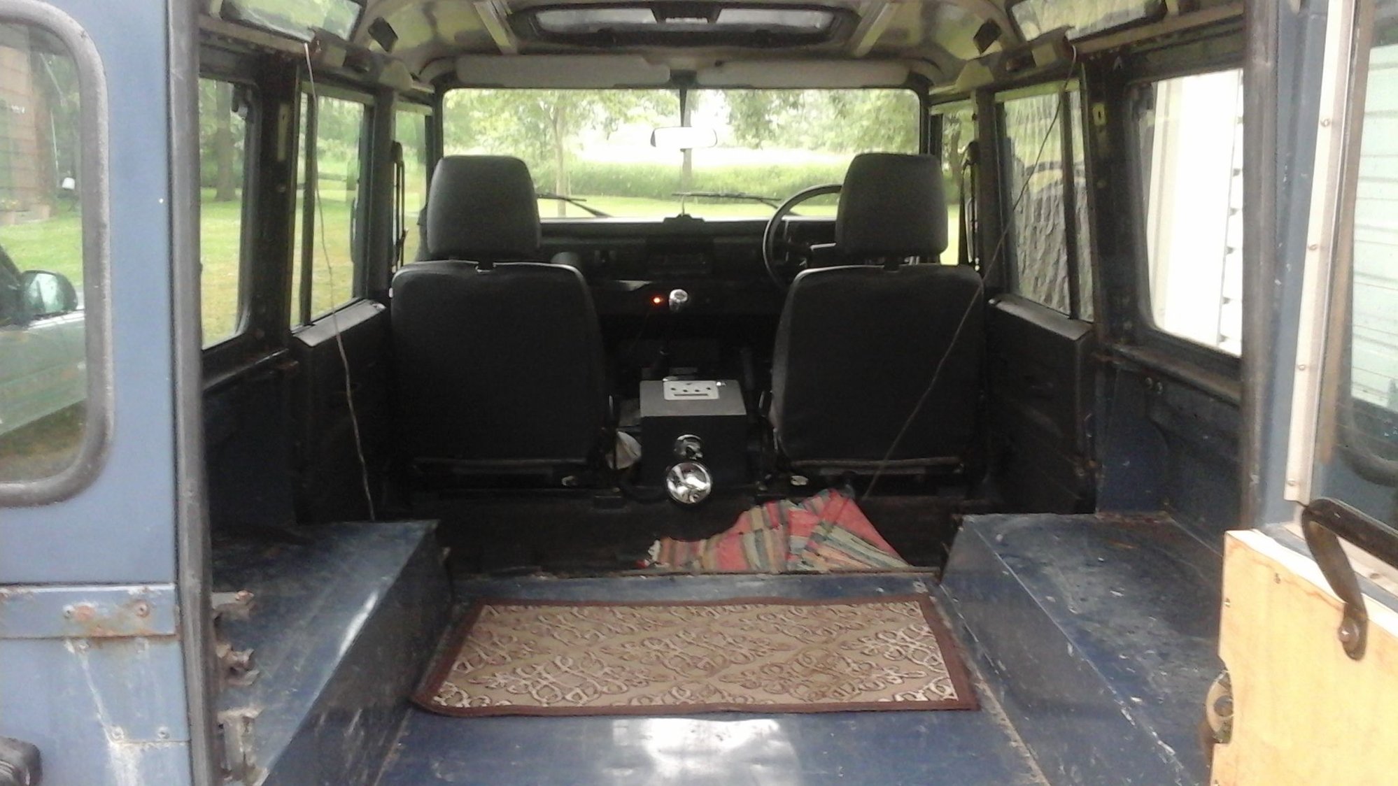

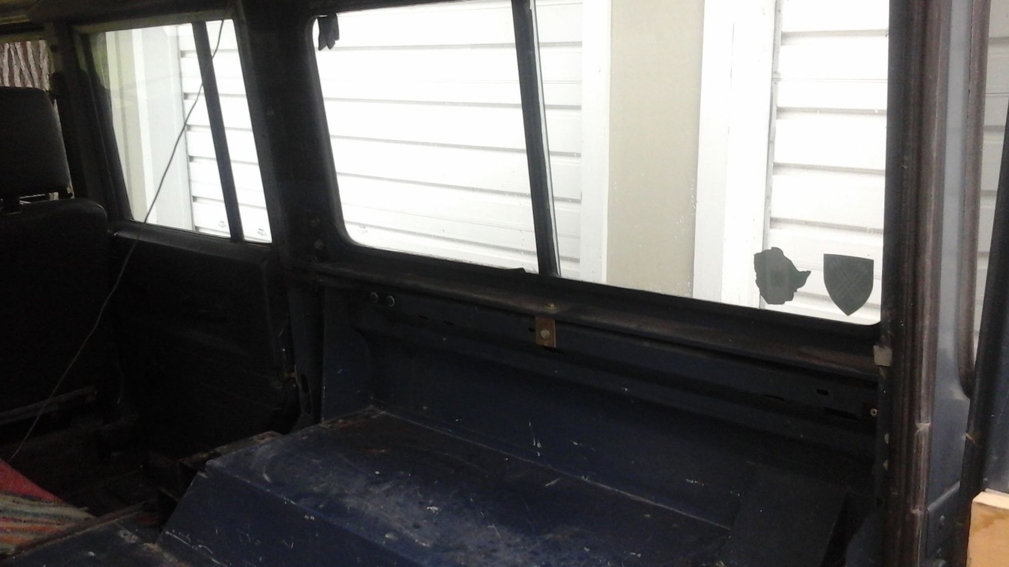

Removed rear interior trim pieces around windows and seat belts. Needed to be done to find materials for securing cabinets and sleeping compartment.
Hope to purchase insulation material soon.

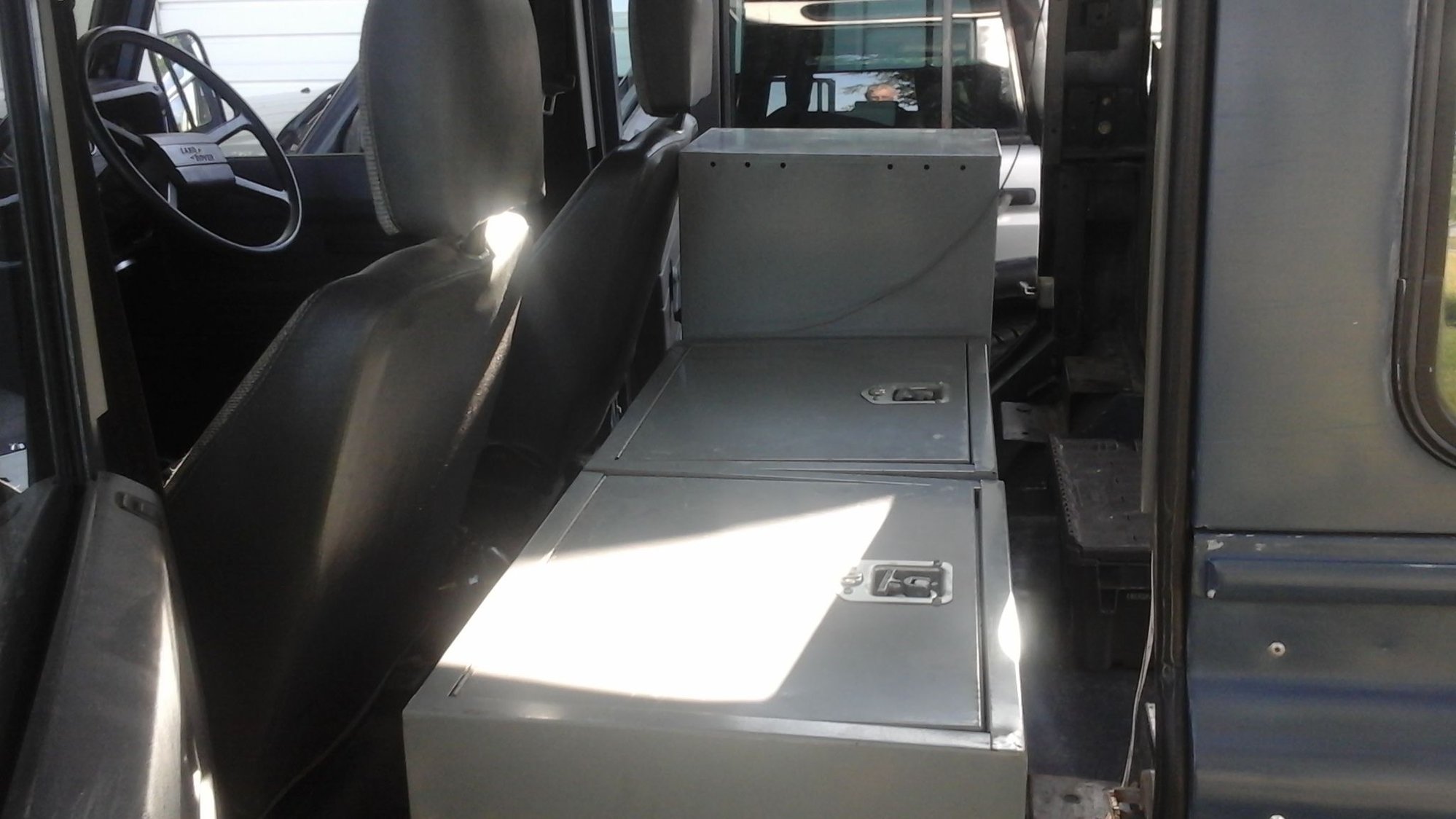

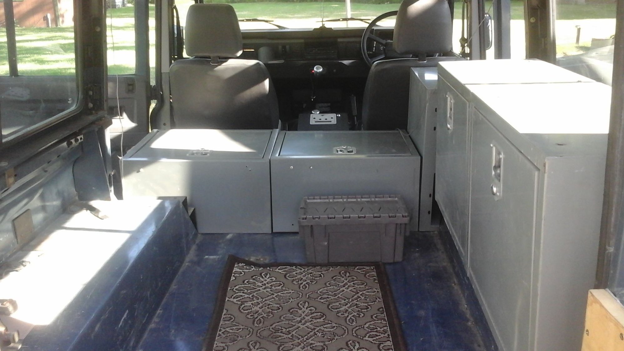

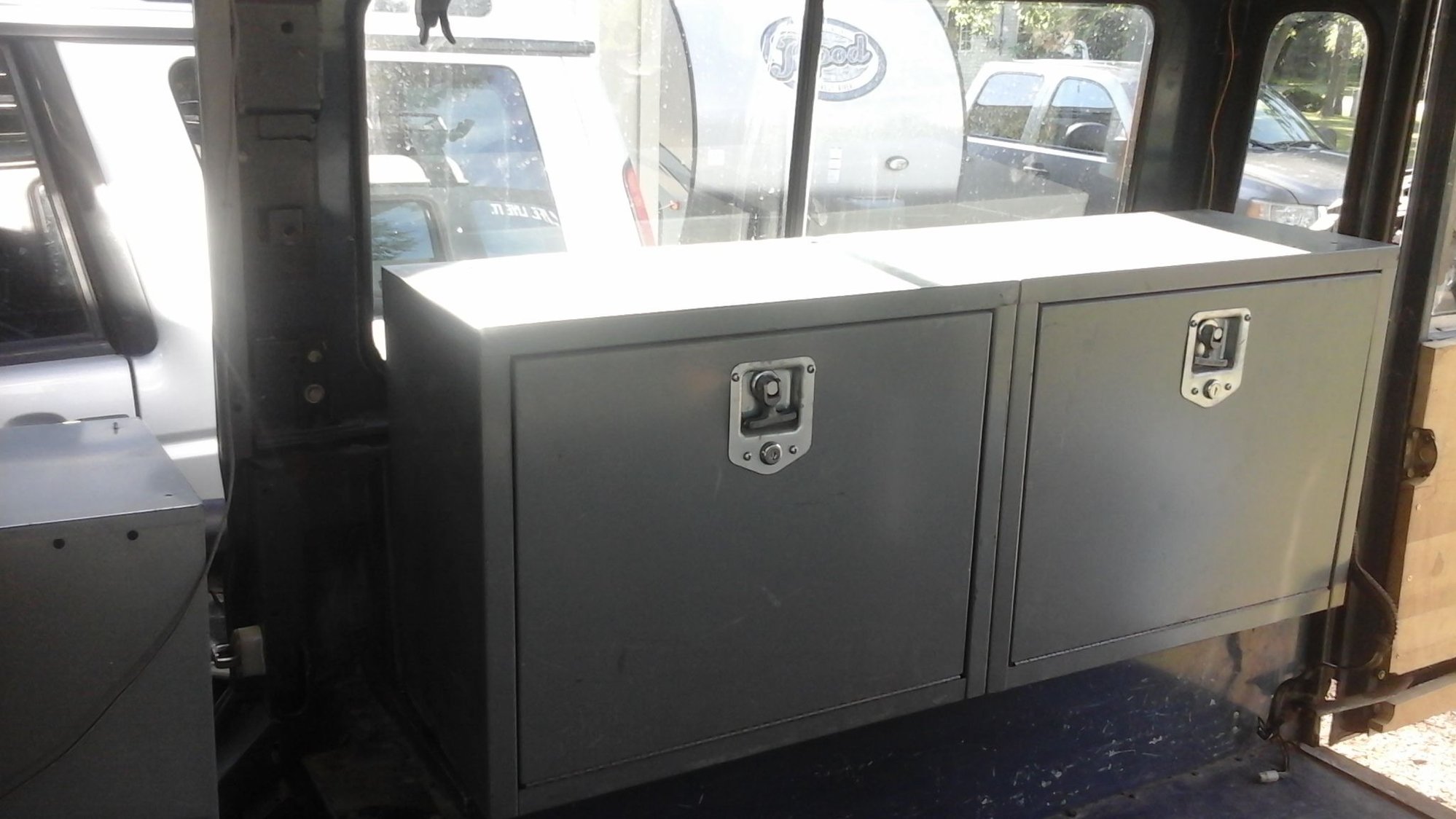

I'd had these cabinets, removed from an old maintenance van we auctioned off years ago. Didn't really plan on using them, but got messing around with them yesterday...and l'm not hating them for a primary cabinet structure. I'll probably put wood veneer over them eventually, maybe not...time will tell. Bought three 4'X8'X1/2" sheets of cabinetry plywood the other day, for sleeping platform and overhead cabinet, and will have extra for dressing these cabinets up some, maybe just cover the door section in wood, leave painted metal framework exposed?
These two fit in just right and are about right height for putting a counter top on, for cooking indoors.
Laid two on the floor, partially over rear footwell area. I'll have to make a support for front edge, but l like the thought of them offering me a spot to slide my high lift jack underneath. (I've already removed third box standing on end by right rear door, after picture was taken. Decided against it, since this will be my canopy side and there may be times l want to crawl in the back...without going through the rear door...plus...it's nice to have a couple options.
I've centered them since this picture. They are about three inches higher than the well-wheel housing, so l'll need to build sleeping platform to match height. Still leaves plenty of headroom, plus while sitting on the well-wheel...it almost felt as though l was squating. The sleeping platform/sitting area will be on the left side, with a isle way for my feet on right.
