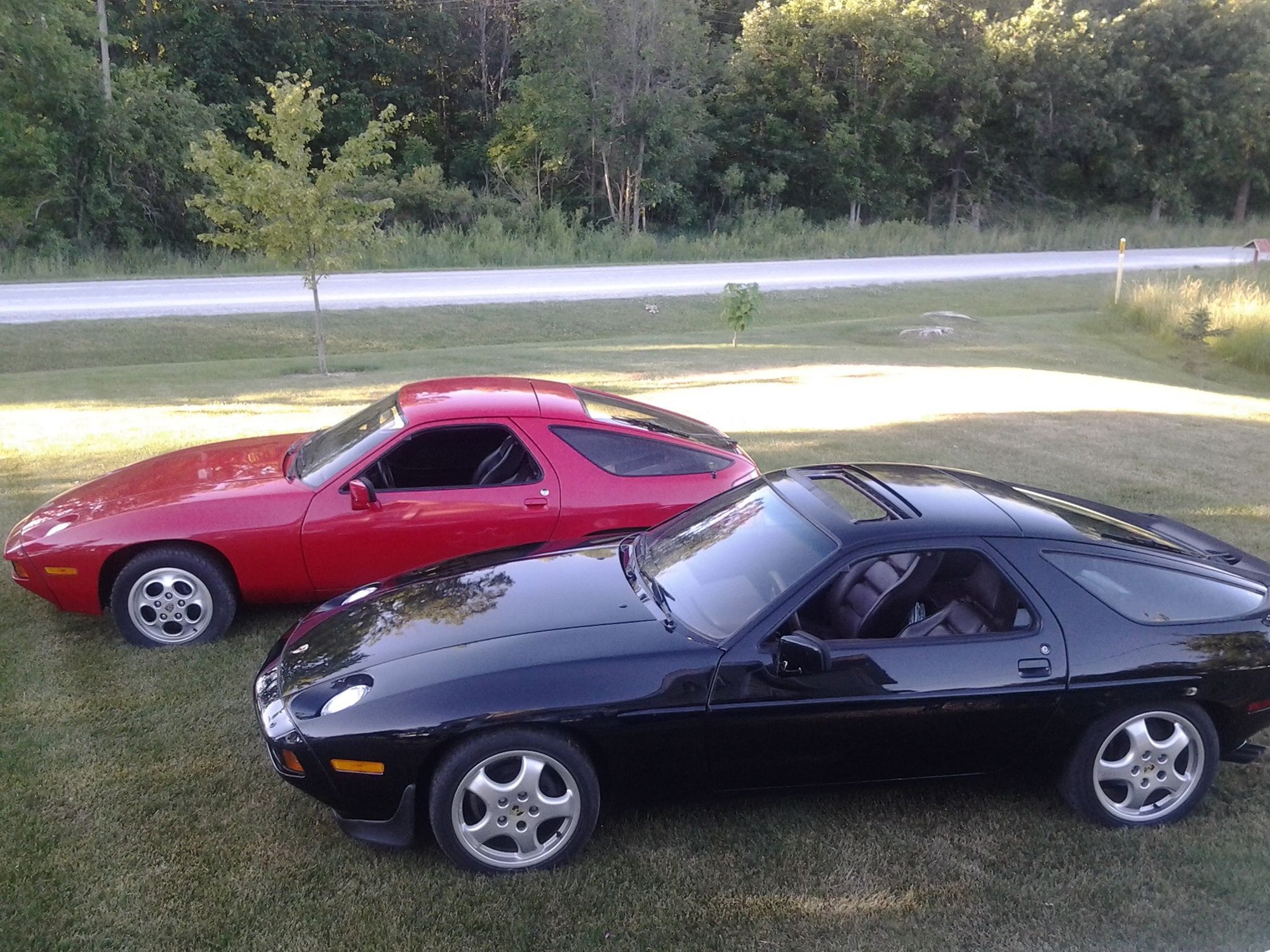

  #39
​​​​​​​Still looks like it's worth way to much more than my 110

I can take a ball peen hammer to it...if that would help...lol.
She's pretty nice, but not immaculate by no means. Paint is about a 7 out of 10 (color is all there, just starting to crackle from age and a few bumps and bruises), interior about the same. She's low mileage though, 78K. It drives great, and when l drove it to the storage facility last fall...l thought...man l love this car. Mentioned selling it to my wife, she said, well it's up to you, but we could then use the money for a travel trailer. Then we end up buying a trailer last month...so...hmmm...do l really want to get rid of it...lol. 110's have always interested my brain though.
