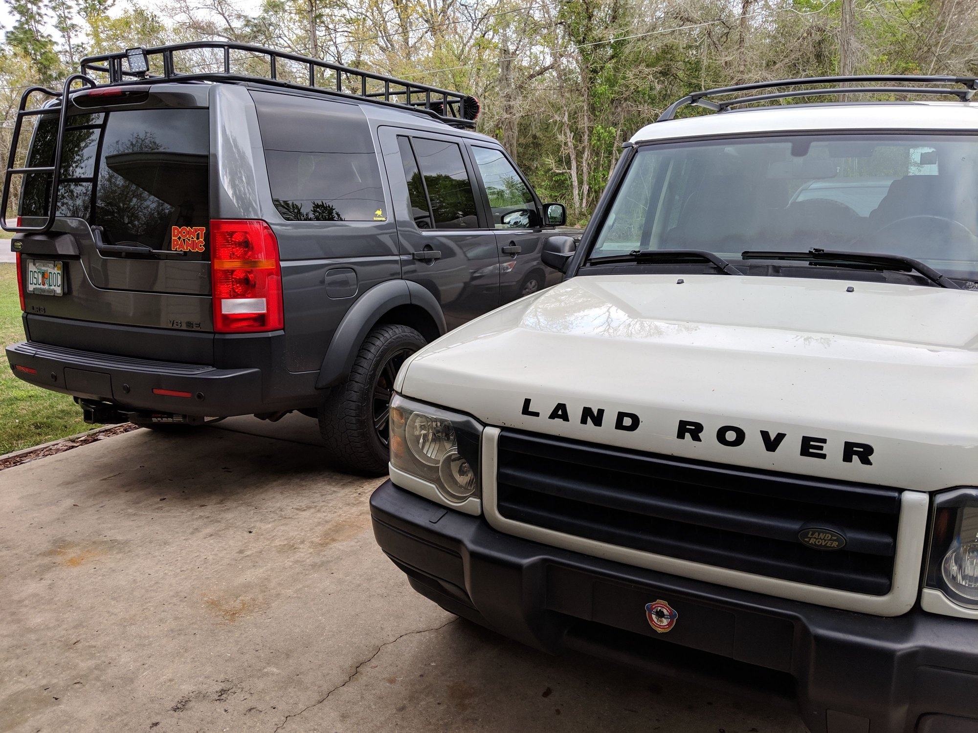

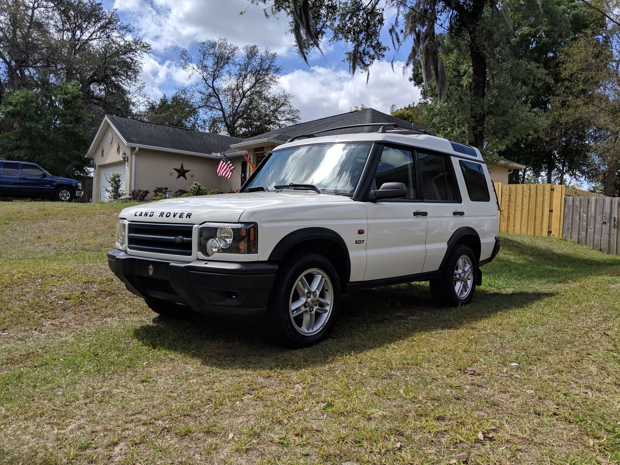

I'm always on the look out for cheap Discos as parts cars, and one day I came across a $500 2002. The guy was very down on the car- over heating problems, bad exhaust, etc. When I got there, I didn't even look it over. It was 500 bucks, clean title, and I drove it onto my trailer. When I got home, I washed it and that's when I realized that it had been completely repainted at some point. It was then I decided to keep it. I fixed the overheating problem in an afternoon with parts I already had, paid $120 to fix the exhaust, sold the tan seats for $300 and swapped in a black interior I had from a parts car- so all in, this is a $320 Disco!
It has some rust on the frame, but it's not horrible. I figured I'd keep it as an extra car till the diesel frame is ready and then I'll swap the body onto the good frame.
I got bored one day and swapped the headlights to 03/04. I had the parts laying around, so no cost here.
Upgraded from the 16" wheels to 18" Hurricanes (also free)
