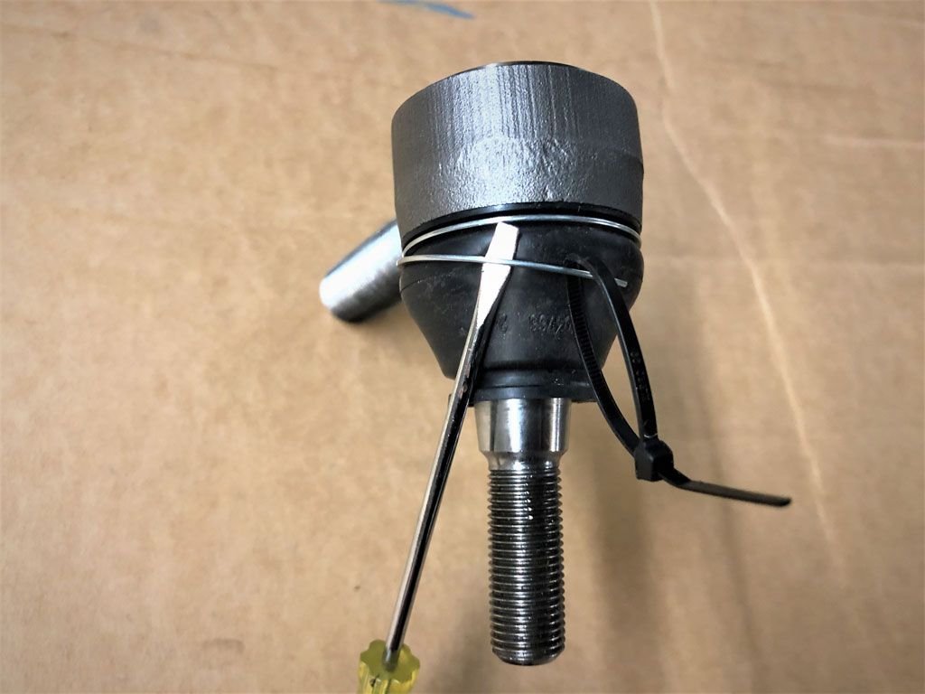

I finally replaced the four worn tie rod boots on the Terrafirma drag link and track rod with the polyurethane boots from Gwyn Lewis UK. Hopefully they will last longer than 6 months like the Terrafirma boots did.

How hard is it to replace the boots ? And do you have a link to the SAI tubing mod ?

Changing the boots made it easier while using a screwdriver and zip tie as shown on the Gwyn Lewis website with pictures and descriptions.... https://gwynlewis4x4.co.uk/product/p...s-four-gl1173/
