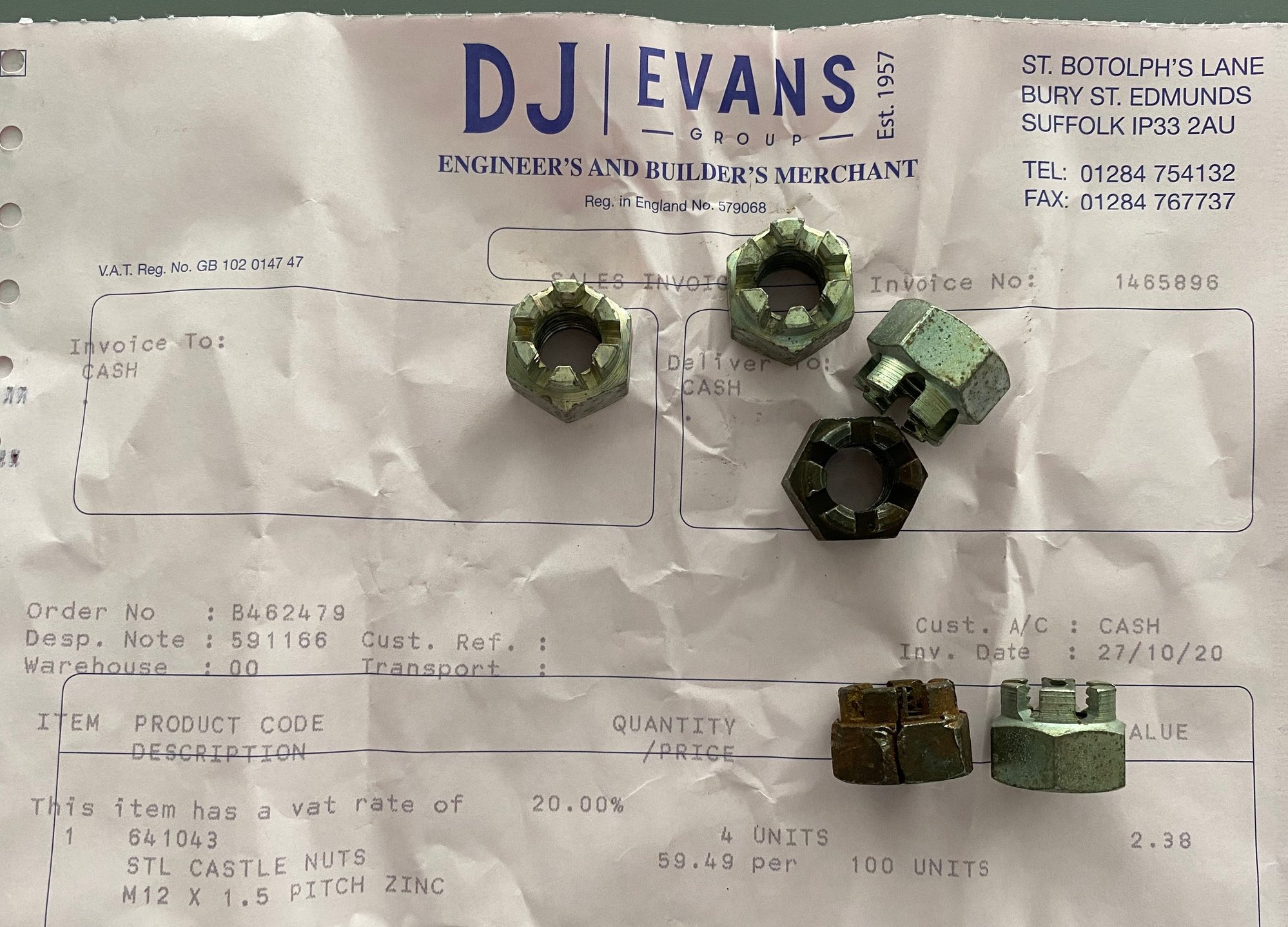

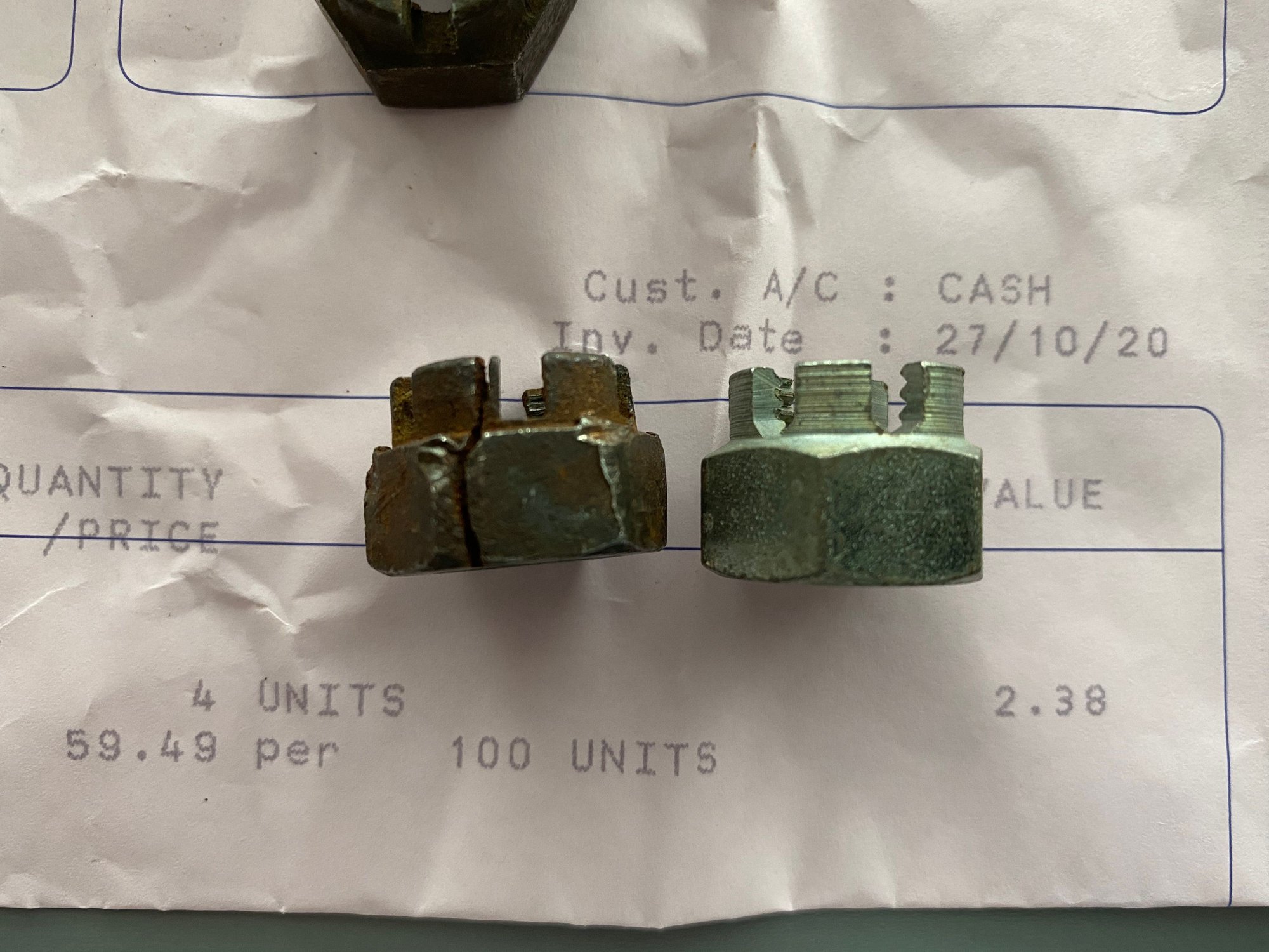

I bought new castle nuts for the Terrafirma track rod ends since one of them was cracked. The castle nut measurement is M12x1.5 pitch.
Looking on online they were averaging £5-£8 ($6-$10) a piece. I found them at my local DJ Evans hardware store for 59p ($0.76) a piece so I bought 4 of them.

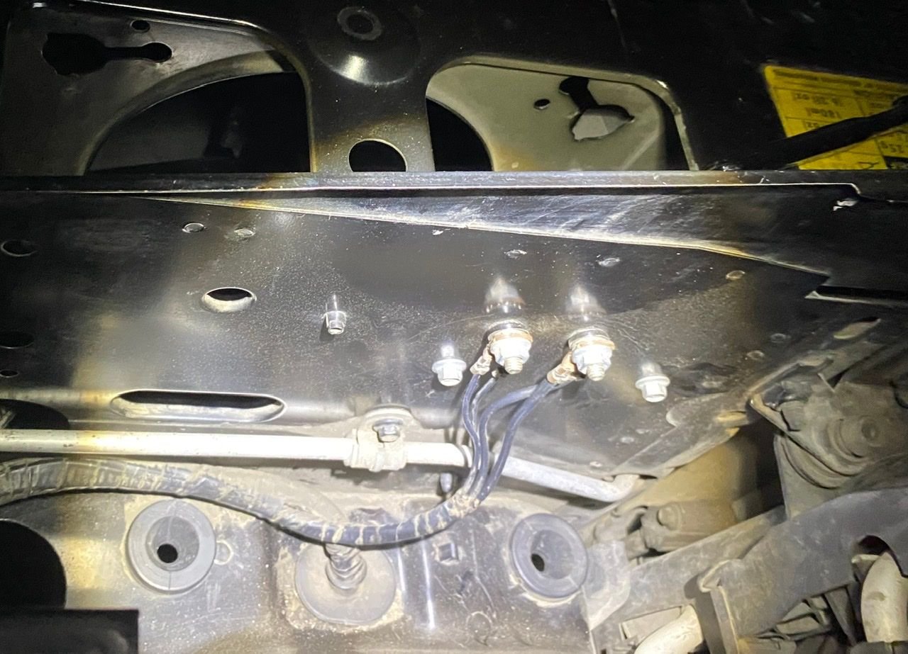

Two weeks ago I bought a remanufactured 150A alternator from eBay seller synergy auto parts for £90 + free shipping and I finally installed it today. https://www.ebay.co.uk/itm/114446489655
My original 120A alternator was dying a slow death. The bearing had a grinding noise like it had sand in it and the voltage output was about 12.9 VDC constant.
Now, the installed remanufactured 150A alternator is putting out 13.97 to 14.06VDC.
I added a 23”/58cm length of 0AWG grounding cable from the alternator housing to the negative side of my Battery negative disconnect switch as part of my Continuing ‘Big 7’ cable install.

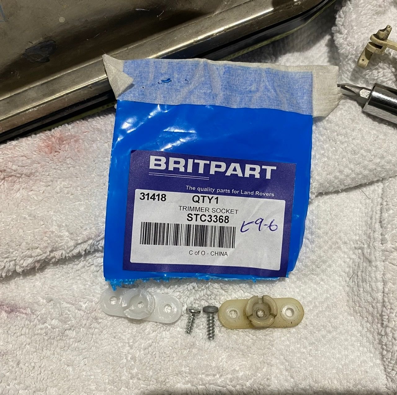

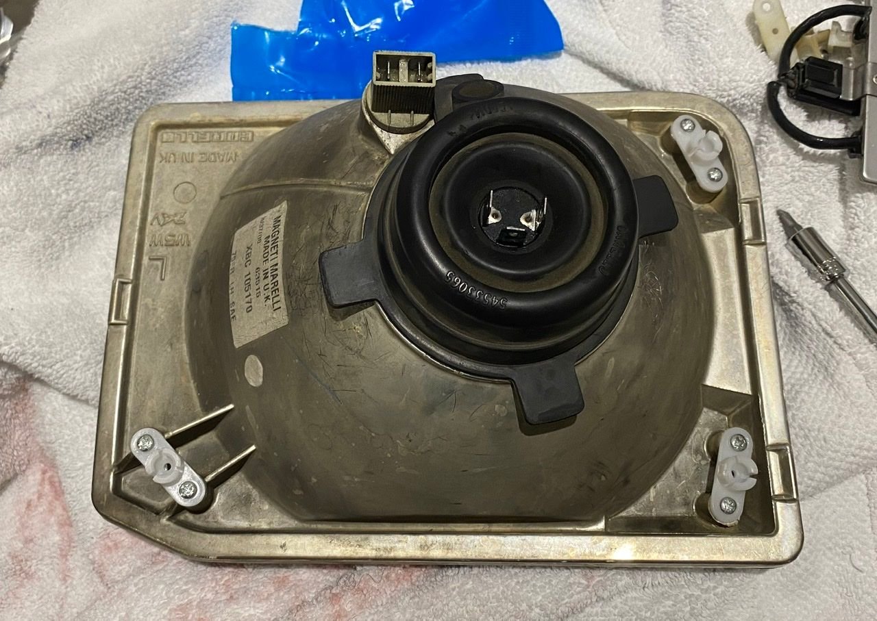

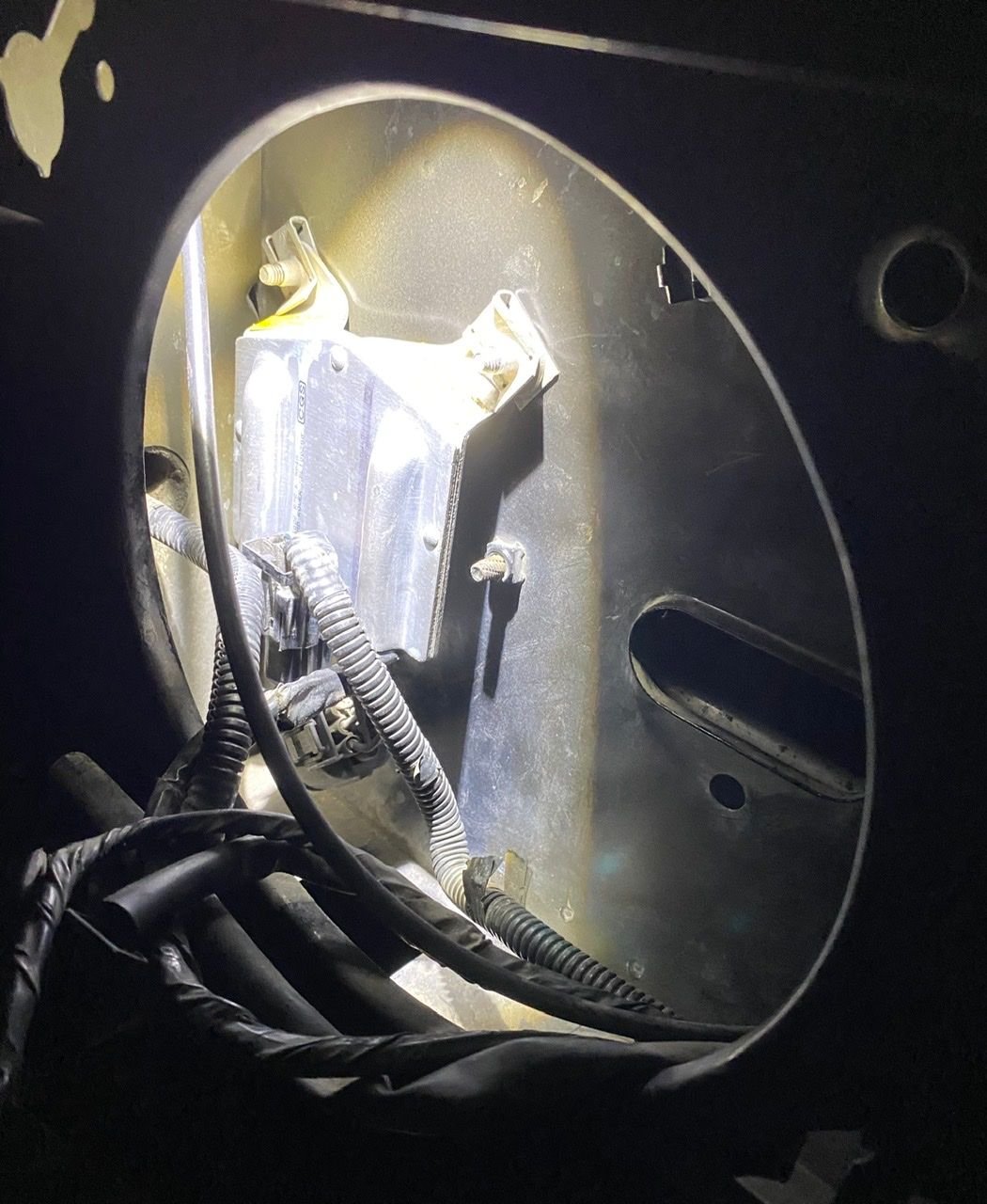

I installed my DRL resistor ($18) and all 6 headlight clips ($15) that I bought on eBay.
The DRL resistor was easy to install by following the technical info PDF attachment. Thankfully the seller included the 2 mount clips and both bolts to install it in the LH side headlight area. I removed the jumper wire from the 2-wire connector and inserted it into the DRL resistor, reprogrammed the BCU with the Nanocom to turn on the DRL when the engine is running.
Works as advertised! Now I have front DRL without the Illuminated rear brake lights.
Added the headlight clips. I used the new screws at first but decided to reuse the old screws since they were longer and tightened securely.

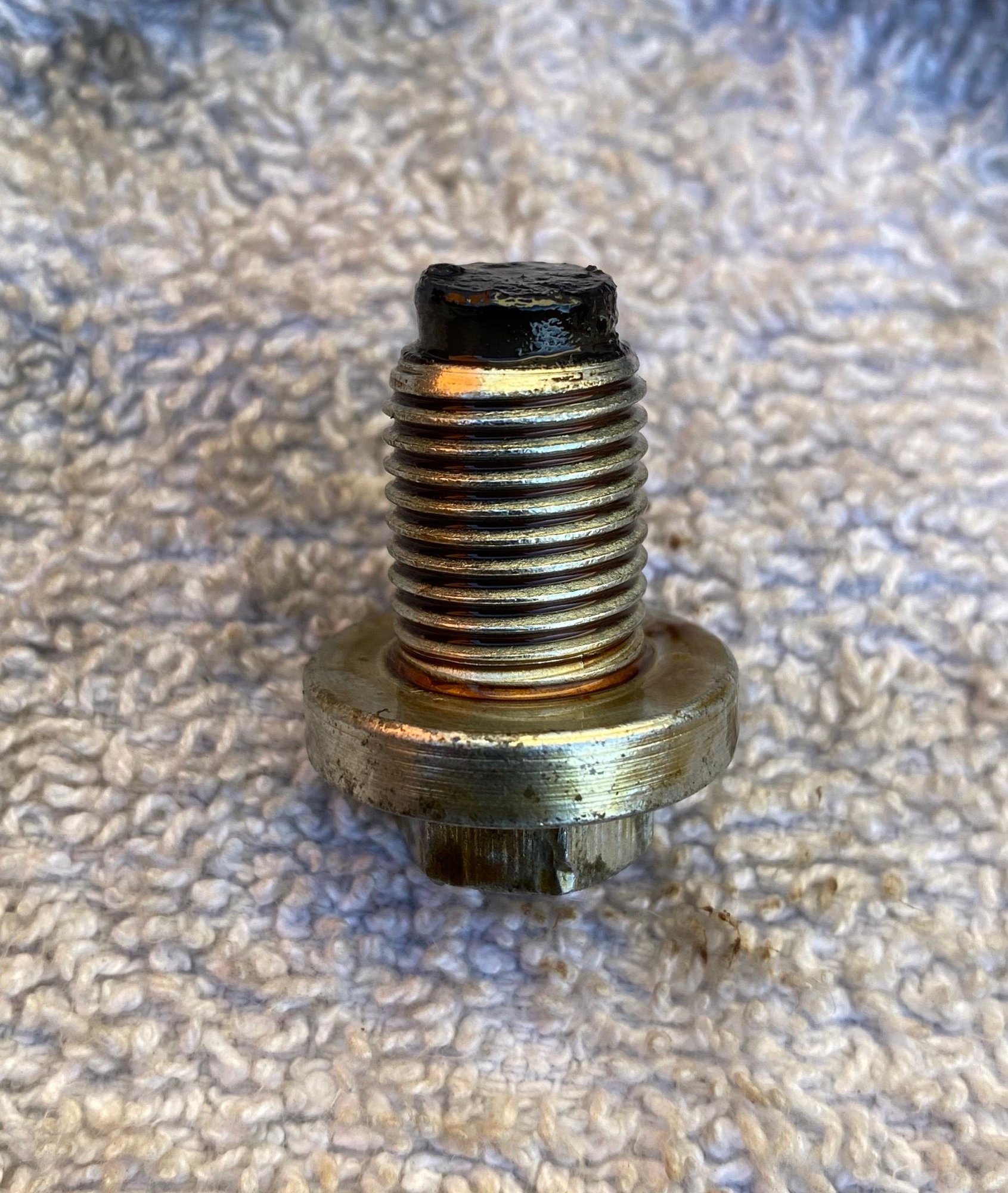

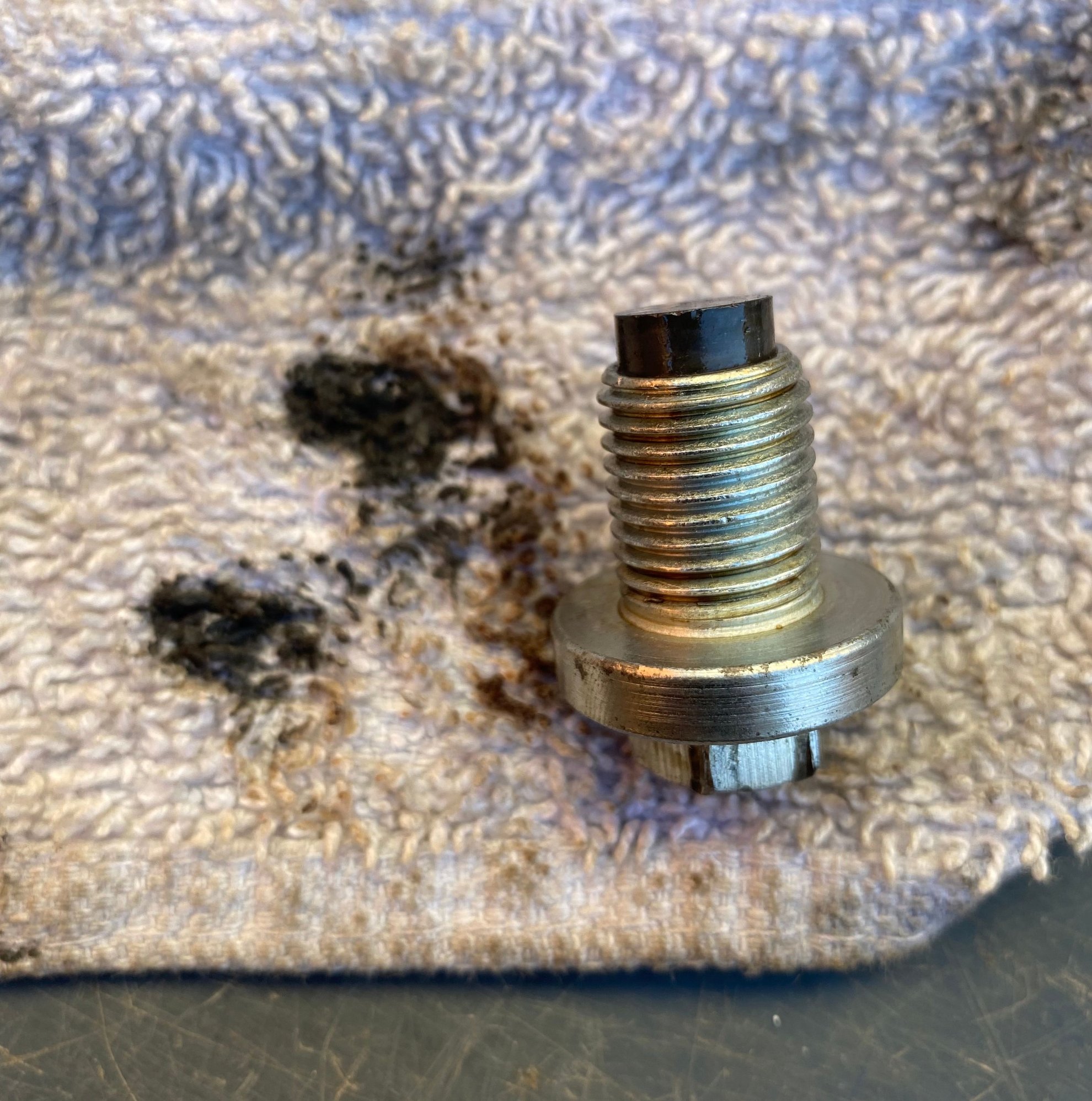

Yesterday during my semi-annual inspection/maintenance on Myrtle I finally washed her, sealed around the windscreen with Captain Tolley, started installing both outside A-pillar cowls, and started on extending the breather tubes.
I changed the oil at 4K miles (119243 miles) but I did it differently this time. I added a whole bottle of Liqui-Moly to the engine oil to loosen up any possible sludge inside the engine, ran at idle for 15 minutes, drained oil/replaced oil filter/replaced air filter, and filled with oil. I’ll run the engine for another 200 miles (119443) and do the same Liqui-Moly actions that I did previously to see how dirty the oil is.
After reviewing quite a few Liqui-Moly user YouTube videos and reading other forums I’m a member on (Land Rover, BMW, and VW), this was the proper 2 part steps to clean out a petrol engine’s internal parts. Could be snake oil but we’ll see.
While looking at the magnetic oil sump plug, it was dirty but no thick metal particles sticking to it.
Looked around the engine bay to see any loose or missing hardware, any corrosion, any rubbing or burnt wires and any fluid leaks. Looked good!
Crawled underneath and wiped down the underside, greased all the tie rod ends and both drive shafts, shook the drive shafts (no play!), and used a crow bar on the steering arms, drag link and watts linkage (also no play!).

Old Dec 20, 2020 | 07:54 AM
  #126
Fastercat's Avatar
Joined: Nov 2017
Posts: 788
Likes: 295
From: Amherstburg Ontario
That magnet looks pretty clean. Glad all is good

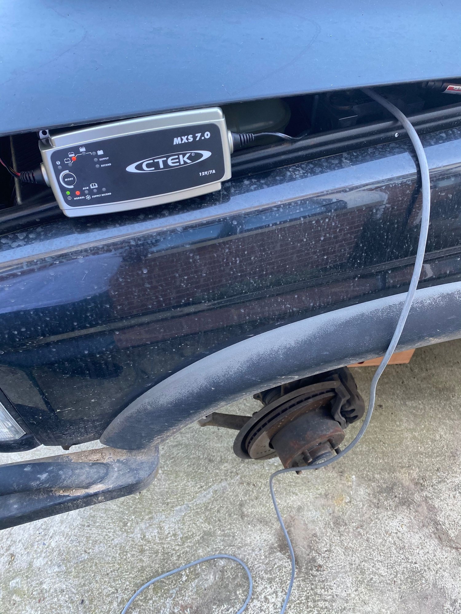

I finally drove Myrtle after a month of having her sit during our Tier 4 lockdown. I kept a CTEK trickle charge conditioner on the battery so she started up just fine and drove fine.
It's been a cold & wet winter so I have a pile of parts ready to install. I don't have a garage so I'll continue to tackle these tasks once it semi-warms up...

Charged the battery after a month of sitting during the UK COVID lockdown. Now waiting on the LF tyre to be mounted and balanced.
