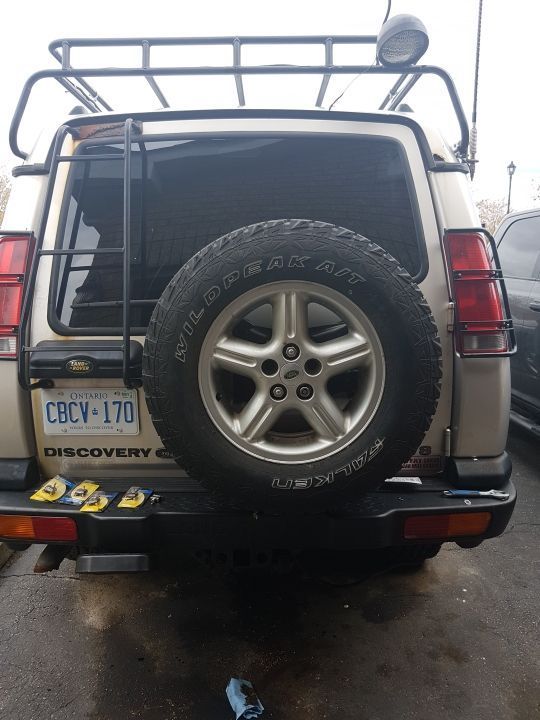

Picked up this truck on Monday. Needs a bit of work to make it road worthy but its strong start.
2000 Discovery SE7 in blenheim silver. fully loaded including SLS and ACE. Its getting up there in mileage so I'm fully expecting it needing a rebuild in new 2 years or so. (177k)
It's rough around the edges but it should start looking pretty good once the weather warms up.
What is done:
ARB Bumper
SD Rack
Mantec front skid
Columbia gas tank skid
3" front coils
2" rovertyme SLS airbag spacer
275/65R18 falken wildpeak A/T on stock rims (With matching spare)
Extended SS brake lines
What it needs to be road worthy:
Major service (For peace of mind)
Rear sway bar links
Watts linkage bushings
Ujoints in front shaft
Fix spare tire carrier
Door lock actuators in rear passenger doors
What I plan on doing after it passes inspection:
Install my CB
Remove the dumb looking square lights from the rack
Install my Hella 500s on the rack
Get a winch
Install CDL
Install a decent head unit
Looking like it will be a decent project. I'm excited.
