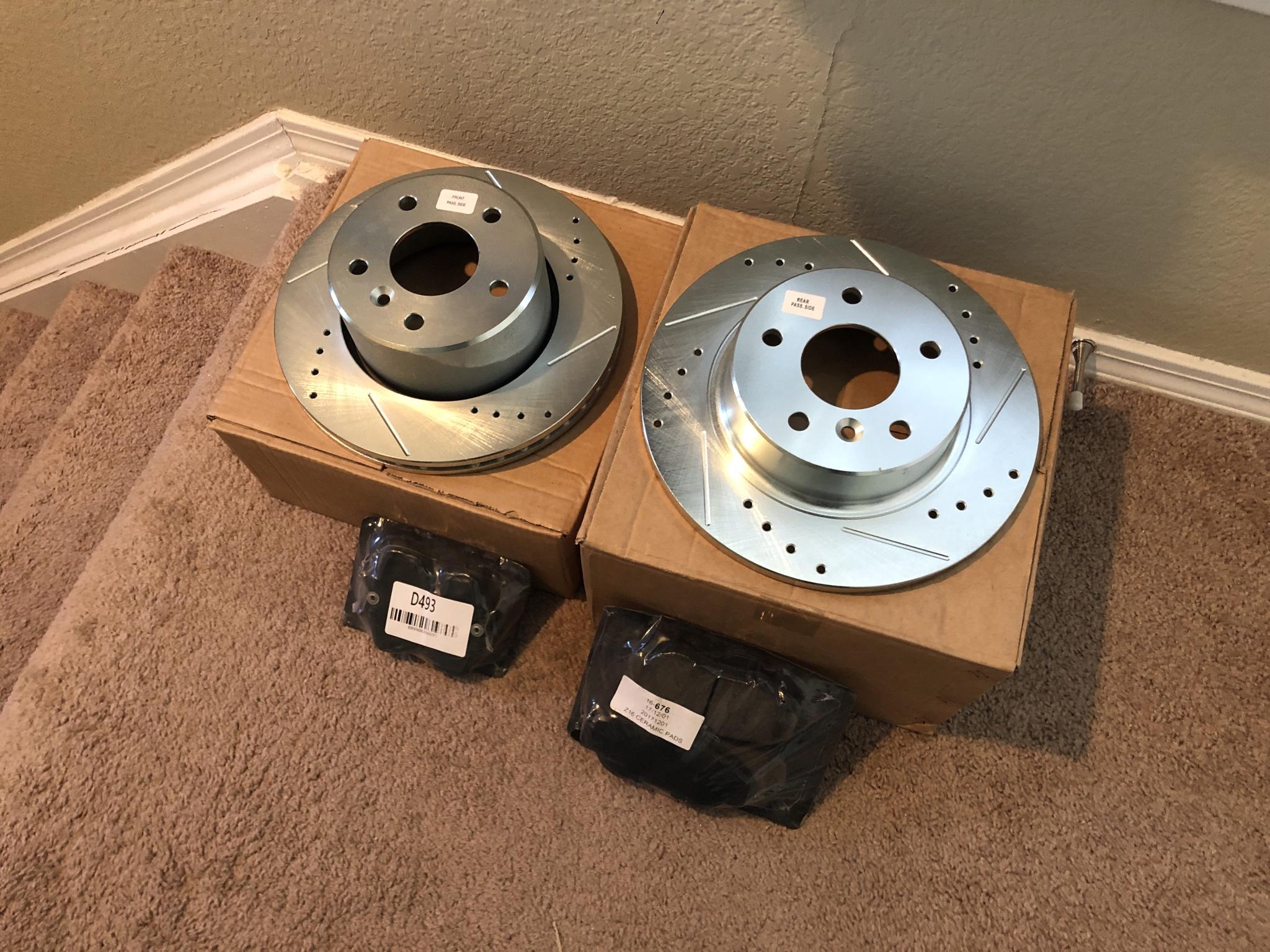

Got the kit from Brakemotive76 on evilbay for $150 shipped -- Looks like really good quality stuff

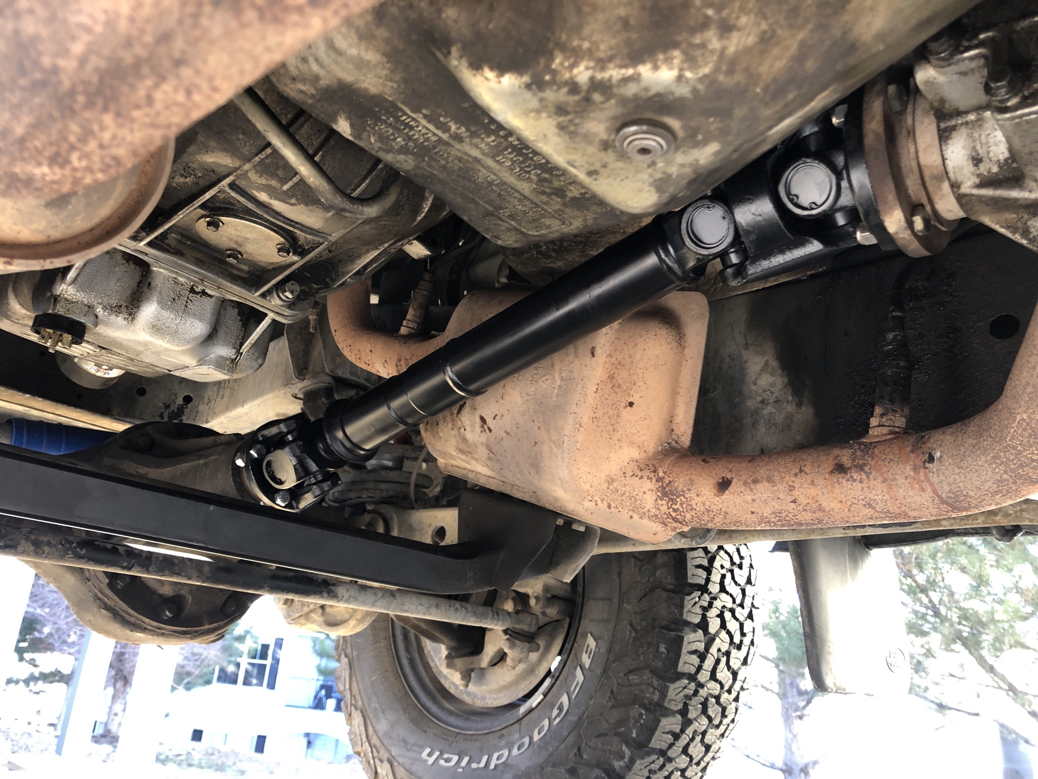

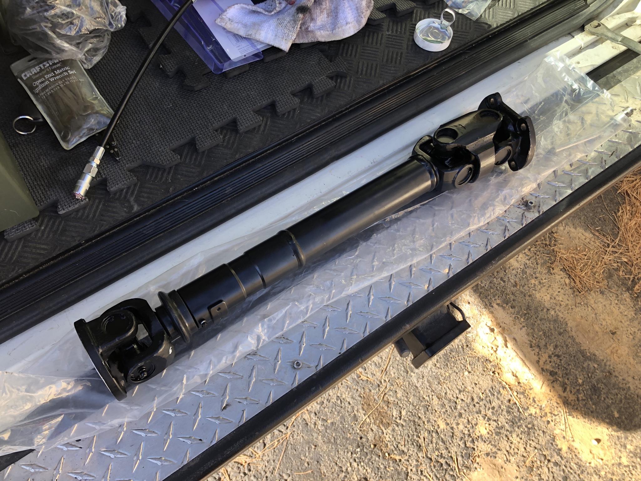

Finally got this in the mail - no longer a 2wd pandsie Disco! Reused the bolts on the tcase but got all new hardware for everything else. Fastnel didn't have the 24tp bolts so had to go with 16tp instead Repacked with fresh grease so good to go!

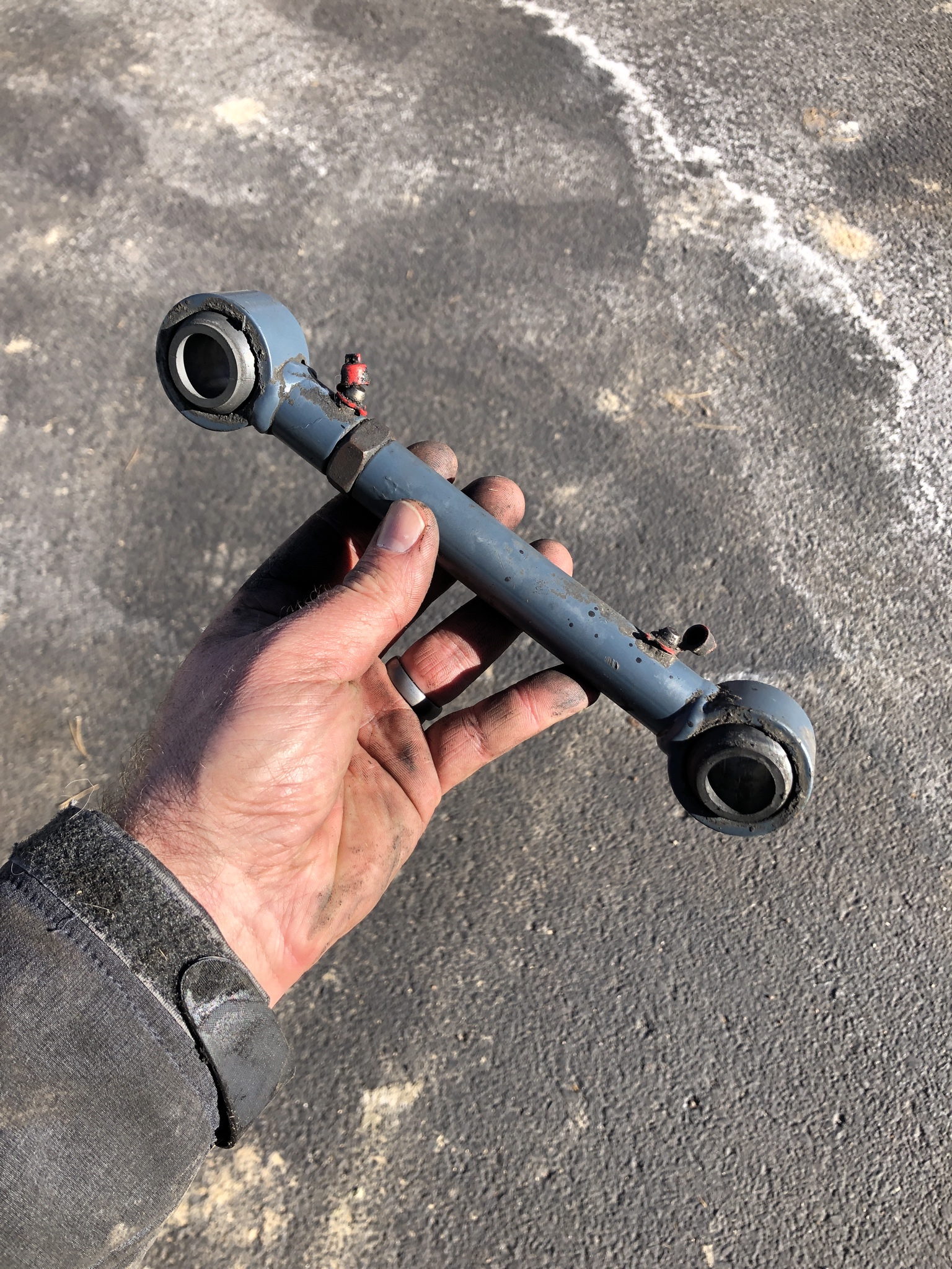

Also.. Anyone know what brand this front sway bar link is? I had to pull it out and flop it around because the zerks were facing the wrong way (other side was facing the correct way)

Nice looking front shaft. Probably feels good to have it back together.

It certainly does! Haven't gone for a drive just yet, waiting on my 2nd patch to the expansion tank to dry
Adjustable sway bar link?

That is what it is

Looks like a JKS Sway Bar Quick Disconnect.

Yep, i think you are correct!

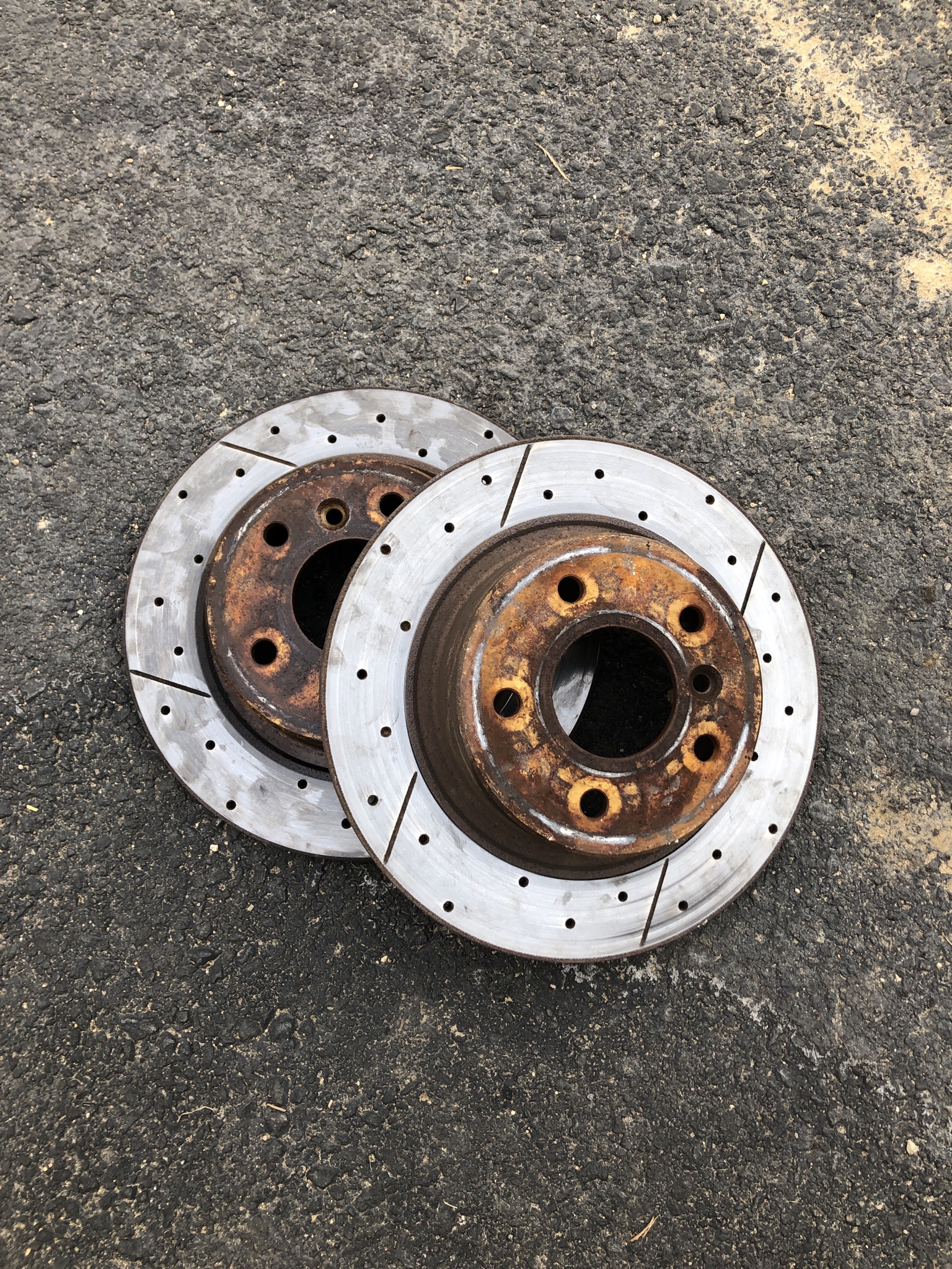

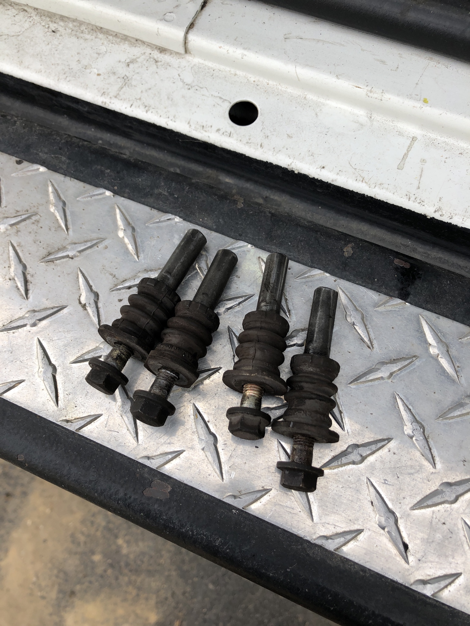

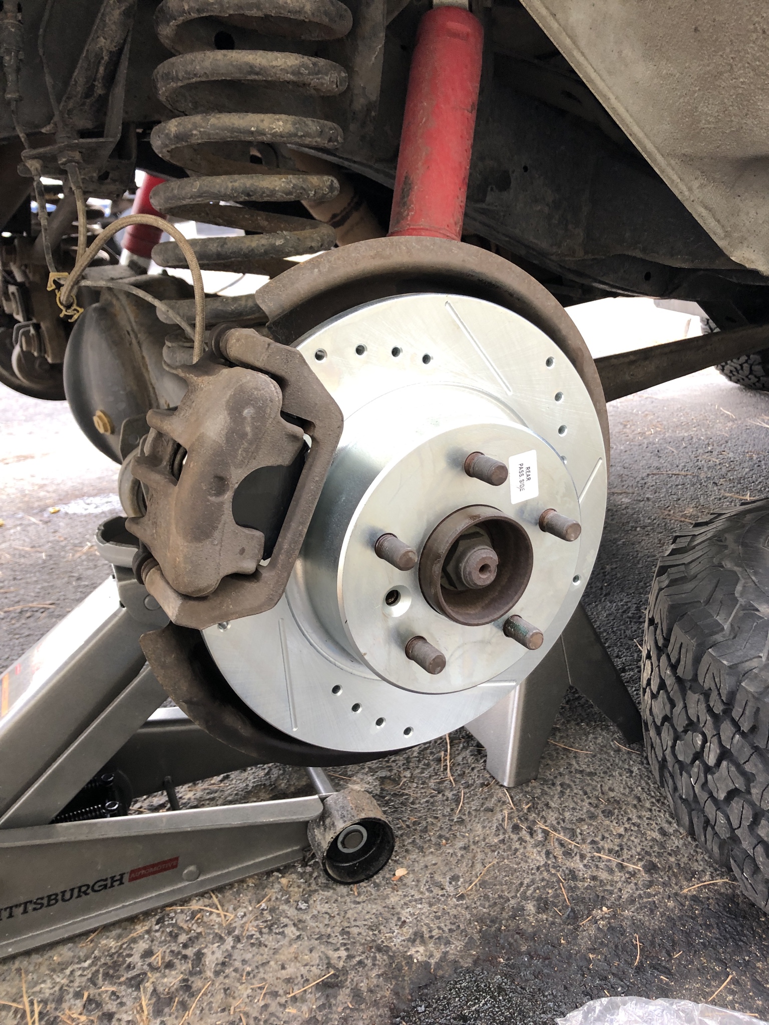

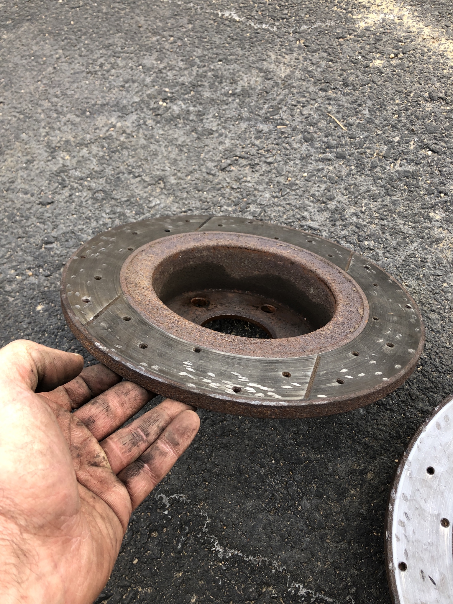

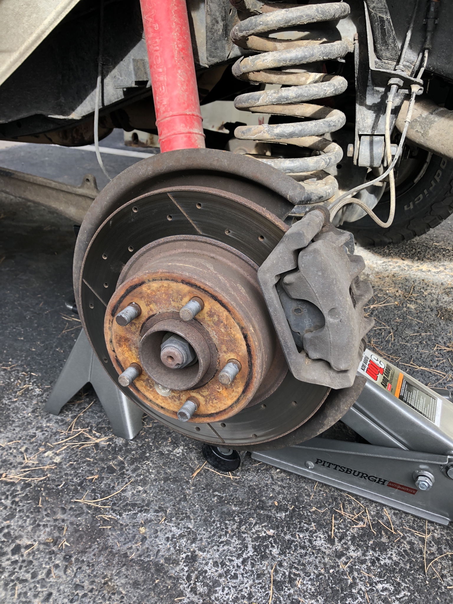

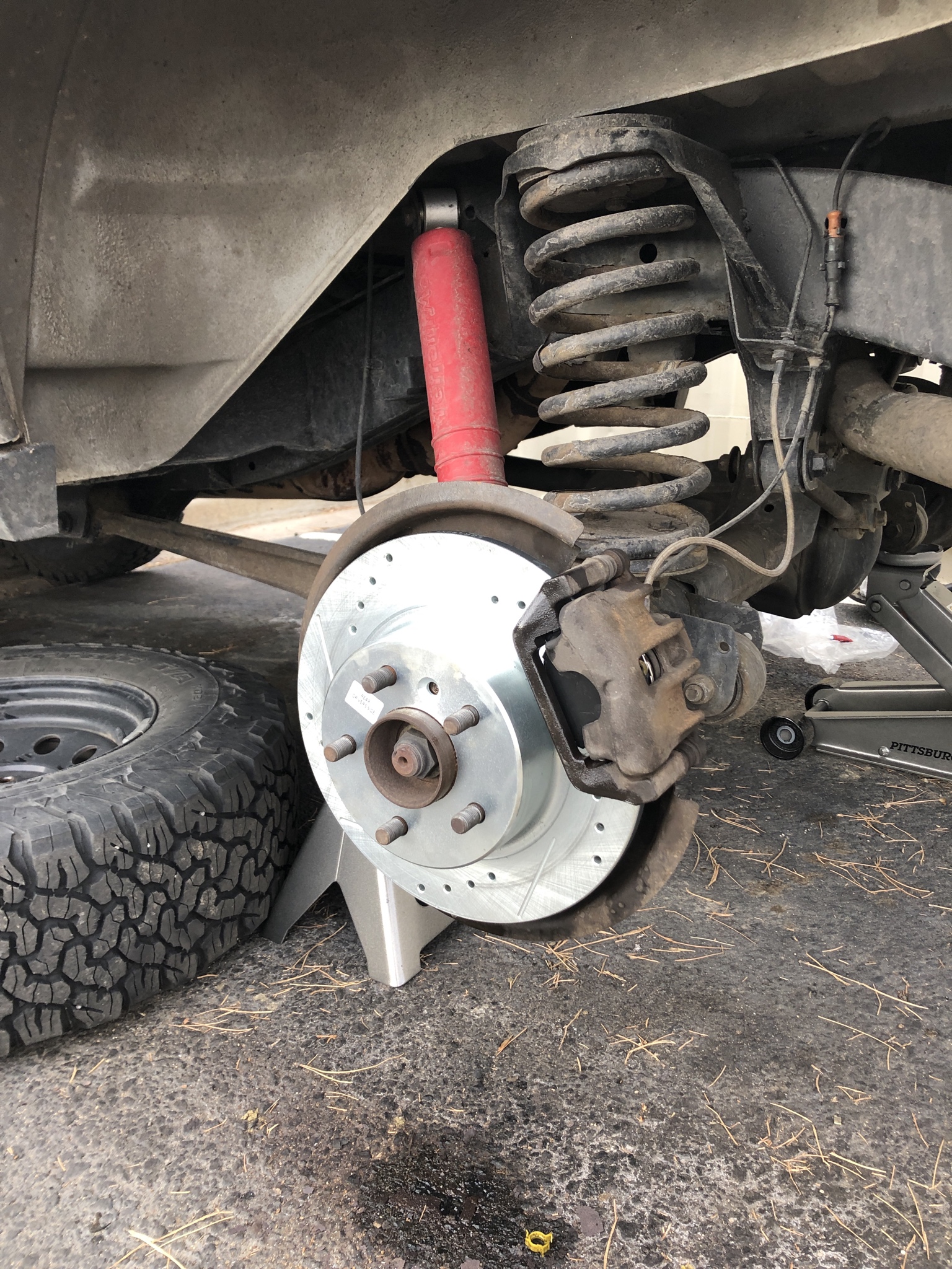

Had a bleh day today.. Got 1/2 the brakes done today, only because the caliper carrier sleeve / piston thing stripped out on the drivers side in the rear. I thought the local Fastnel would have a 5mm longer bolt but alas they did not so I had to make a run to the junkyard which was 45mins away. Oh well.. Picked up some extra sleeve / piston things for $2.29 so if any of the other corners gives me trouble, i'll be ready. Had to drill out the screws on the rotors which took longer than actually installing the new bits.

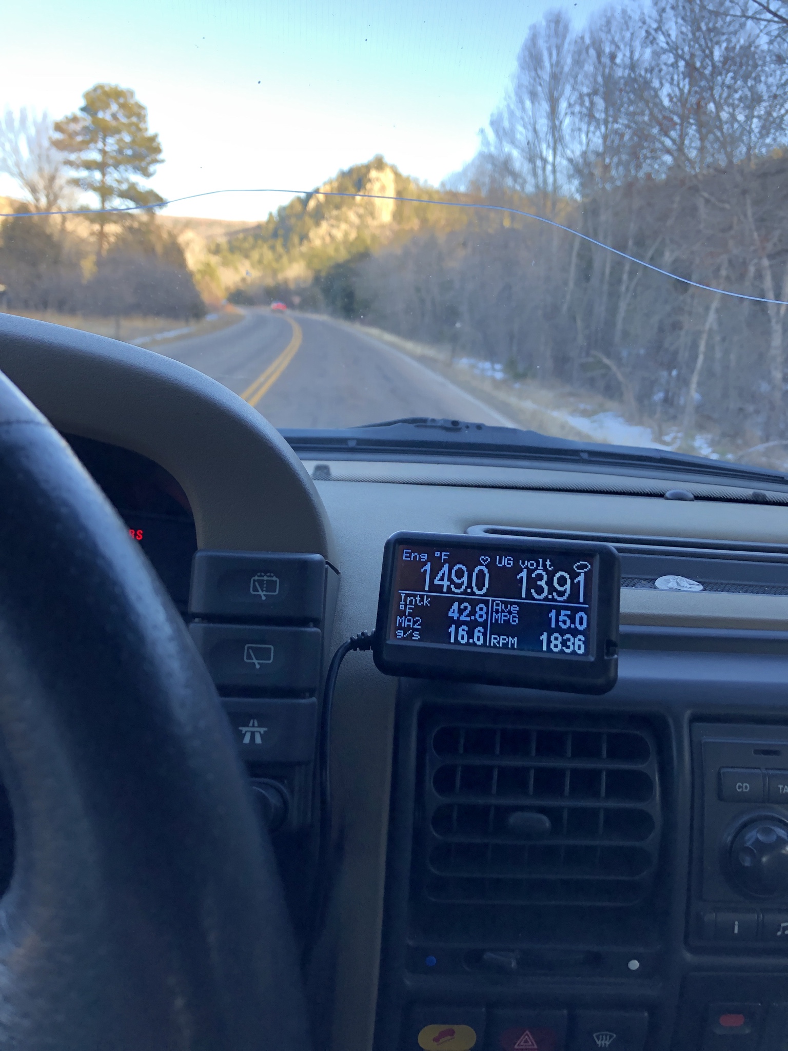

Went on a drive with the Mrs. to Bishop Castle -- things were running cool!
