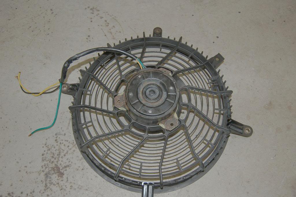

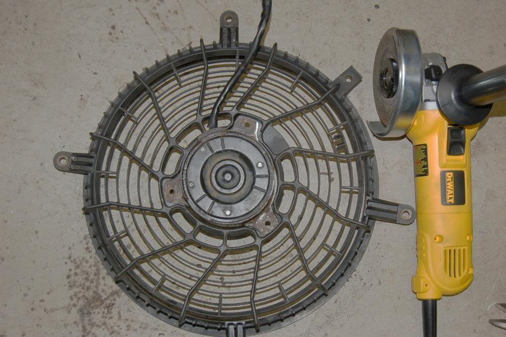

As I said before it is not done much on the D1 because I started to do some work on my DD D2.But here are few picks ...

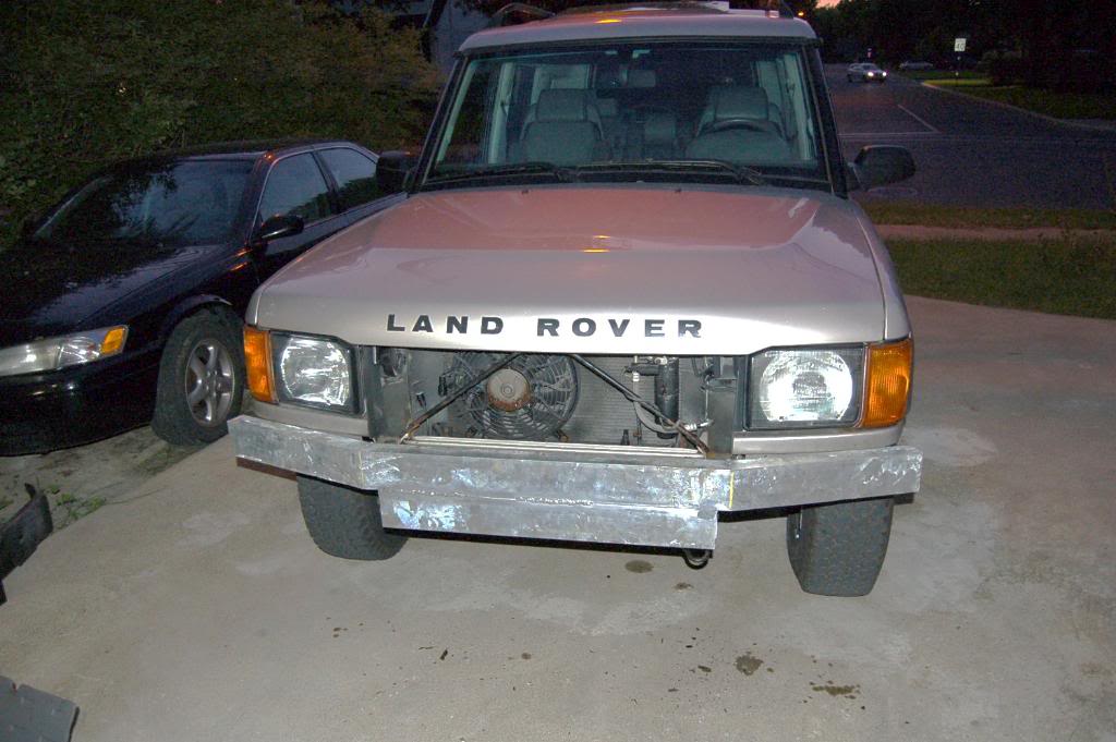

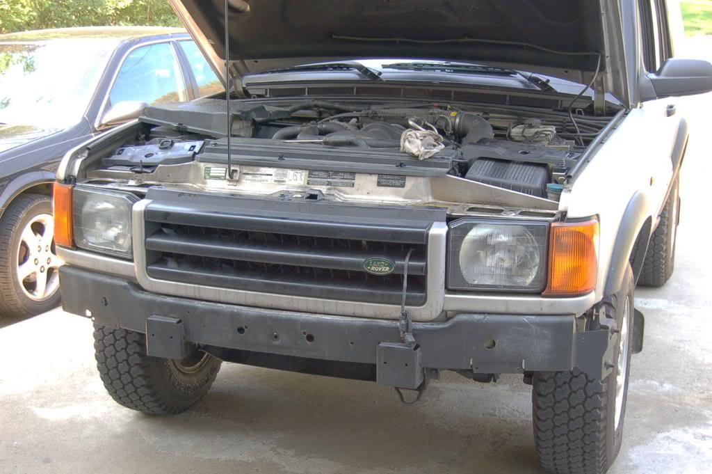

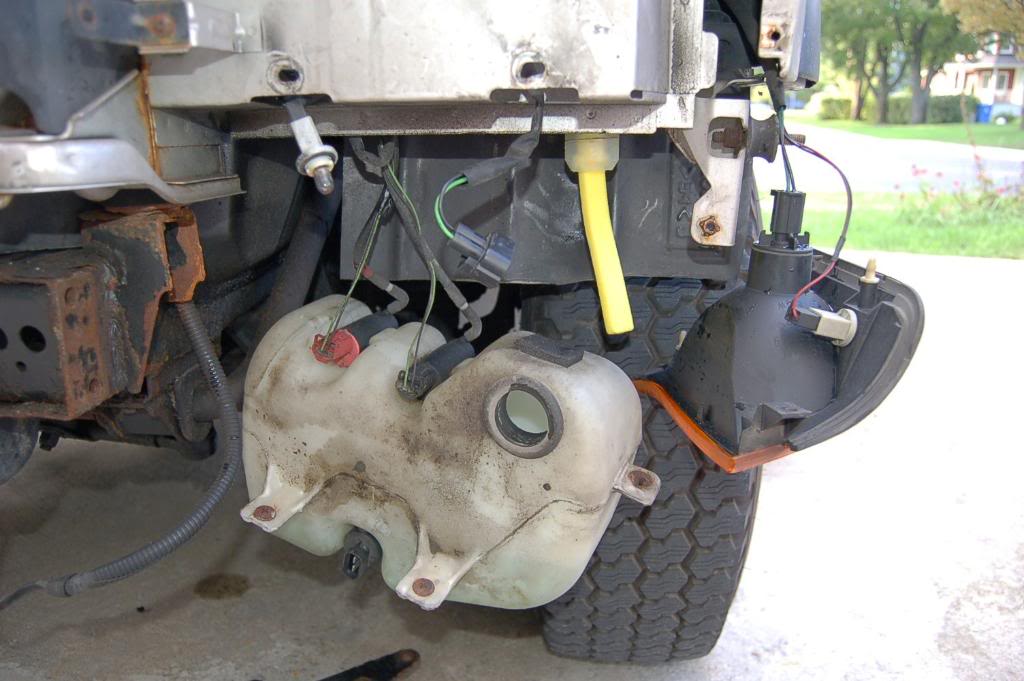

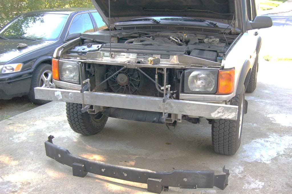

This is my work on my daily driver...front bumper was busted in the winter by ice by previous owner ...so I just kept steel bumper under it.
here you can see I started with square piece of aluminum welded to the crash absorber...
I had to remove windshield washer reservoir...
this is my new bumper ...

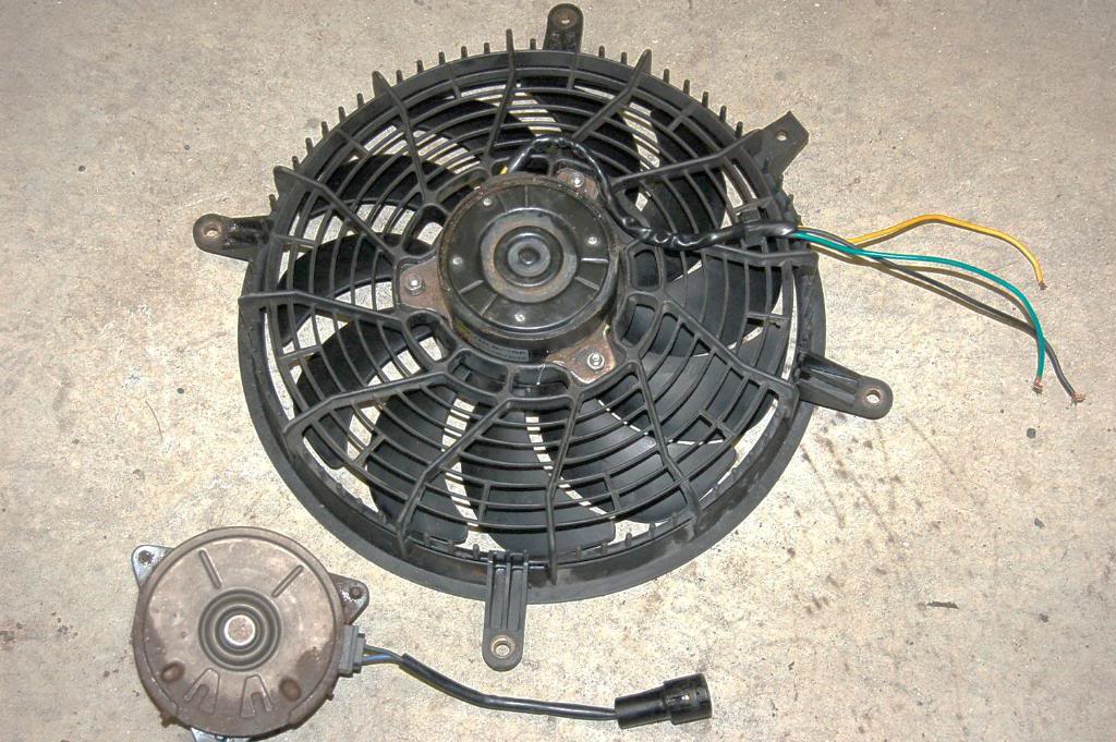

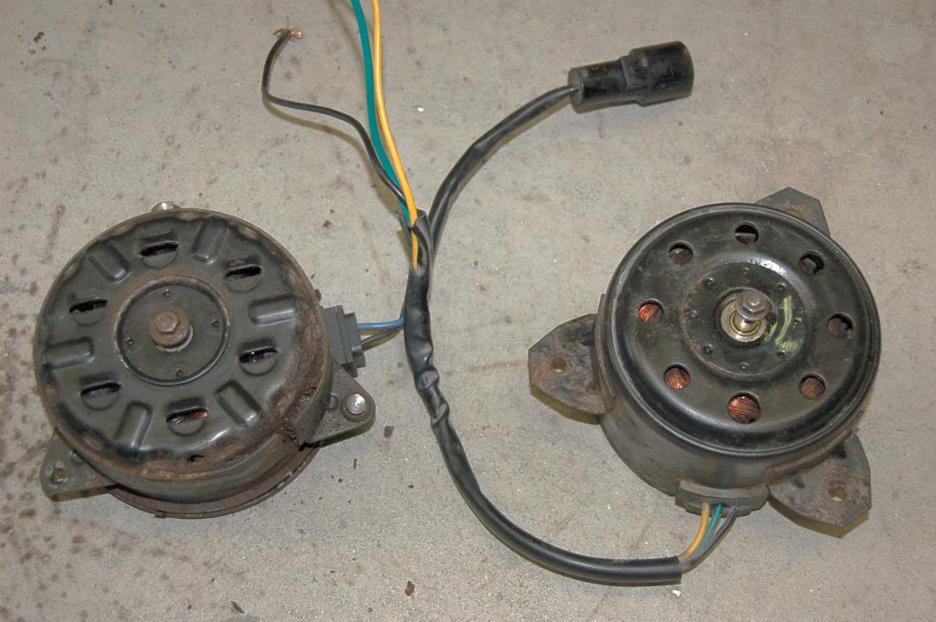

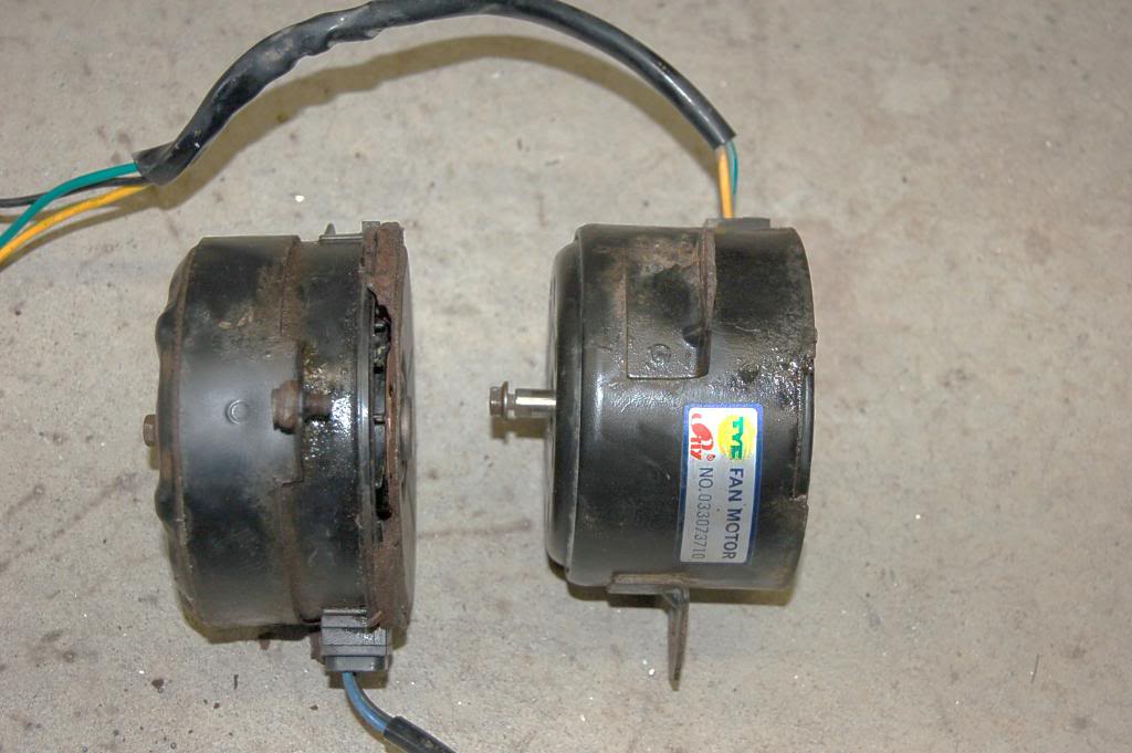

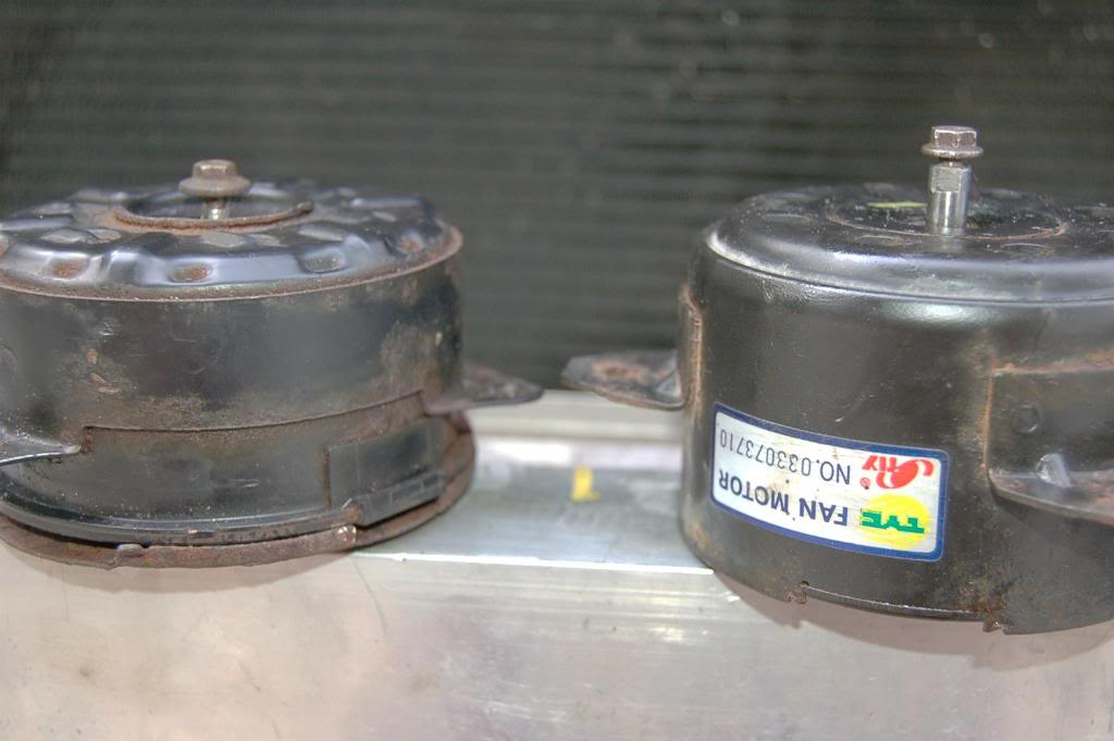

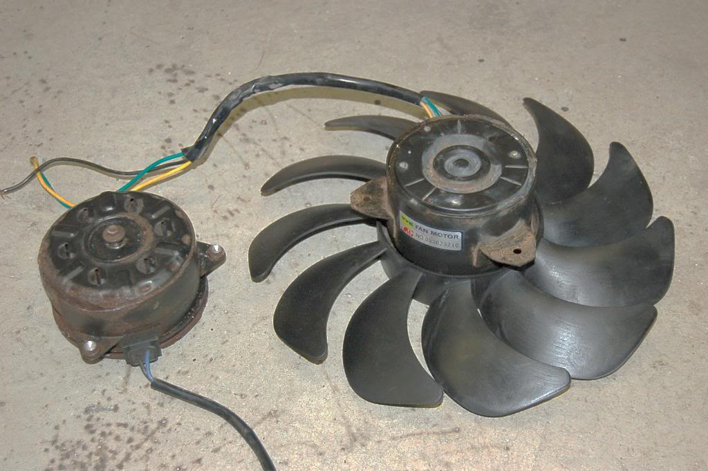

So my AC fan motor is seized.I went to the scrapyard to look for the replacement.Ford Taurus fan motor looked to big so I found motor from Chrysler Intrepid instead.Left pic is Rover and right is Chrysler...

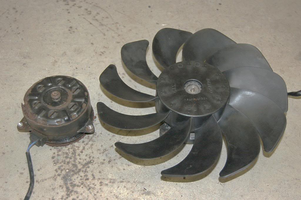

test fit propeller...perfect fit...
upside down look...
only thing is installing tabs are on different height...
I will compensate this by installing it on outside of protection shroud...tabs are too big but holes are perfect fit...yellow represent what I had to cutoff of the tabs...
tabs are trimmed...
this is finished product ready for the installation and working...I had to solder original plug on my working fan...
Here I come to the problem.Out of the truck my fan is working , but now I have to check for the orientation of the rotation on the truck so when I pluged it on the truck , put AC on fan was not working , checked the fuse , it was blown , so I replaced the fuse and still nothing . Any suggestions?
