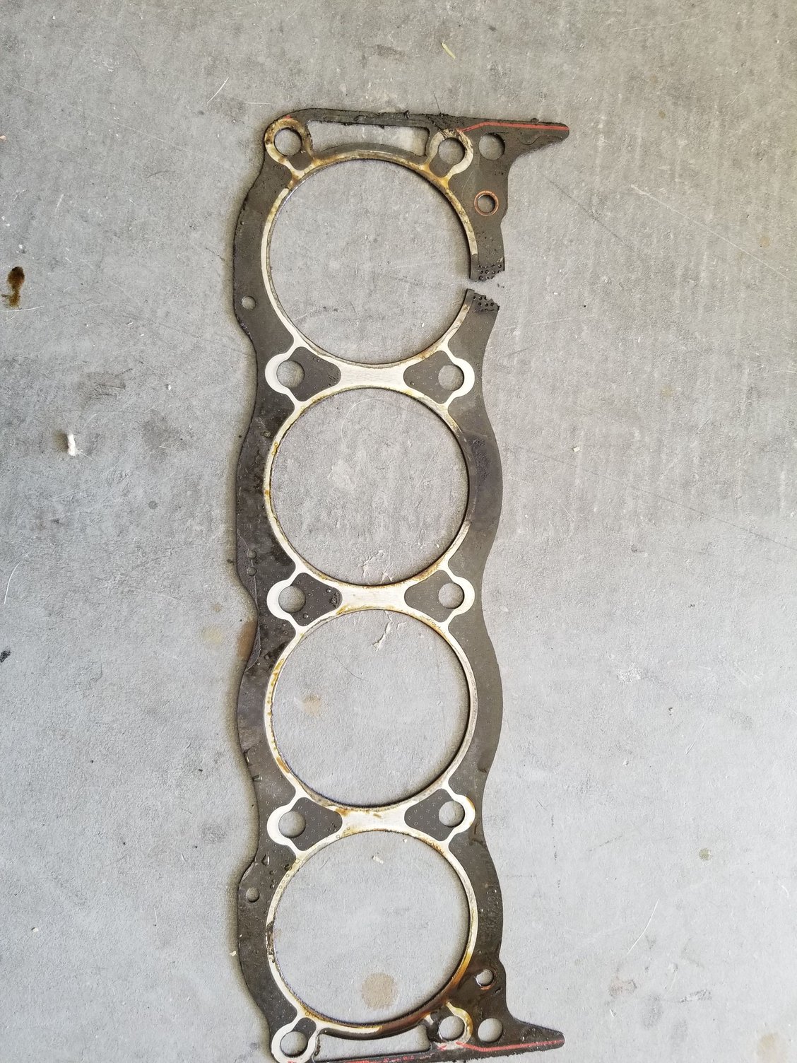

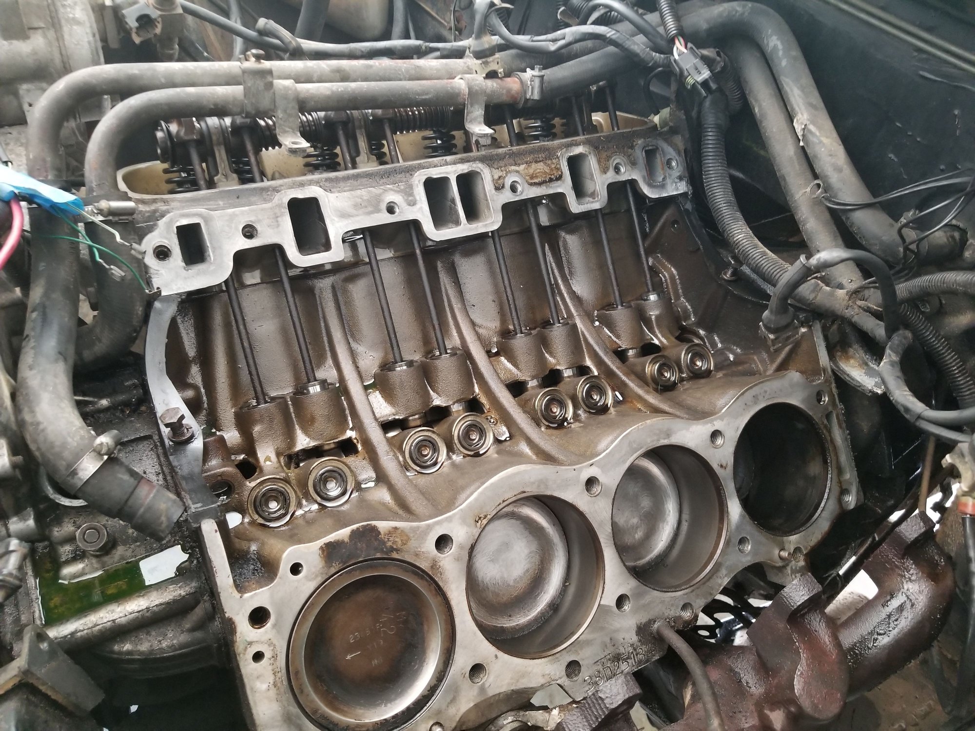

Well.... that'll do it...
No broken/burned valves. I don't know why compression would be lower on the number 2 and 4 pistons.
The engine is super clean inside. After some scrubbing I found the pistons have a curious 4.2 stamped on them. Could this indicate that this is a 4.2? Not a 3.5? It was sorta peppy for a 3.5. Any other signs I could look for?

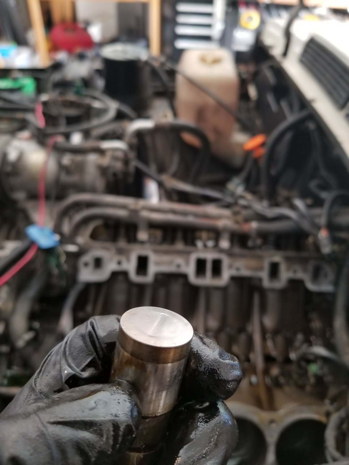

I did find this lifter had an odd pattern on it too. Others are good. At least on this side.

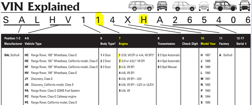

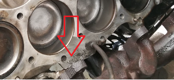

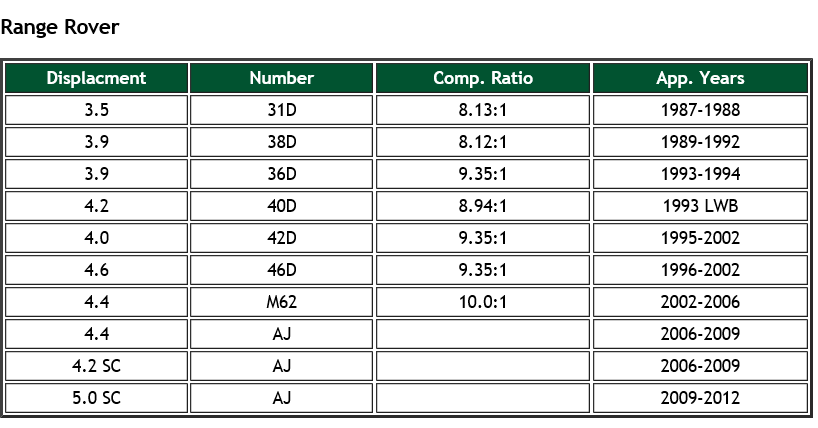

Just based on the block number 38D, it looks like this is not a 3.5 but a 3.9 liter. You can always check the VIN too.
