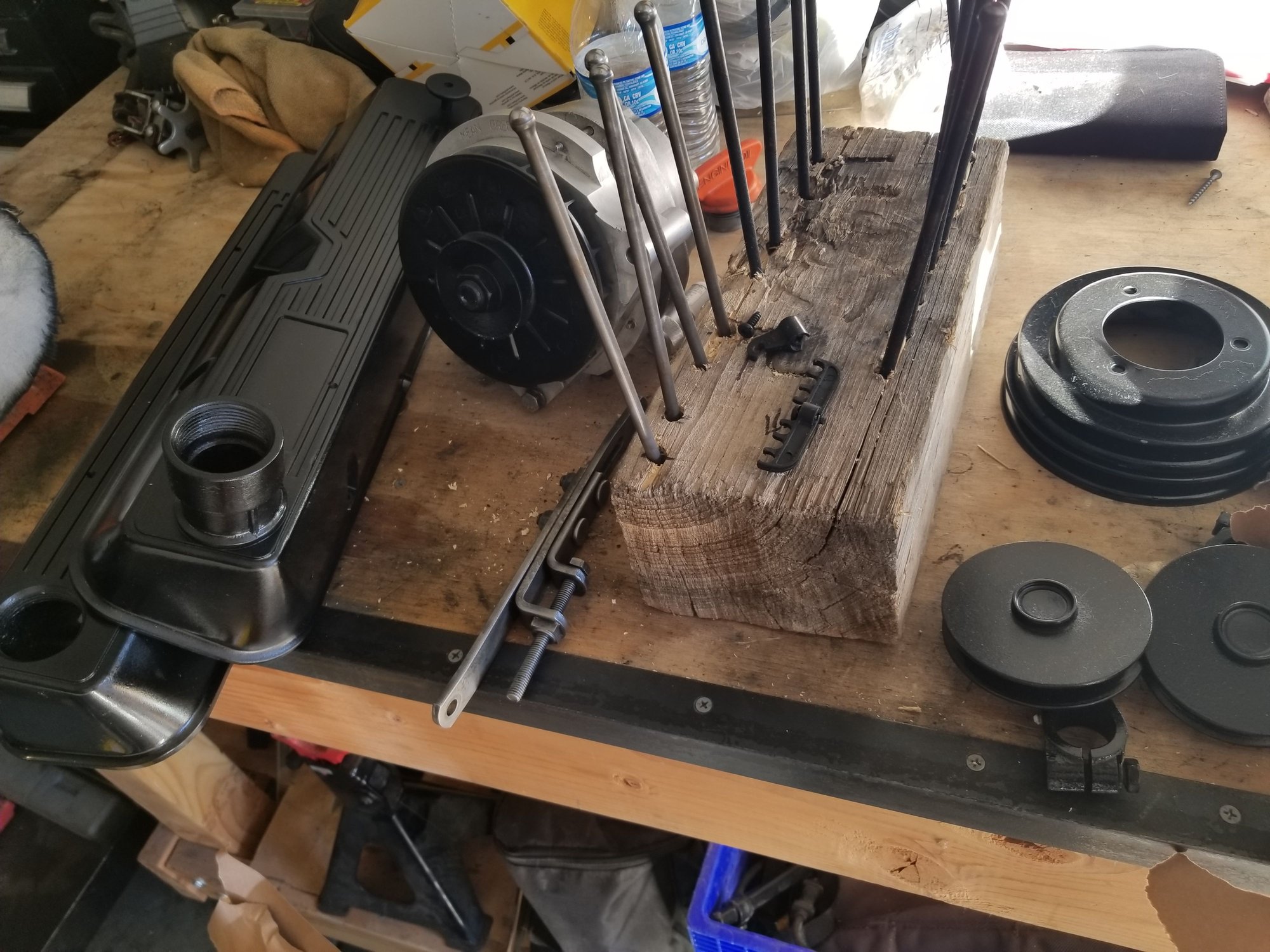

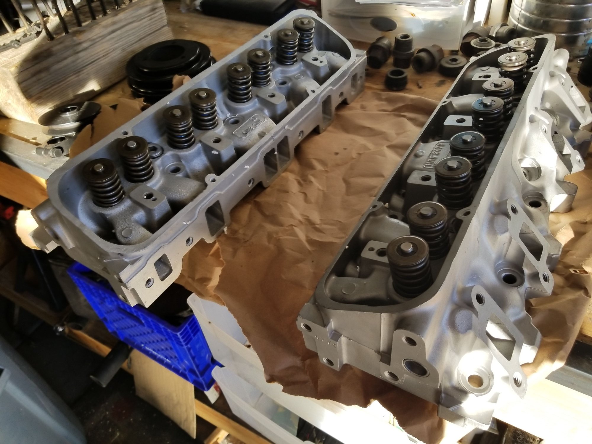

Small update time I guess.
Been waiting for my Reman heads to arrive for about 3 weeks. They finally arrived today. So I used the down time to degrease strip clean and paint my engine brackets. I did the valve covers too. I had the Mean Green alternator tested. I cleaned and polished the case. Repainted the pulley black instead of the lime green it was.
I also cleaned and degreased the engine compartment while I was at it.
I need some help with removing the linkage bracket off the upper intake. How the hell does the butterfly shaft come out? I also want to clean and paint all of that hardware. I'm worried about disturbing the TPS sensor setting. Any advise?
My second dilemma is the Cam/lifters. I found two lifters that need to be replaced. One doesn't seem like it's turning and the other looks circular but more of a indent then all the others. I'm trying not to blow my budget away here but I'm thinking the Cam may have to be do e while I'm in here. Thoughts?
The good news is after running all the numbers I can I'm almost 100% positive this is a 4 2. So I guess that's something.

I would do a cam while it was apart if it was me

Yea I think you're right. I found one on Summit Racing that's geared towards low end torque. A step above stock. Made by Crower I believe. I was gonna go with that. Unless someone else has a recommendation.
Old Dec 28, 2017 | 03:58 PM
  #120
I have the 50229 in mine, very happy with the performance gains.
