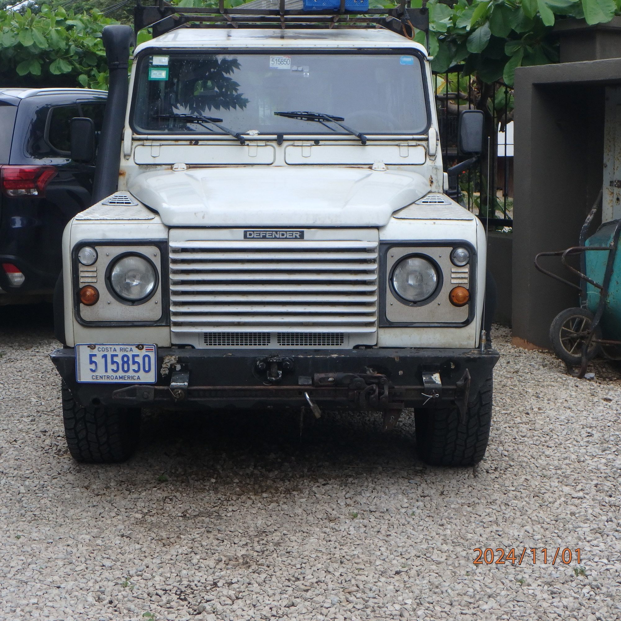

Had to get ECU from Braker in london / Angers NNN500020 reprogrammable came from 1999 Discovery TD5 . My nanocom errors out loading the .tun file check sum error Vin year numbers do not match year number map file .
looking for a way to put my vin in this ECU or is it the Lucas 10 that holding the data. Is it possible to extract the LDF or BIn file edit the HEX data ( vin number in hex format ) and put back in system ?
