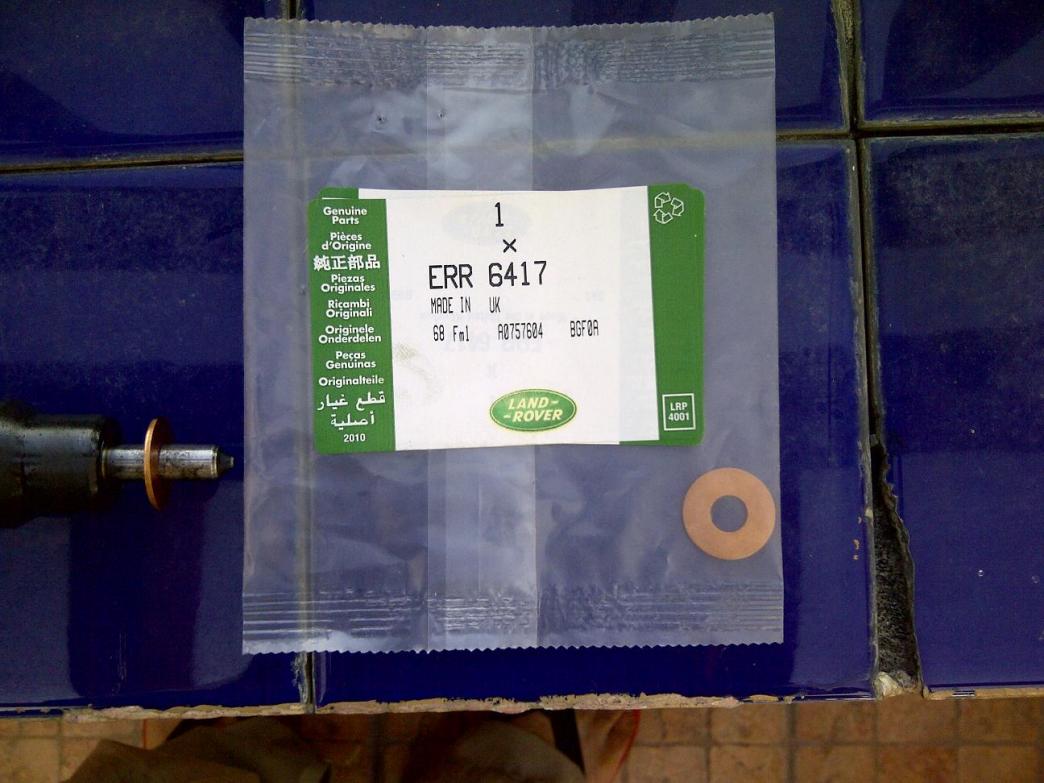

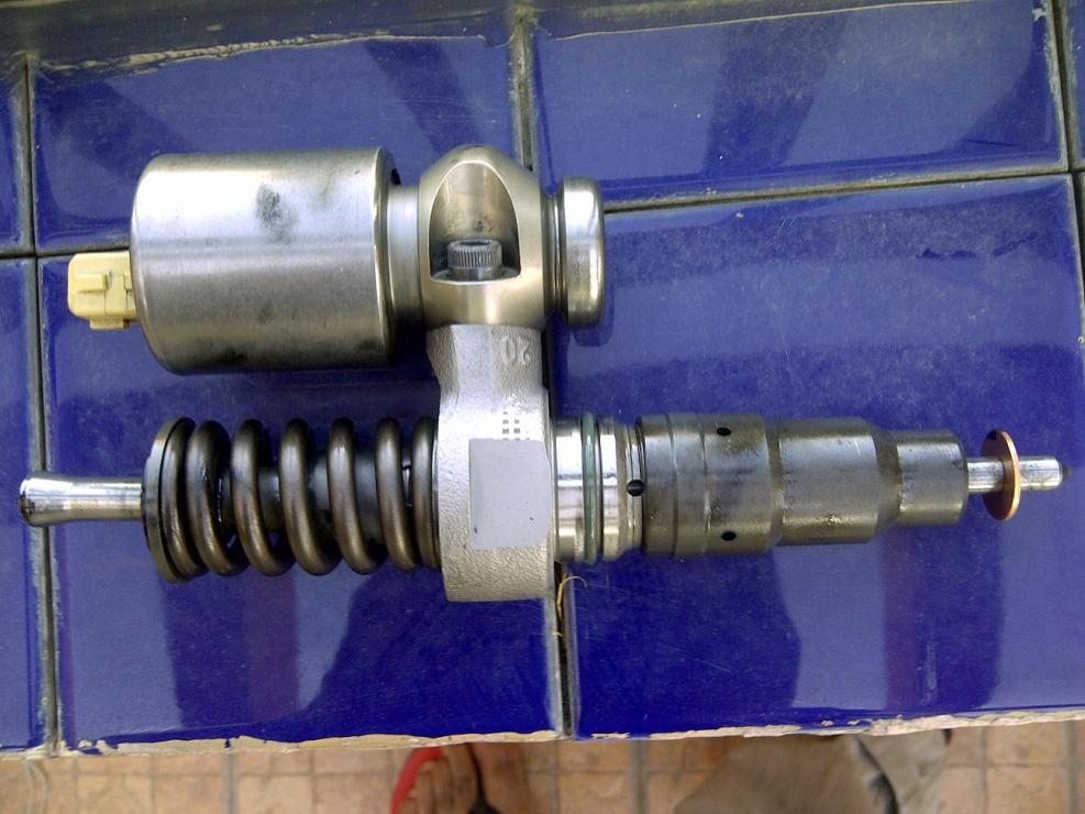

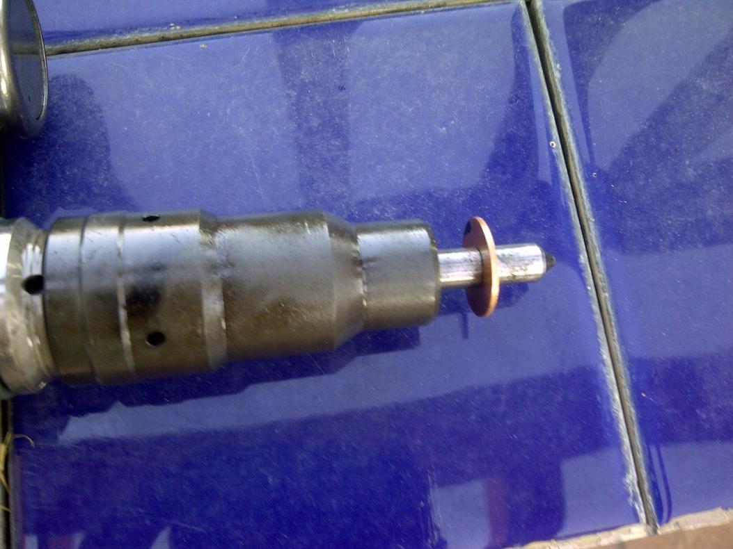

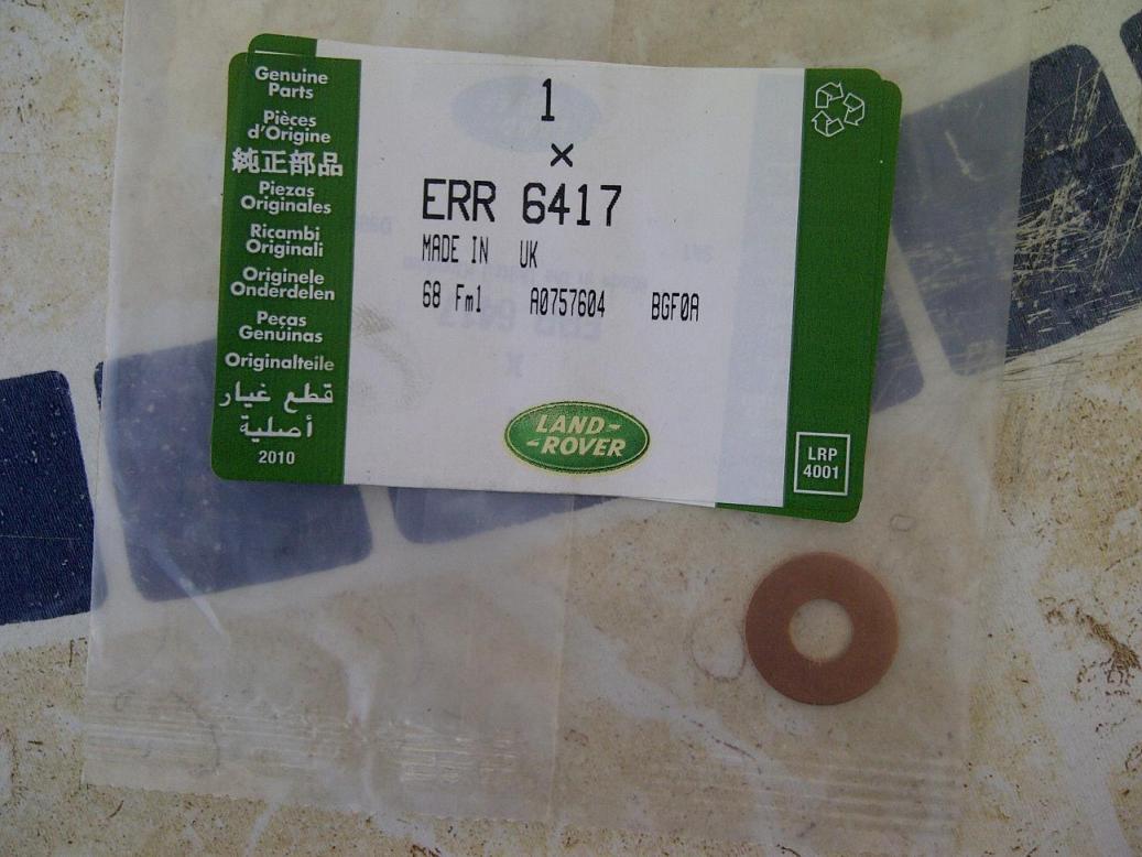

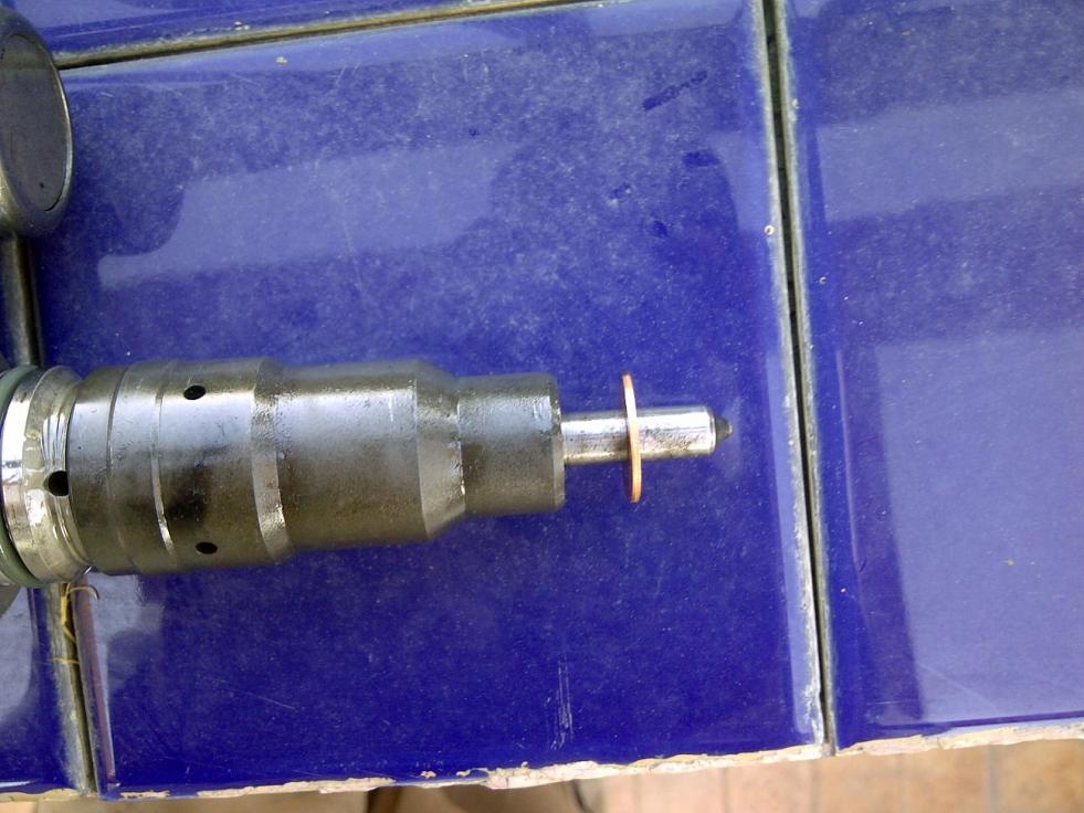

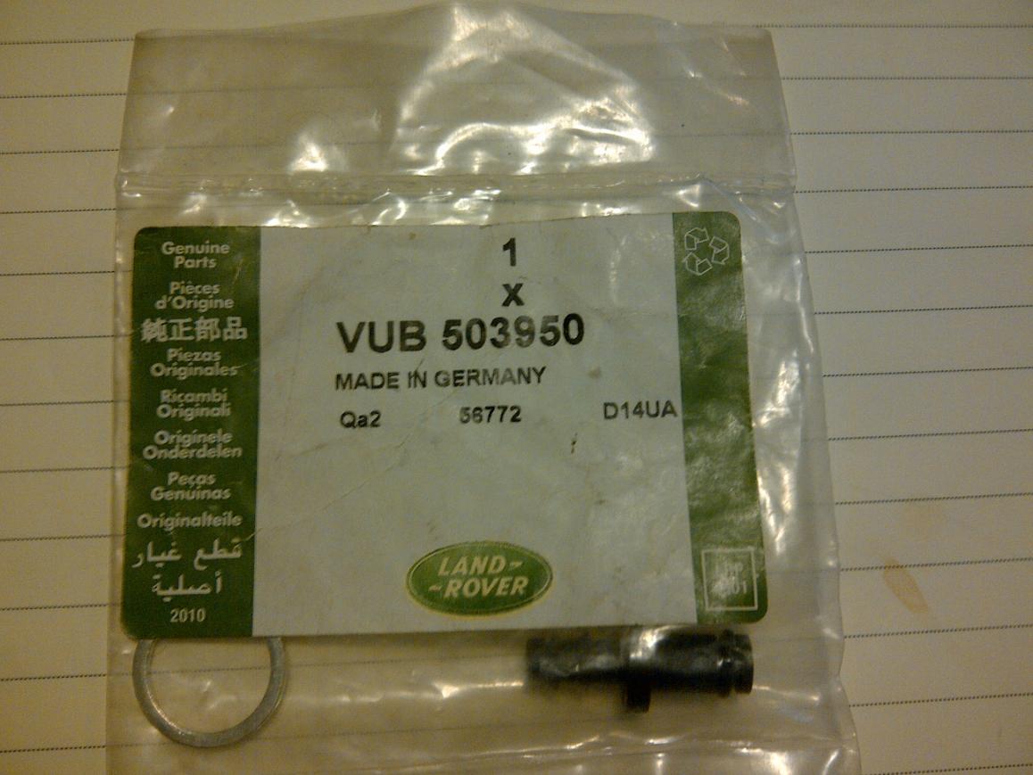

I am doing the injector washers and O rings job on my car but I am kind of stuck now.
The new washers are genuine LR part but they wouldn't go past the mid point on the injector nozzles. Am I doing anything wrong? I have cleaned the tip using fine sand paper and there's no carbon left on the tips but that's not helping. I tried forcing them a little but to no joy.
Don't want to damage any thing since nothing is available here.... got these from Dubai as well.
Do I place the washers in the head first then install injector and use the clamp to seat them in place by tightening the bolt? Is that the correct way? Would that damage anything?
Also, I washed the injectors with petrol... is that okay??
Please help?!

Any idea about the seals... anyone??

Amigo,
The washer must be seated on the injector, standard practice.
To seat it try some "GENTLE" pressure uisng a tube like tool, suggest a thin socket and go easy it should slide down onto the seat.
Make sure to seat in the injector tube is absolutely clean and NO carbon. I use rifle barrel cleaning brushed for that job. If the injector doesn't seat due to dirt on the seat it will aerate the fuel chamber/rail gallery and give you rough running or no start conditions.
Do not be tempted to force the injector down with the retention bolt.
Are you replacing the sealing O ring its recommended. Always use a lube to slide the injector into the tube. I use engine assembly grease but vaseline is a good substitute.

Okay. I tapped the washers into place with a 8mm socket, it did leave a mark though but hopefully its all good!
Yes did replace the O rings too.
Thanks for the help Tuercas!
