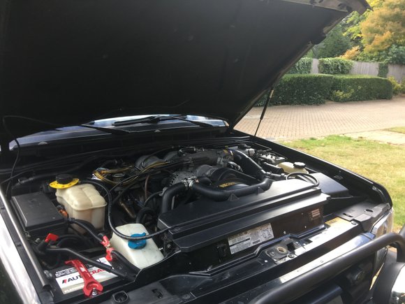

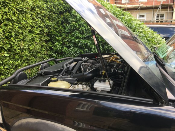

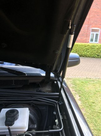

I installed one 75lbs x 17" gas prop onto my Disco 2 hood with 2 90 degree angled 10mm stud brackets.
I might add the 2nd gas prop only because the one 75lbs gas prop works well but in gusting winds I would be leary of putting my head in there.

Looks good. That looks like what I would have to do. Thanks!
