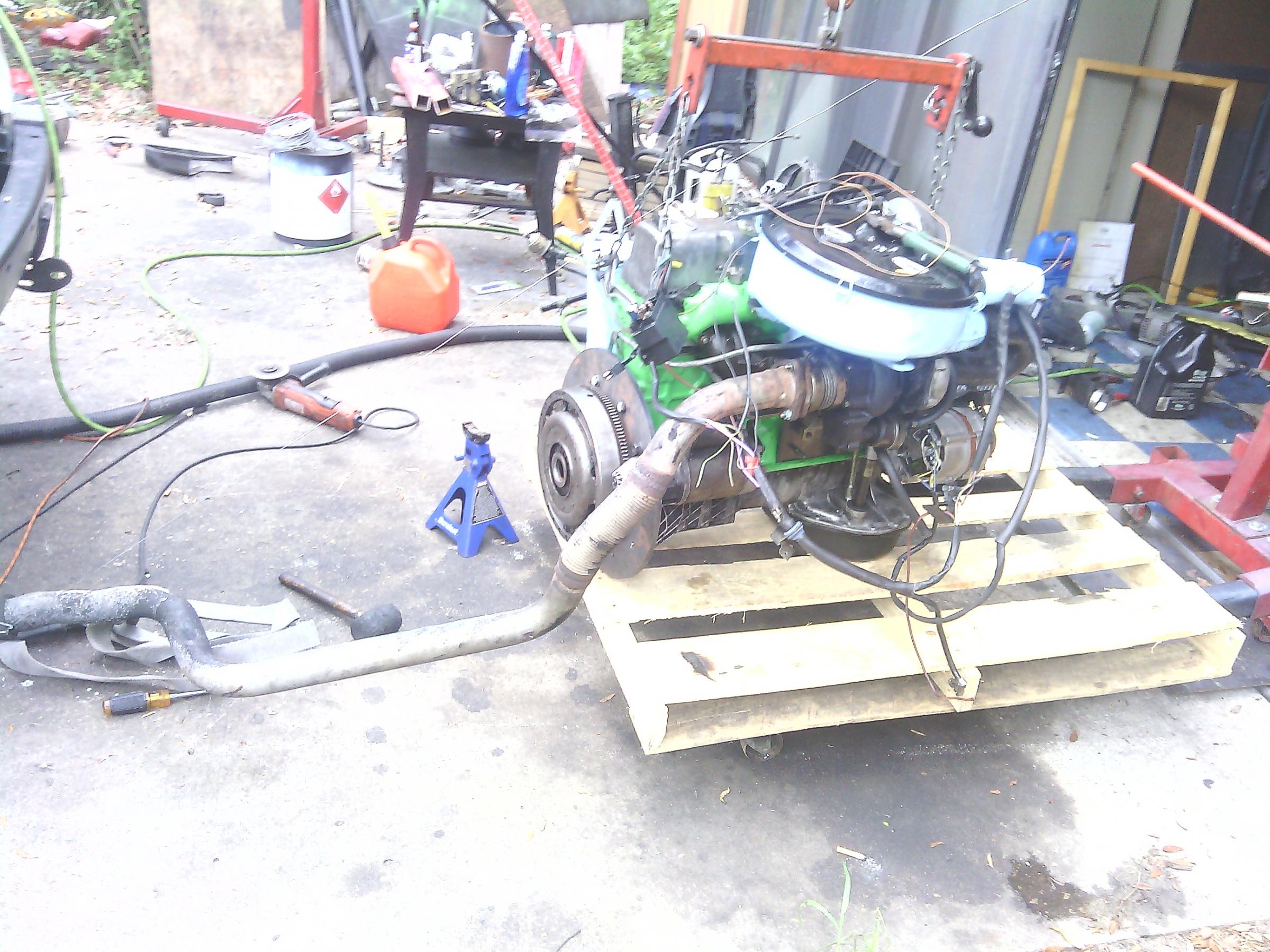

MOTOR OM617.950 / 952
This motor is the Mercedes Benz OM617.950 Turbo NON-RGR (300D EGR Delete is easy to do. just research it)
It is a 3.0L IL5 Cylinder
The specs are 125HP and 181 Ft lbs torque
I am not going to put a bunch of useless crap up on this section about the engine specifics as you can do the research and know what it is.
Here I will show what is not necessary to have and how to streamline to a stripped power plant and what I did to make it work in my truck.
If you have a 300D and are ready to pull your motor pay close attention to the things you will need to KEEP!!!
If you are getting a motor from someone these are the things you will need to get with it or … To the junk yard you will have to go or order online.

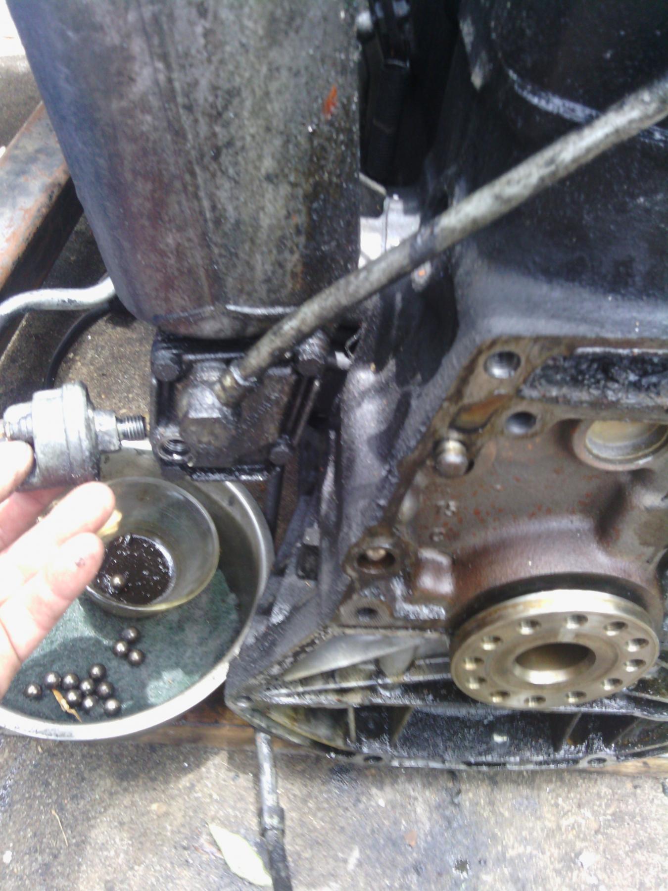

*Hose that runs from bottom of oil filter housing. This is your oil pressure sending tube to oil pressure gauge. This unscrews from the back of the Benz instrument cluster. If you have an electric pressure sending unit and a wire, you will need to pipe an elbow away from between the Adapter Plate and the Oil Filter Housing. This elbow may need to be threaded in prior to AP install.
Pull up the floor mats and get some hard vac lines. They can be found in your trunk and all through out anywhere there is carpet. They are coloured and helps for vac component identification.

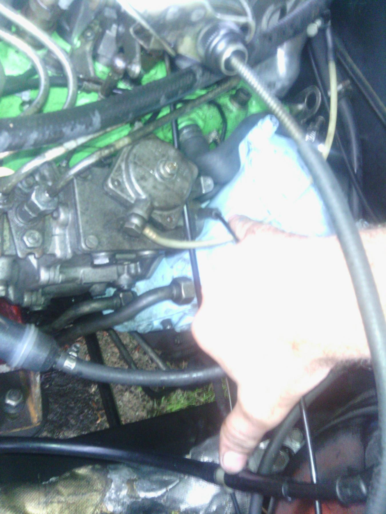

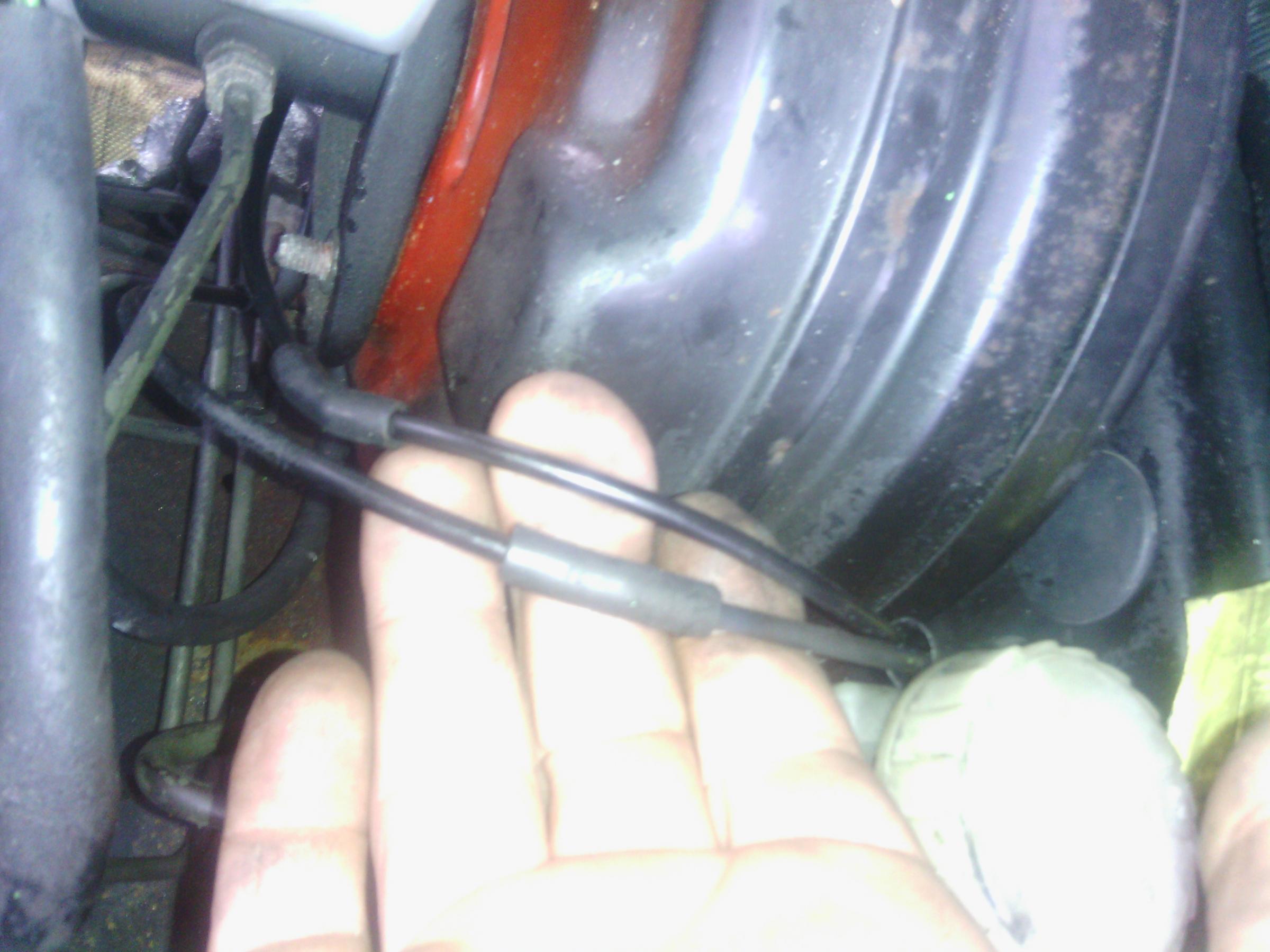

Fuel Cut Off:
Hopefully you saved this hose. There is are two T's between the break booster and the hard line of the vacuum pump. Cap off one T and run one of your vacuum lines from this T and through the the pedal plate in between the booster and clutch master cylinder. Run another line from the top of the Fuel Cut Off valve through the same hole and parallel to the other vacuum line. Make sure they will be accessible inside the Disco close to the steering column. I used the heat shrink from the top of the valve cover vacuum switch to keep them together before I sent them through the hole. Once inside the truck, cut them both to the same relative length and attach a 3 way vacuum splitter. This has created a open loop vacuum leak. With another piece of vacuum line, run it to where you can cap it off. This is also going to be your Fuel Cut Off switch.
My thumb is toughing T on main Vac line and pinky is touching the end of the loop to the IP Fuel Shut Off Diaphragm. Between is a T inside column next to key.
Now you have power breaks as well! Tadaaah!

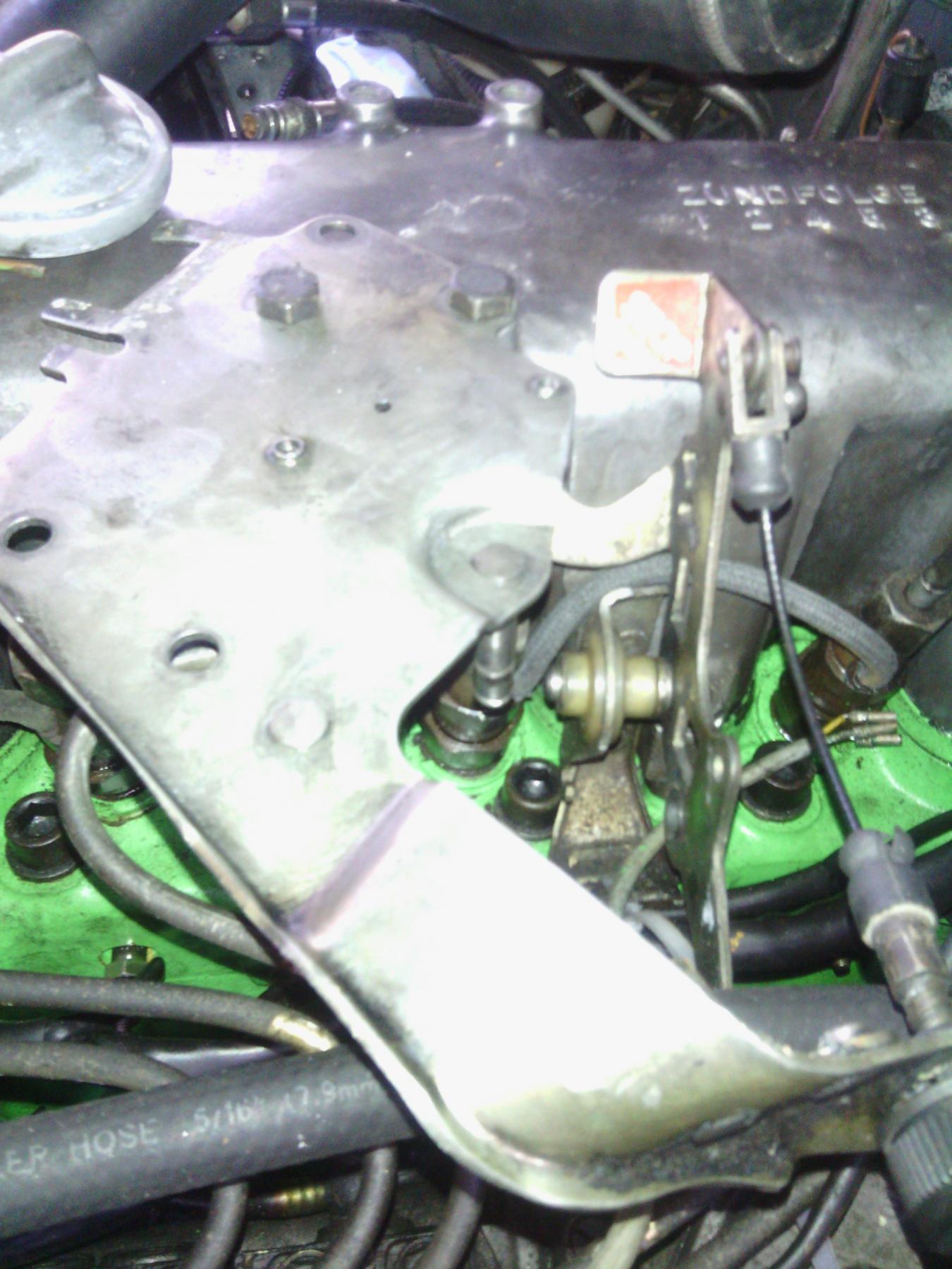

Throttle:
I used my Disco cable and attached it to a stripped and inverted Throttle / Vacuum Plate normally fount atop of the valve cover. We can use the square cable detent from where normally a bowden (kickdown) cable to the transmission. This provides an efficient and effective connectivity means for the throttle cable. The end of the cable has a split ferrel that fits perfectly around the STOP lever. Just an inch from the where it says STOP, there is a hole perfect size for the throttle cable clevis pin or if you lost it, a thicker cotter pin.
Now you can throttle from inside the Disco!

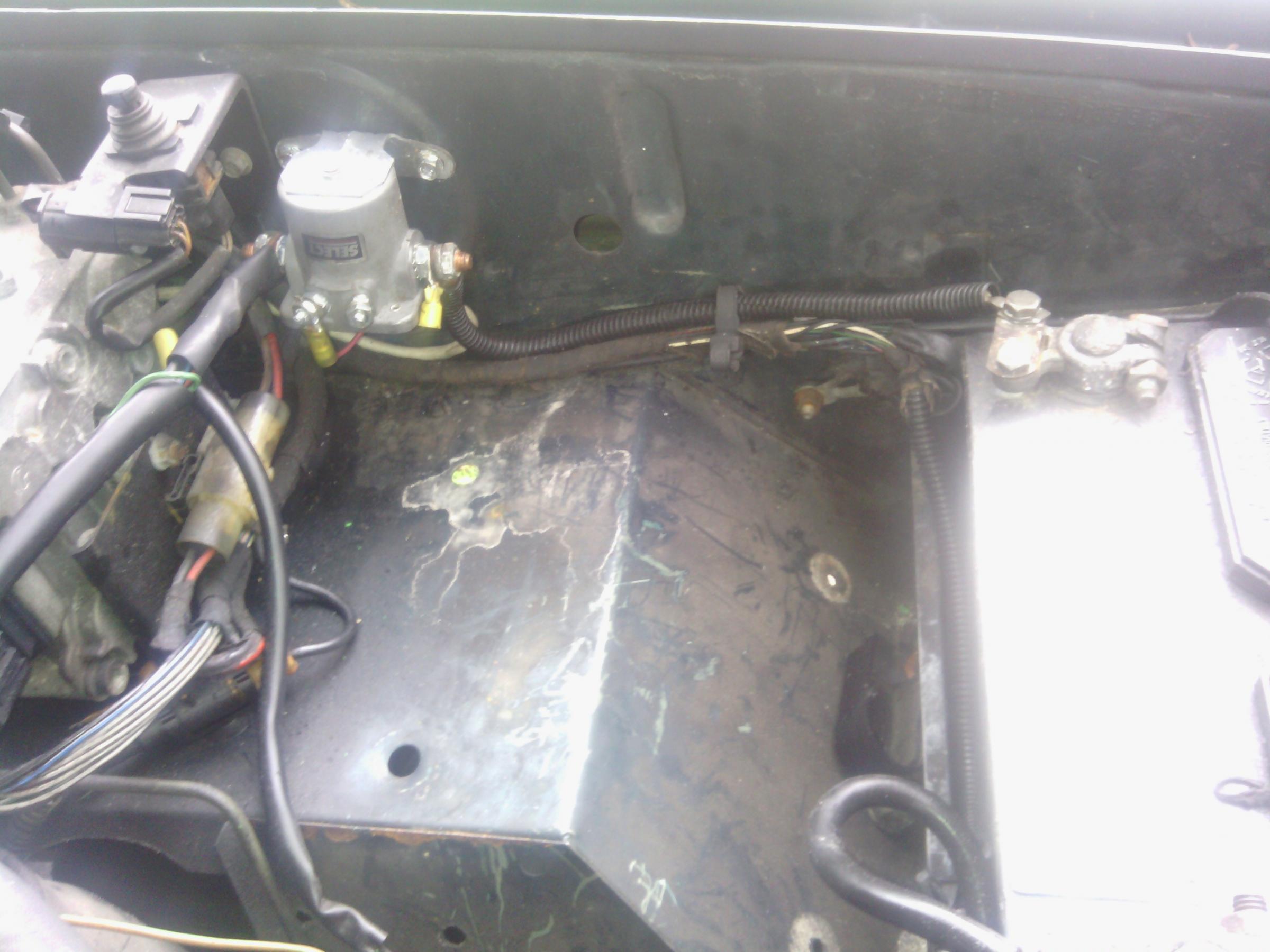

Glow Plug Circuit!
Glow plug harness is great and plugged into the Benz relay if your relay is functional as it is a timer as well. Mine was not.

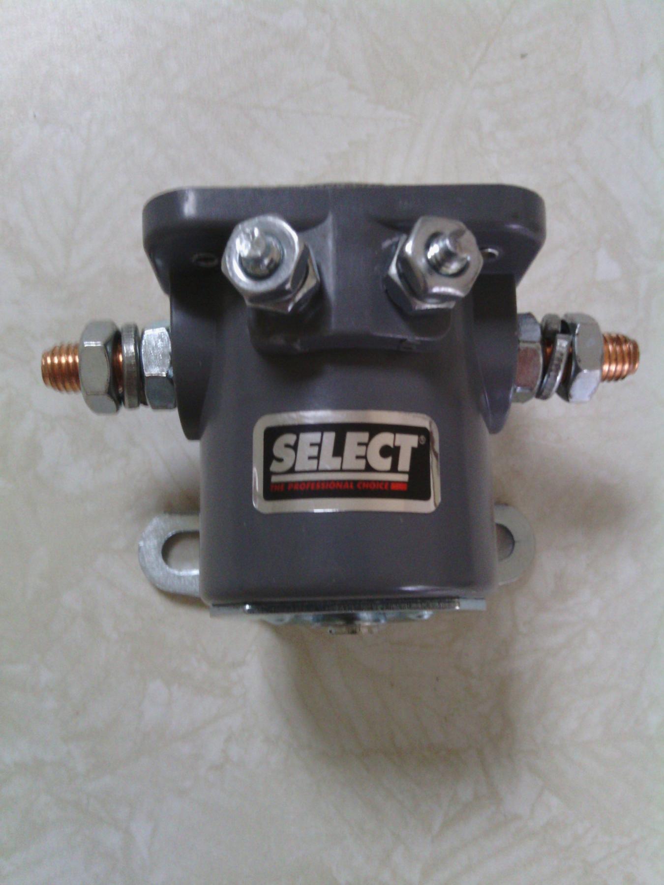

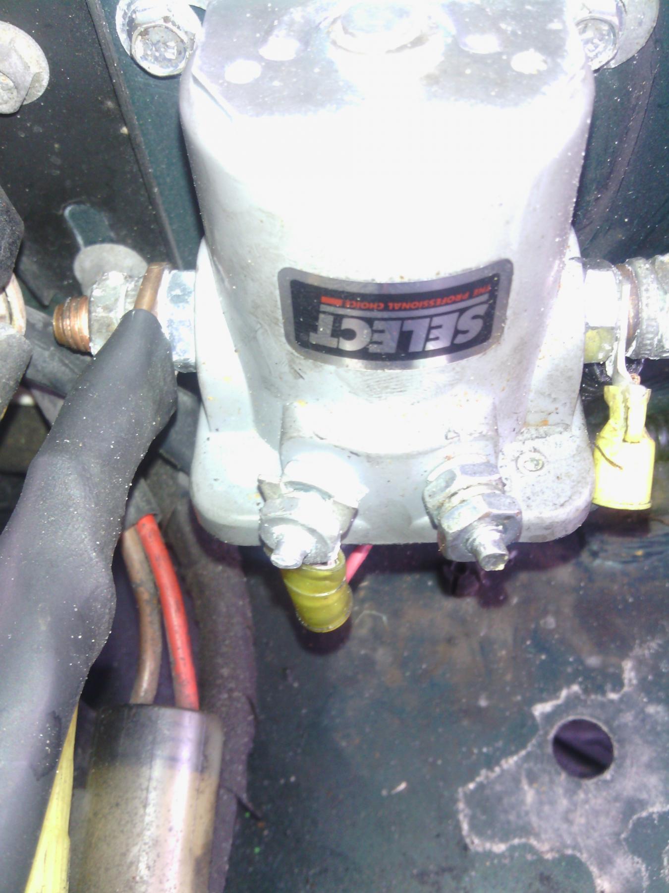

I eliminated the Benz relay and went to Advance and picked up the Select brand Heavy Duty Starter Relay that is fender mounted for on a Ford. It was about 21.00 and I am satisfied as it is heavy and works great. I ran a shielded speaker wire through the same hole as my vacuum lines and routed next to the cruise control button under my clock to a switch. I cut the 5 terminal plug off of the GP harness, stripped back about ¾ in on each wire and used a #6 lug and crimped the end then heat shrunk the lug to prevent any accidental contact causing arch or shorting my battery to ground.
Power in from battery on large lug with switch leg, Power out to Glow plug harness now cut and crimppeg on other side and a wire from the terminal marked S to the other end of the switch inside the truck. This is why I used speaker wire as not to have to run two single wires.
Now we have switched GP circuit controlled from inside the Disco!
