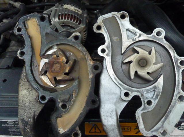

Draw your belt route now.
If you slip off the fan belt and turn the water pump you will most likely notice roughness. Did not have to remove radiator on mine. If you do, however, how about having a local indy radiator flush and rod it out? Mine was full of calcium from well water, tap water, etc., $75.
Water pump runs $50 up. Here's pix of what to expect. Main job is getting fan off the unit, do this before you take off the belt. Uses a long wrench, pop the handle toward the battery with hammer while pulling up on fan belt.
Be sure to keep bolts in order, they are various lengths. Do not want to shear one off in the front cover of the engine. Took me an hour after fan clutch off.
If taking fan apart - cupped side of blades go toward engine lock. Recheck belt route.

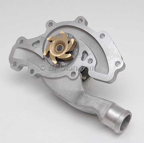

Rock Auto has starting at $47, British Pacific has @ $55 ish, BPU has a high volume pump for about $140, and up. Or $6 at the junk yard, if you spot a newer one like I did. That's it on the right.
Attached Thumbnails 94 Land Rover - Water Pump Questions-p1030594.jpg   94 Land Rover - Water Pump Questions-p1030595.jpg   94 Land Rover - Water Pump Questions-p1030596.jpg

DiscoMike posted about a high quality water pump a week or so ago but I cant find it.
$150 if I remember right.

FYI - pump Spike was looking for is at BPUtah, $140

Hi Guys -
Something seems confusing to me -
If you look at the "Belt Routing" it appears that the pulley for the water pump runs counter clockwise. -
With water pump in hand - Looks exactly like the pics in previous posts in this thread - I turn it counter clockwise and the blades in the water pump turn opposite direction then that blades -
This is very confusing - The blades point towards a clockwise direction, but turn counter clockwise -
Can someone explain why the blades are not pointed in a counter clockwise direction?

The impeller pushes water away from it, if it scooped water it would just cavitate at the impeller and not move much if any coolant.
Thats why when the belt is on wrong the engine runs hot.
Great explanation - Thanks for helping me get the confusion straight..
