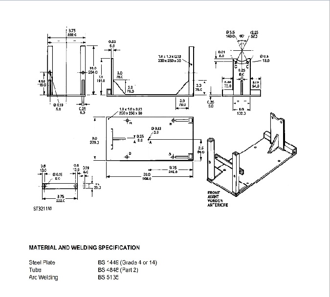

jack adapter like this?
Is that the same as
Attached Thumbnails 95 Disco I 3.9 to 300D Turbo Diesel Conversion-r380_hoist_adapter.jpg

nope, it is a plate off an old transfer case, which allows you to bolt it on, and move good transfer case about with a floor jack. When done, install correct plate and fill transfer case.
That makes perfect sense to me. That would work for me for the xfer case. What is the weight on one anyway? I loved Savannah for 8 months I was there. Wet *****'s ROCKS.lol. Nice to have you along as well.

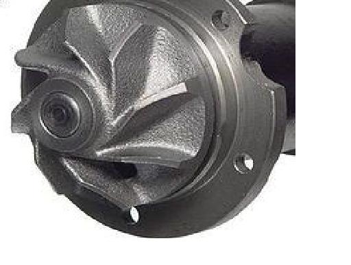

Thumbs up UPDATED Over Heating Issue Resolved.
The over heating issue on my OM627 is resolved!!!. Banjo flow tube from water pump housing to head was clogged. Filled donor engine while running and burped or bled air out of system. Ran for 3 hours and drove a few miles and barely saw fuel gauge move. Still need Fan Clutch. I must state that I am impressed with the cast impeller on the water pump MB designed. It is like a Turbine. Water pump very well built. I did find a bit of corrosion at the hose connection on the housing though.. Dremmel action.
So now I can move forward with ripping out the donor motor. Will post pics and a vid on my youtube channel. I will try not to stammer and pause. I will script the dialogue. I am not very good at public speaking. Tomorrow and Sunday will be labor times of the rip out.
Then I will document any need for lower end repair. Connecting Rod bearings, main and rings. If necessary I will dissect the OM617 to do the head Gasket. I will be posting pics and findings of the oil pan and sump coloration.
