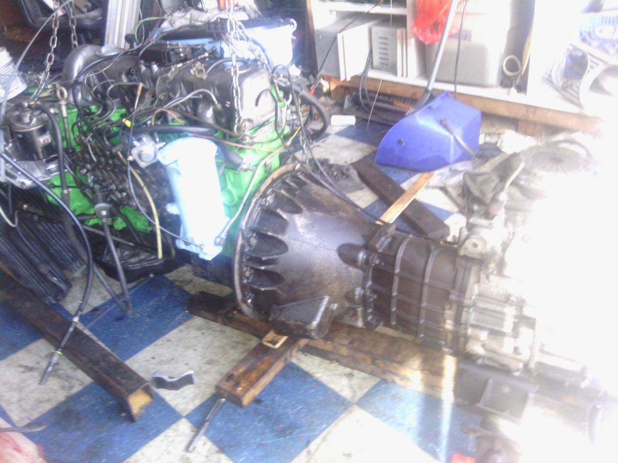

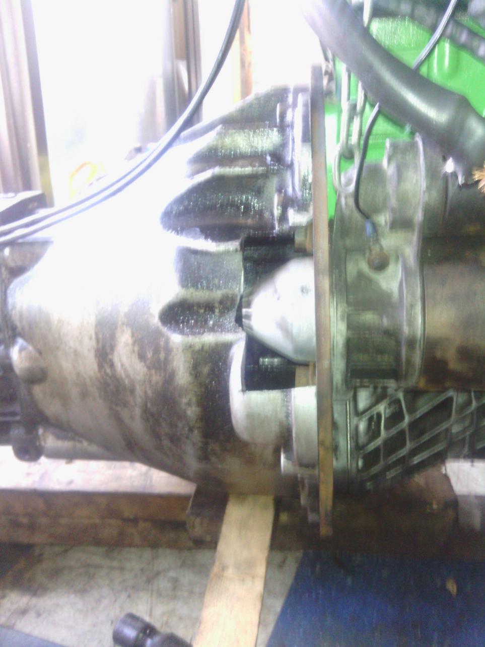

Just an update quick.
I learned to weld with a stick welder yesterday. Not hard but takes attention to speed, arch length and my friend is happy he has a trailer gate that closes nicely.
I have my R380 mated up to the OM617 briefly this afternoon to ensure all holes drilled in the adapter plate are aligned with the bell housing.
The trans and xfer case are under the DI ready to be put in straight away in the morning. Then motor will be dropped in so I can place mount sills to frame and cut my square tube for motor mounts them selves.
The goal is completion on friday.
Left to do.... exhaust from down pipe back where old y pipe meets secondary muffler... transfer rear diff from r380 donor and axles... mount power steering pump and modify hose to steering box connect fuel lines to motor and remove rover fuel pump from tank and bore out the fueling hole so FAT diesel nozzle will fit. more to come.
