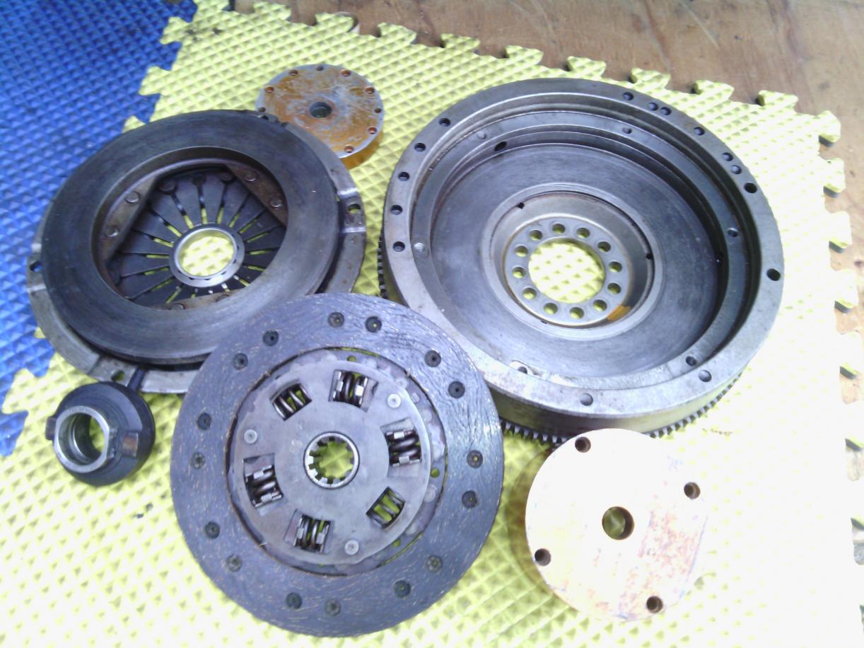

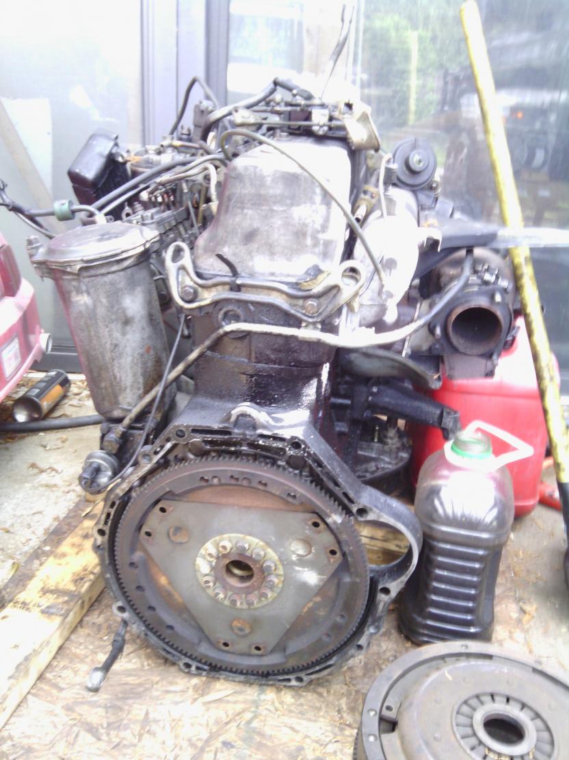

Here is the motor. an OM617 Benz motor. Tat at bottom right is a flywheel and friction plate.
I picked up a manual flywheel, clutch disk, friction plate and throw bearing super cheap!! Actually I have two sets.

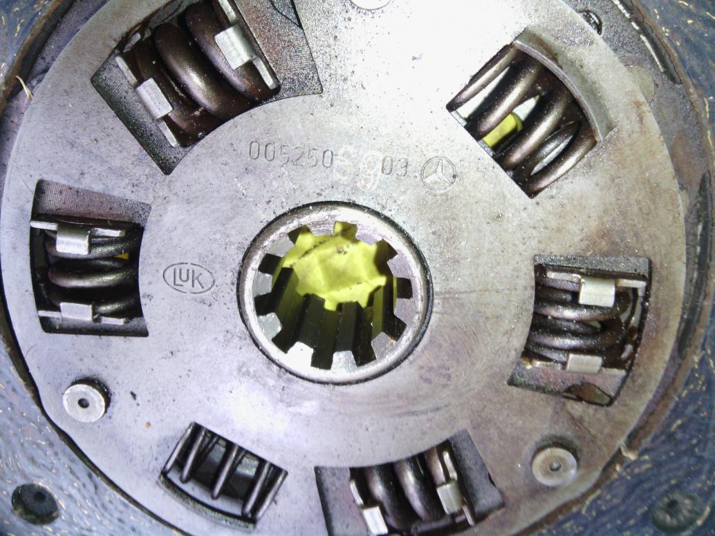

This is the Benz 10 spline clutch disk that i want to use but the input shaft of the Rover R380 has 22? splines

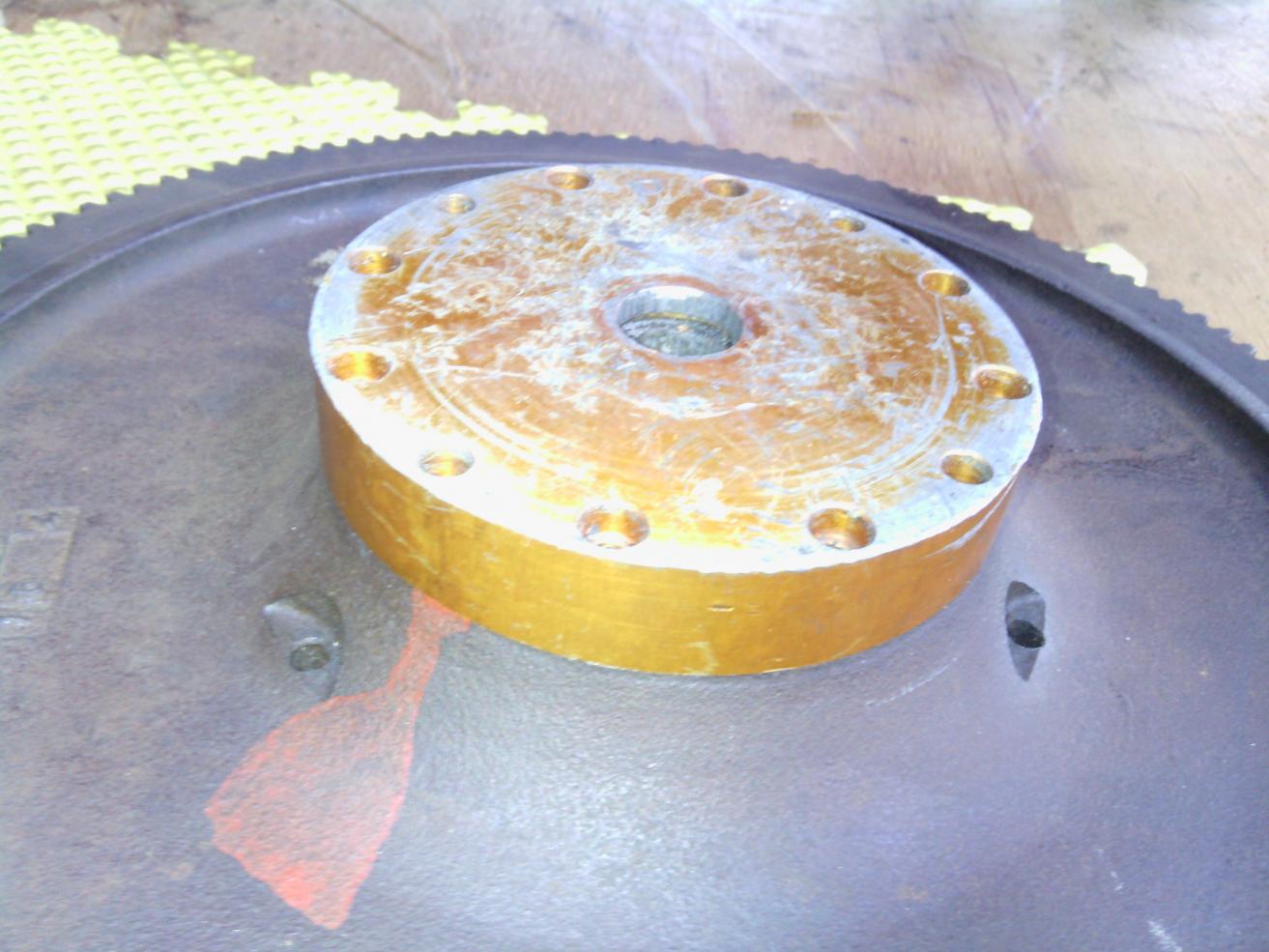

This is the crank side of the manual flywheel with my aluminium disk setting on top that may space the flywheel.If you look closely, the inside bore of the disk is close to the OD of the input shaft of the r380.

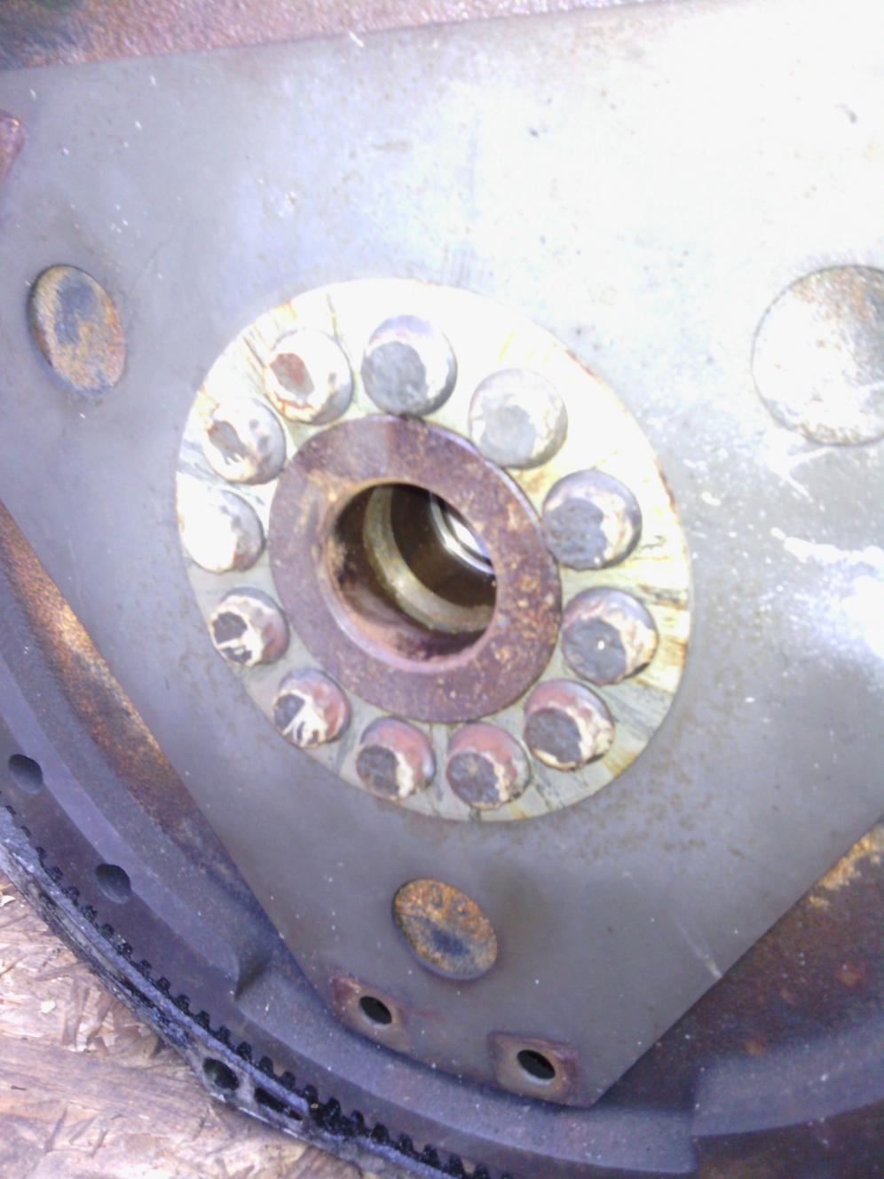

This shows the larger bore that the torque converter goes into motor side. The Rover uses only a thin bronze (sleeve) or spigot bushing and I need to adapt to the flywheel or get a bearing to close the distance between the R380 input shaft and the bore of the flywheel or crank flange. This auto flywheel is to be replaced by manual flywheel.
