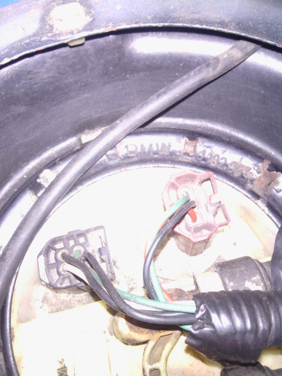

98 discovery has BMW flywheel and if you haven't needed to pull your fuel pump yet, I hate to spoil the surprise but you are going to find the lock ring is embossed with BMW.
Attachment 21277
My Ford had a similar set up with the lock ring. They all call for special tools to do it right, but I got by with a screwdriver and a hammer. Just need to try to tap in gently around and unscrew it off. Here is a exploded view of the pump housing:
