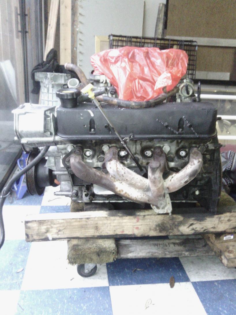

95 Disco I 3.9 to 300D Turbo Diesel Conversion
Here is the motor. an OM617 Benz motor. Tat at bottom right is a flywheel and friction plate.

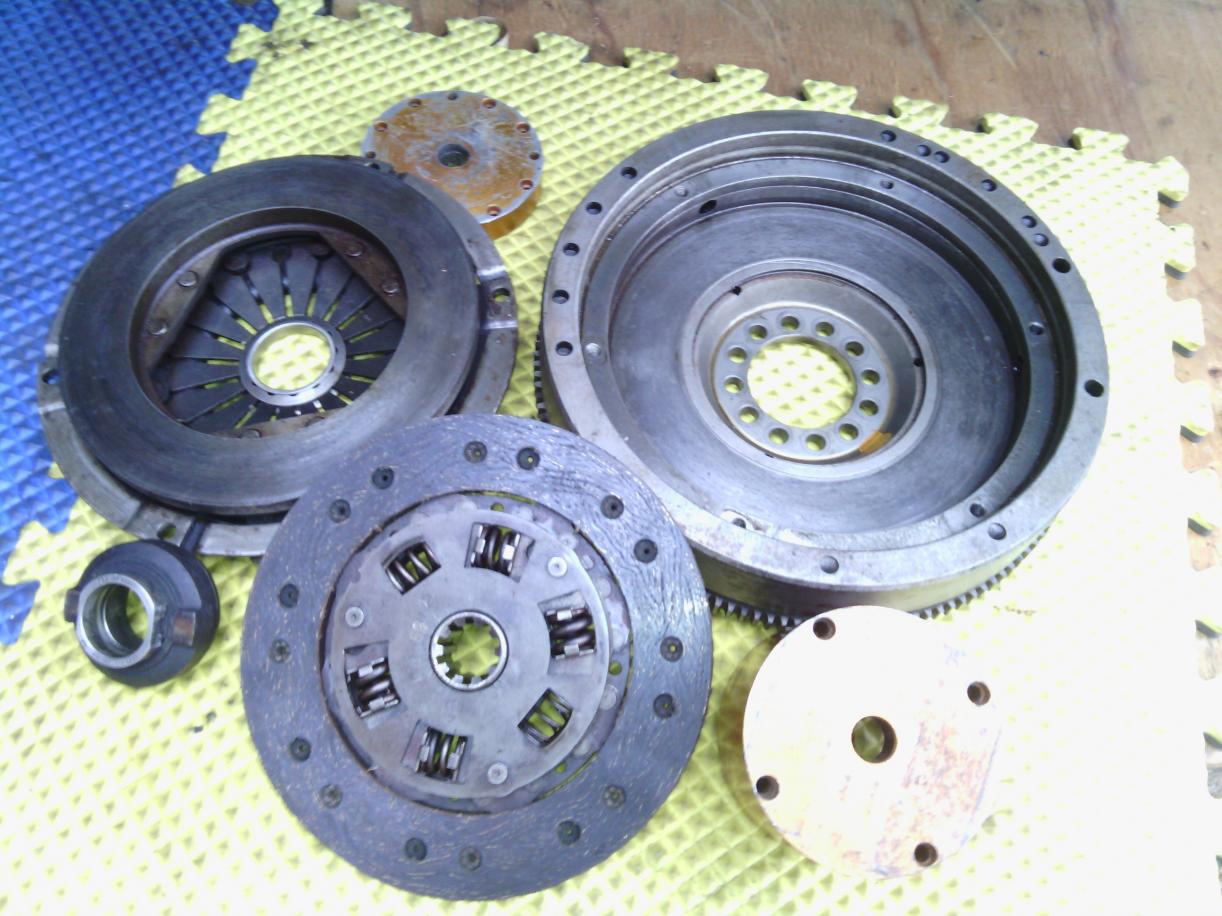

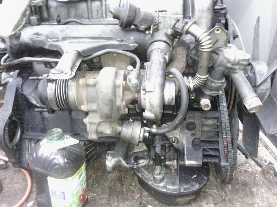

I picked up a manual flywheel, clutch disk, friction plate and throw bearing super cheap!! Actually I have two sets.
Attachment 21095

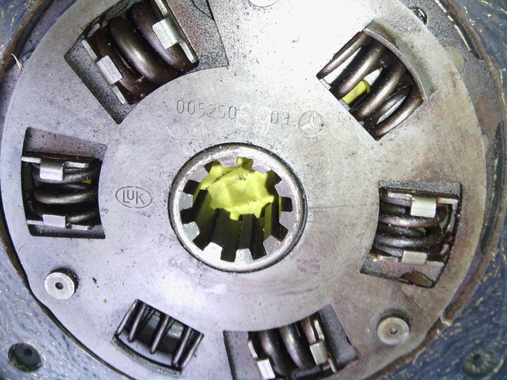

This is the Benz 10 spline clutch disk that i want to use but the input shaft of the Rover R380 has 22? splines
Attachment 21096

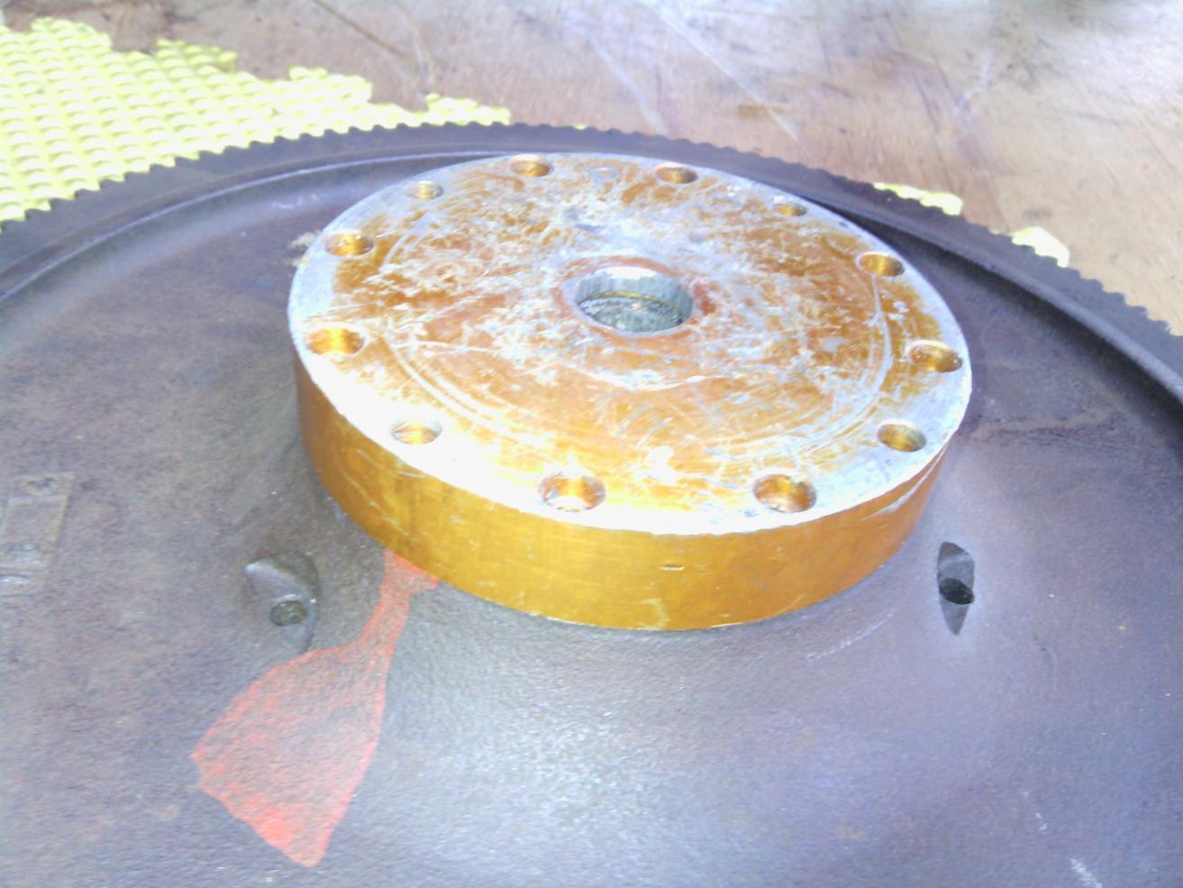

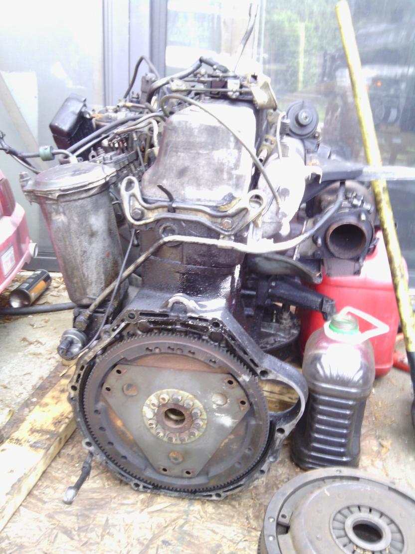

This is the crank side of the manual flywheel with my aluminium disk setting on top that may space the flywheel.If you look closely, the inside bore of the disk is close to the OD of the input shaft of the r380.
Attachment 21097

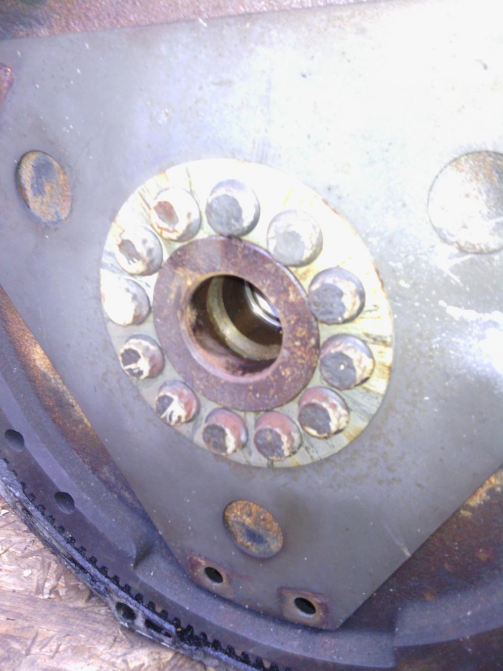

This shows the larger bore that the torque converter goes into motor side. The Rover uses only a thin bronze (sleeve) or spigot bushing and I need to adapt to the flywheel or get a bearing to close the distance between the R380 input shaft and the bore of the flywheel or crank flange. This auto flywheel is to be replaced by manual flywheel.

How much did you pay for your 240 flywheel setup, I need to start keeping my eyes peeled for one. I'm not sure how difficult they will be to source. Finding the right flywheel / flywheel ring gear / appropriate starter was already a mess I fought with the diesel ranger. Keeping it benz is the way to go for a lot of reasons.
I don't remember reading about that aluminum spacer in between the crank and the manual flywheel when I skimmed the thread for the first time, I'll go back and read it again. I kinda jumped towards the end the first time I ran across it, most threads died years ago with nobody really getting anywhere on the project.. except the illusive Jarek.
Did you just make your aluminum spacer at home? How thick is it? Obviously without both the Engine / Trans and flywheels sitting in front of me it makes it a bit difficult to measure. With whatever thickness that aluminum spacer is, how thick is your adapter plate going to have to be? I'm assuming that your bronze sleeve / bearing gets pressed into that as well!

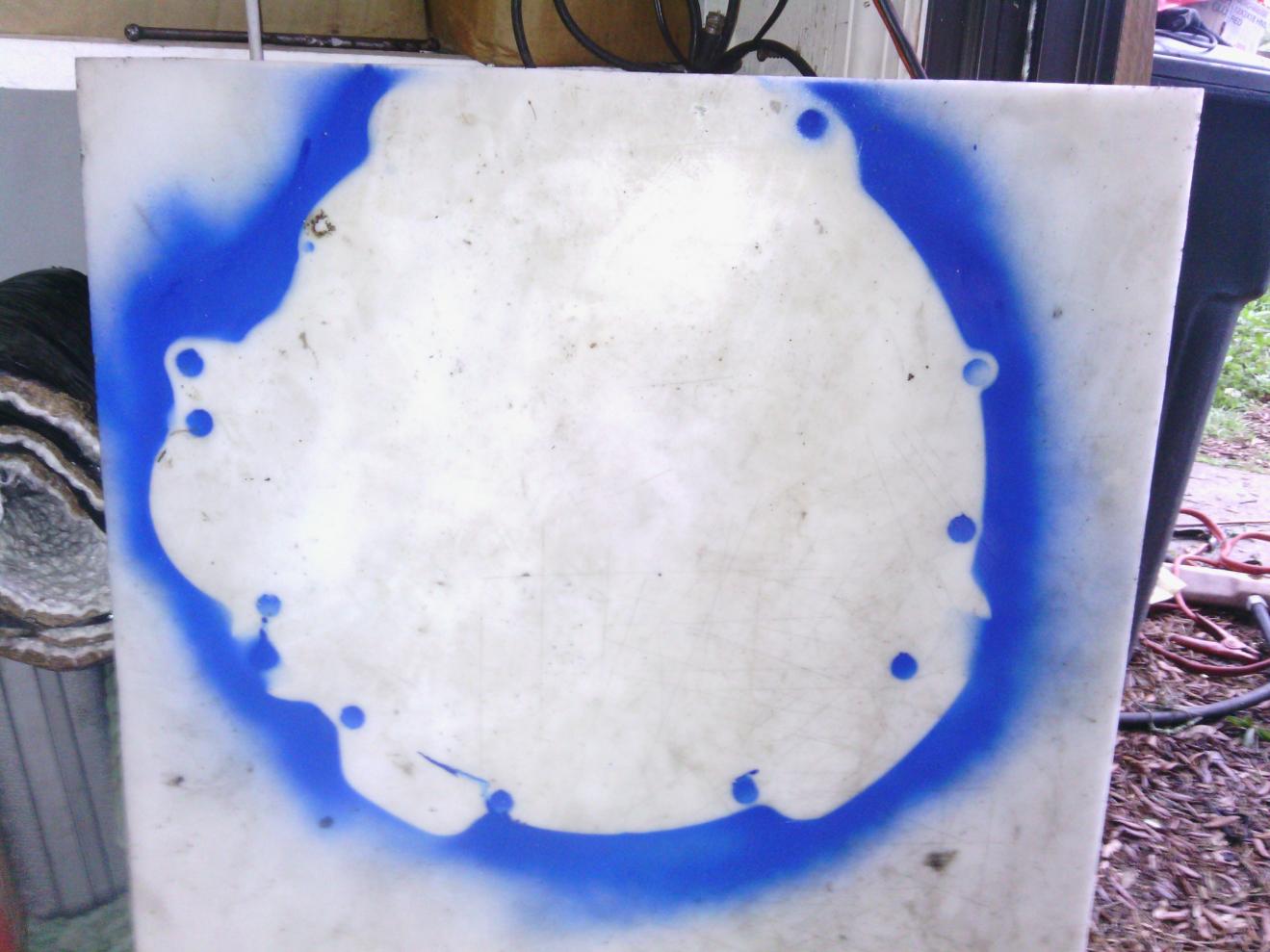

In white is my HDPE plate approx 3/4 in and i took a spray can to the back of my core zf4hp22 bell housing /// new comers know i will be using R380 manual and NOT a zf4hp22 auto box. I did this print assuming the r380 and zf4hp22 auto bellhousing are the same.

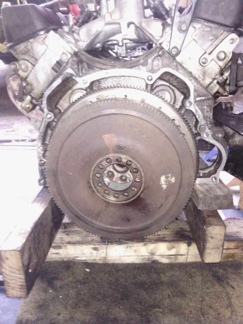

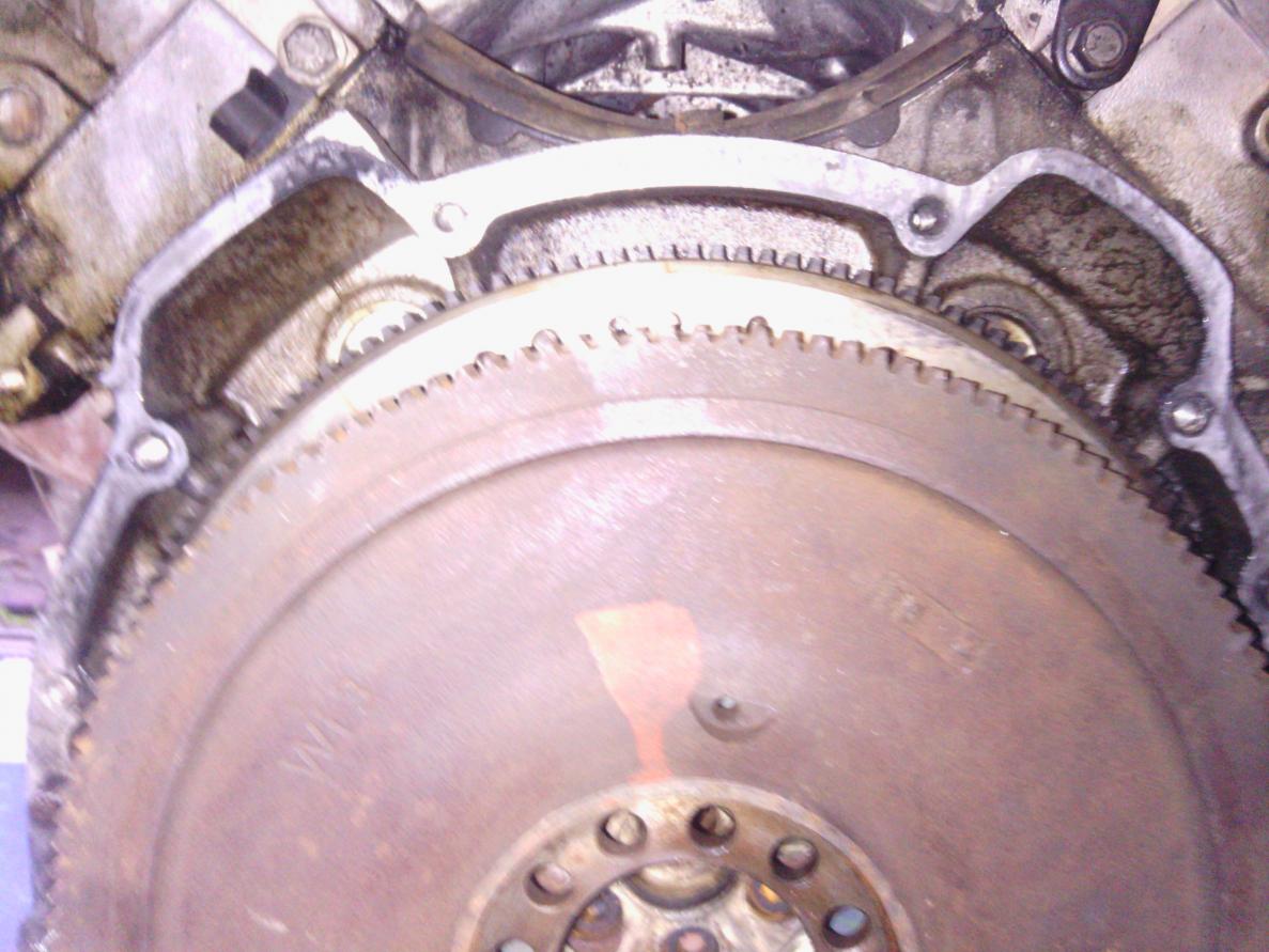

Here is a 4.0 out, a om617 out, as well as a 240D manua flywheel mounted up to the 98 4.0 with BMW flywheel and there is absolutely no play in drive plate from bmw to OD of my 240 flywheel. The benz 3.0 5 cyl om617 absolutely drwarfs the 4.0 rover v8. Un believable!

On the adapter plate, that sucks but you can get for a 3rd of the cost HDPE material that will do the job. a 4x6 sheet costs about 130.00 Find a local distributor of plastics and they will hook you up. I plan to use it and if it does not stand up to twisting and heat, I can make about 4 templates...lol
