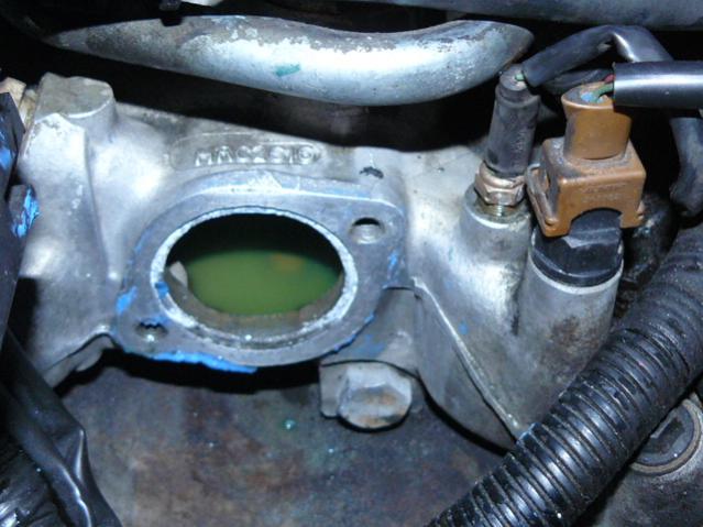

The coolant temp sensor tells the system how far to adjust mixture on cold starts. If you have a scanner, unplugging my coolant sensor made scanner read -40 F. So you might have a bad sensor, or bad wire, and it might show up as an out of this world reading on a scanner - when it is + 25 F outside, the motor should not think it is -35 F, etc. From the grille, look at upper hose where it enters engine. Two sensors are vertical to the right of that, the single wire runs the temp gauge, and the two wire with kinda square plastic top is the coolant temp sensor that drives the ECU. Pix - https://landroverforums.com/forum/at...s-p1120328-jpg

I'm going to go ahead and back up these guys with the coolant temp sensor going bad.
The one for the ECU, not the dash gauge.
The one you want is ontop of the engine next to the thermostat.
