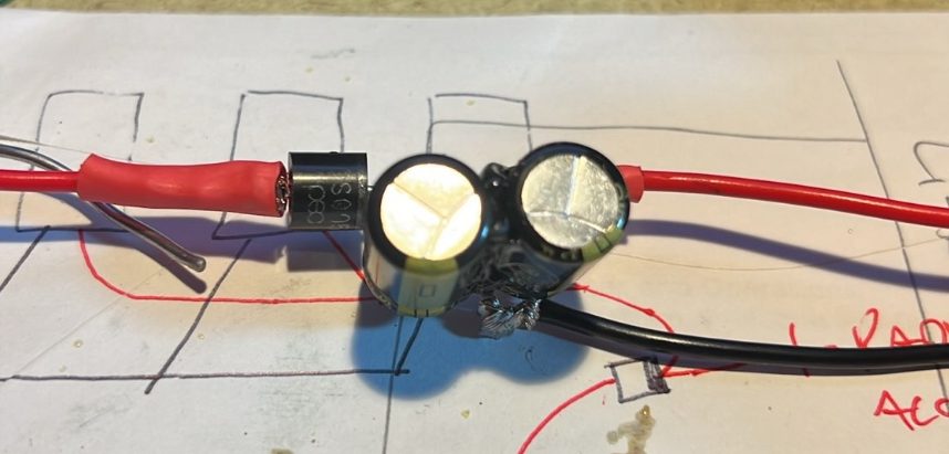

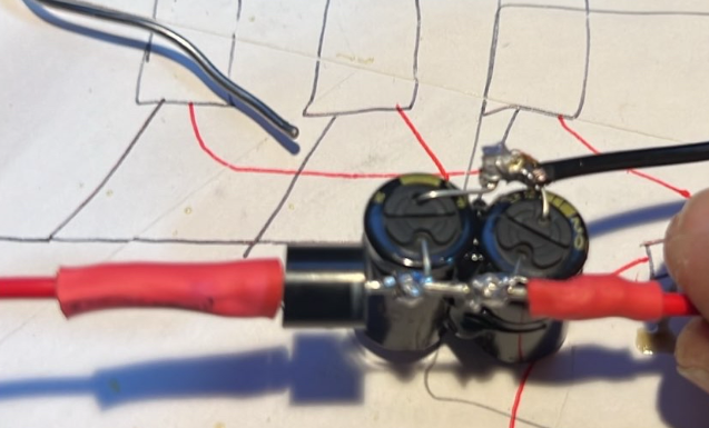

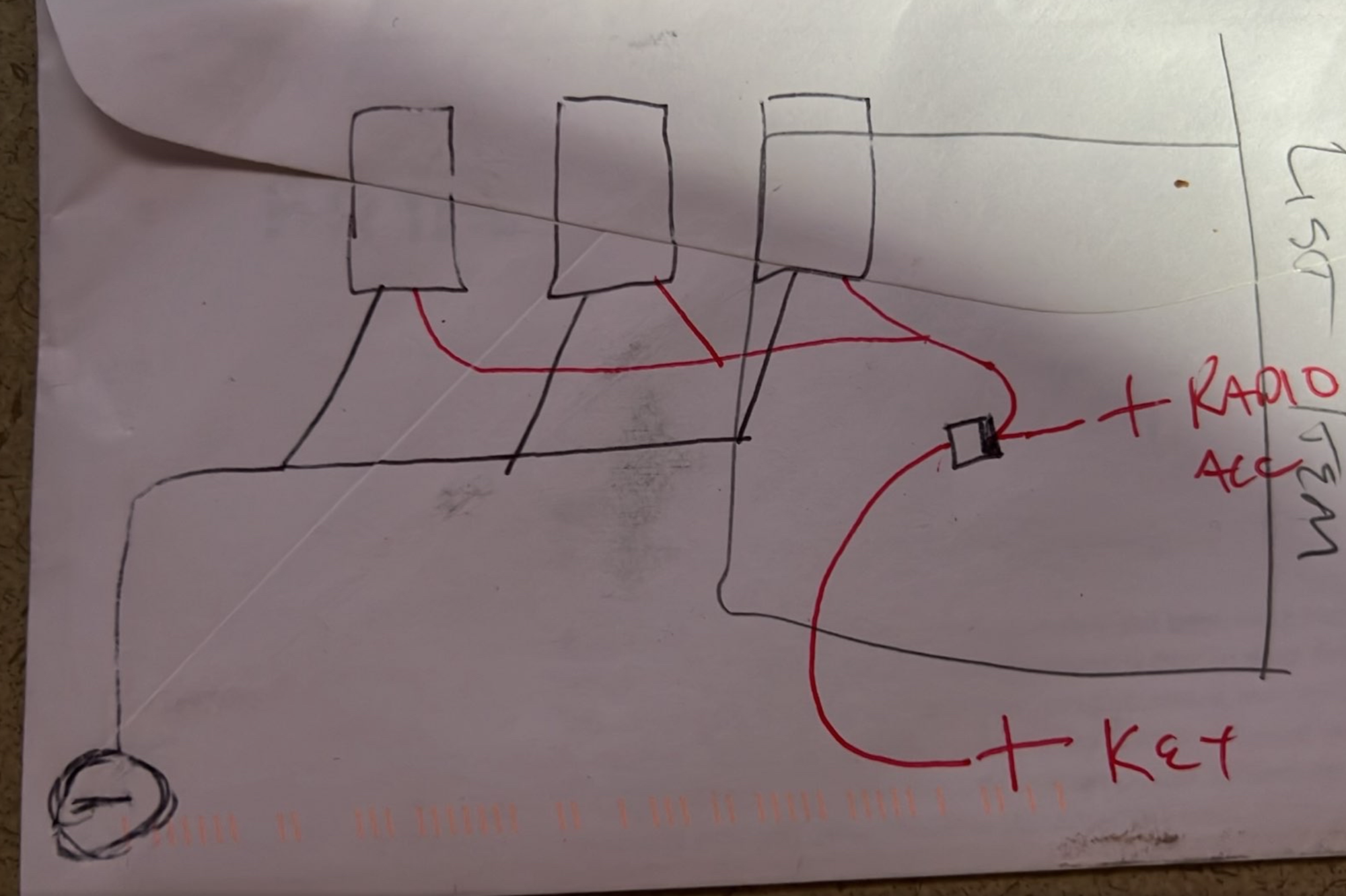

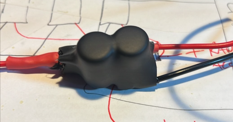

Well i wound up doing this with capacitors and I get about 15-20 seconds of power and it works.
Diagram (Wound up only using 2 1000 capacitors and a one way diode
soldered and wired
bottom
shrink wrapped
