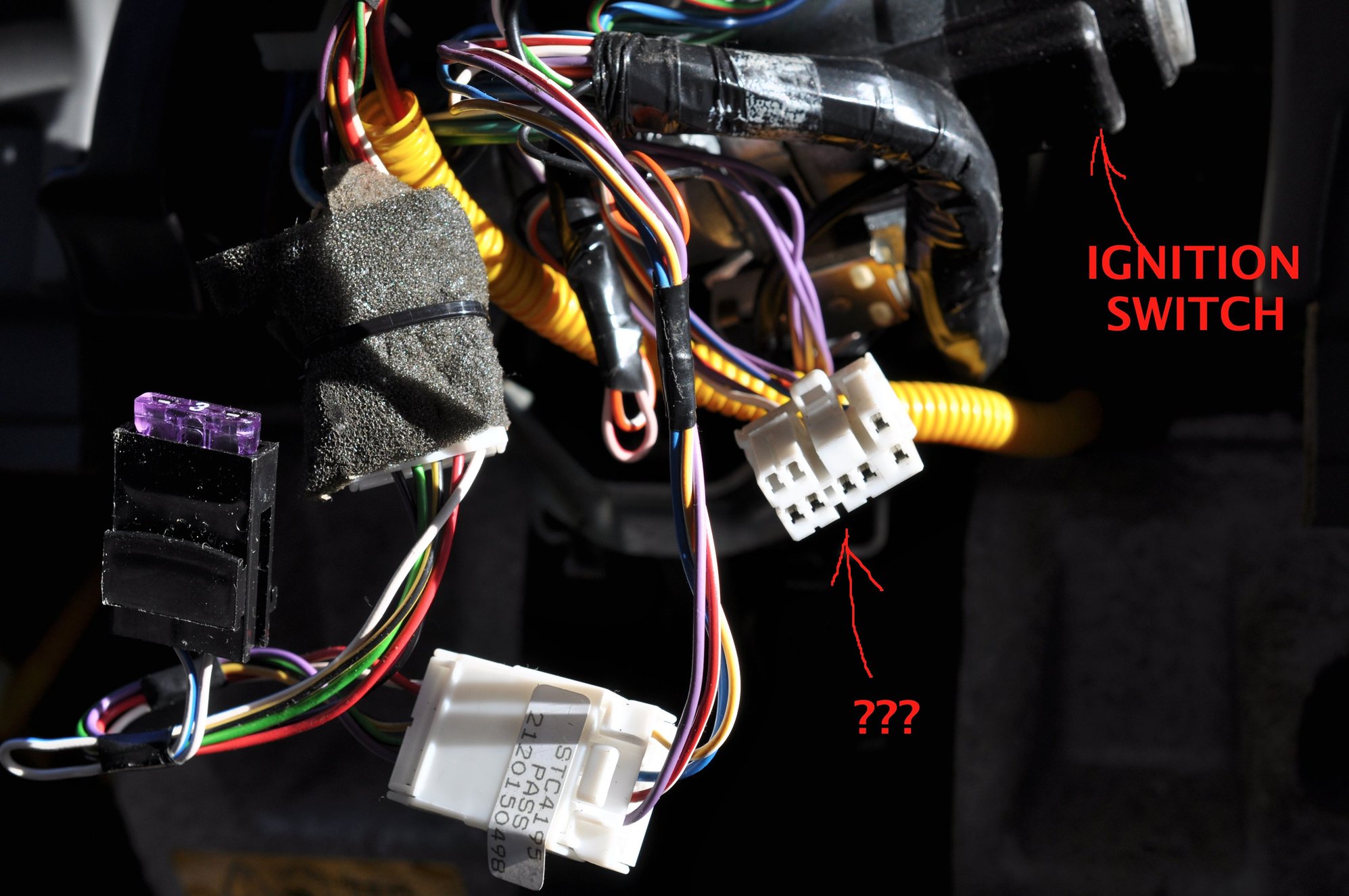

Our '96 Disco 1 has had the airbag/SRS light on ever since I got an alignment. I removed the "clock spring" that tested badly for one of the circuits. Obtained a used replacement that tested fine. Installed it and the SRS light is still on. When I installed the replacement part, I saw an electric plug that doesn't seem to go anywhere. I don't remember unplugging this connection and so wonder if it is for something not on our vehicle.
There are two plugs that are connected (one is wrapped in grey foam for some reason) and a 3 amp fuse, but the 3rd plug has me baffled.

Here's a picture of the "extra" plug that I couldn't find a mate for. Of course, this is a Disco ! (1996) - obviously much earlier than your model.

Here's the mystery plug I mentioned (hope the picture comes through)

that plug is not relevant to SRS. All SRS items will be yellow plugs
