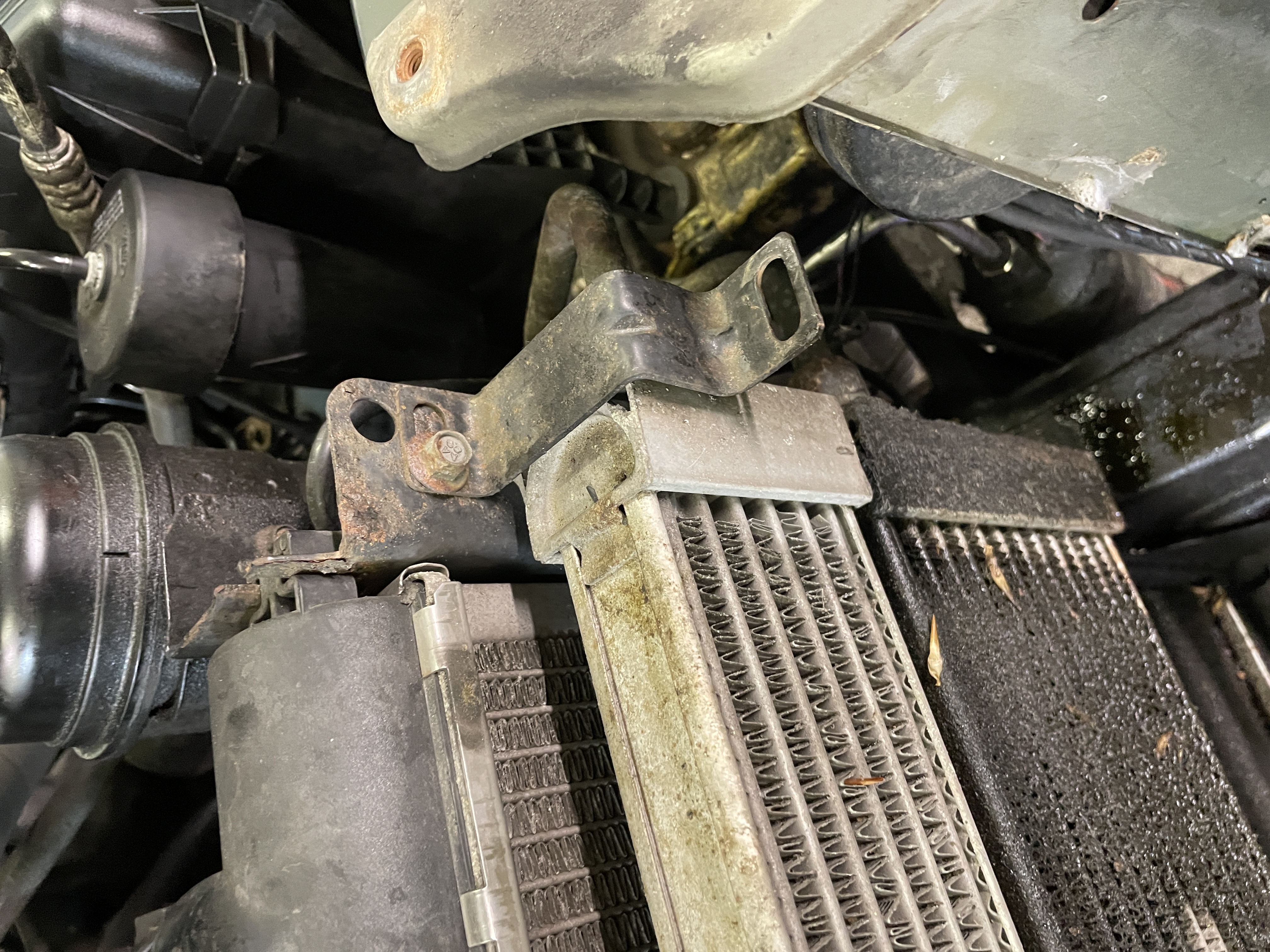

Well, it’s not the fans, as I have check All of them and they are all working at full.
I either still have an air blockage in the system or gunk creating a blockage.
I posted a new thread on it today as it does some weird things with the e-brake on and off on the cluster gauge.

blockage can be a real issue.
Attached Thumbnails A/C on only leads to overheating-jpeg_2021-07-06_08-59-44_3.jpeg
