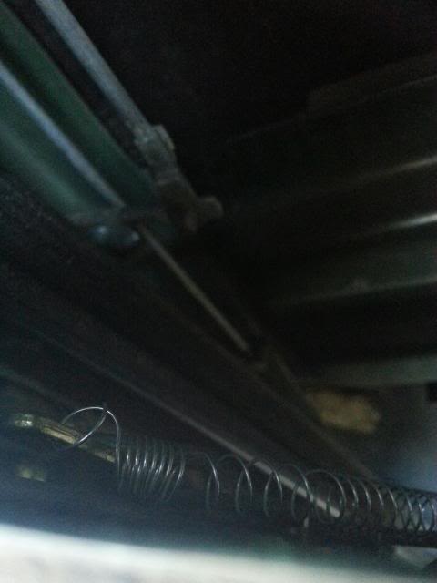

-between the door lock actuator access hole, and the lower access hole, you'll find a shiny lever with a small hole in the top. if you move this lever left to right, you'll see the door lock pin move up and down. attach a spring to the little hole atop this lever, and the other end of the spring to the rod below. when doing this you'll notice the door lock pin moves up to the unlock position.

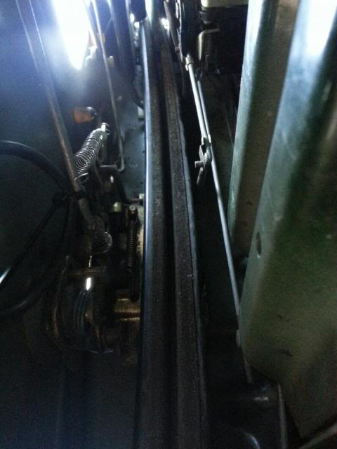

the image below is looking UP from the lower access hole on the door panel. see the fancy new spring on the left side? haha.

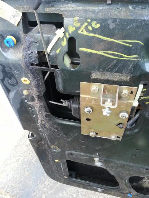

the image below is looking down thru the upper access hole (next to the door lock actuator)

-here's the caveat tho, too much tension on the spring will disable you from locking the door- the locking pin will pop right back up. so stretch the spring (releasing tension) until you are able to lock the door and the door pin stays down. this took me about 5 minutes of trial and error.

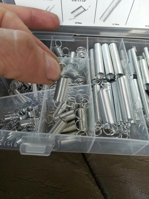

the final image shows the $5 box of springs i bought from harbor freight. i'm holding the spring i used.

Looks like it should work at least for a while
Correct fix are these tiny springs on the door latch assemblies that break and are a pita to replace
