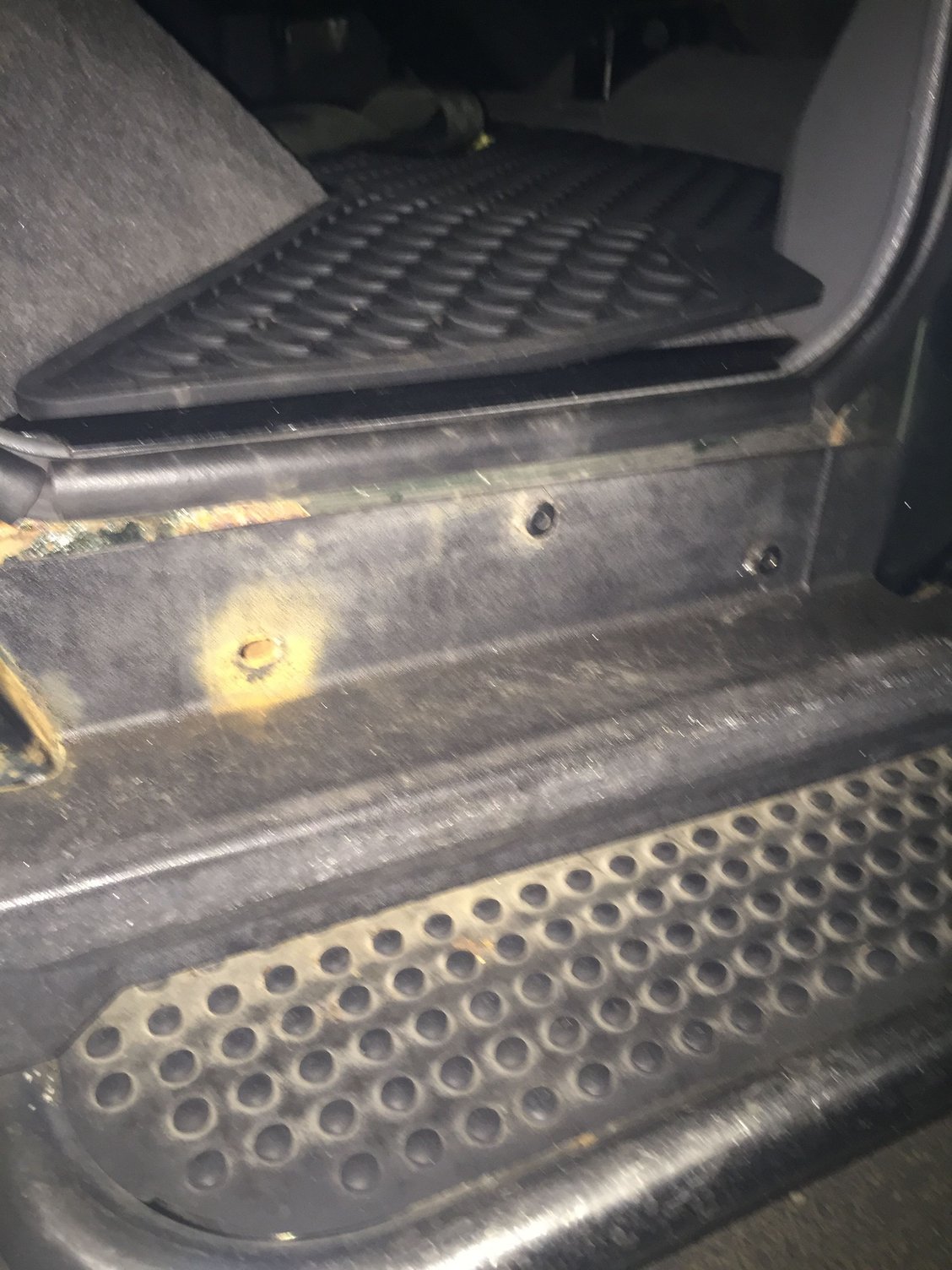

Thanks for all of the feedback! That looks like the spot but the plugs are a little different, they are not rivets unless I am missing something? Here a couple of photos. Is this thing can be a pain to get back on once I get if off?
You can see the rusty hole where I removed this one.

Thanks! It does look different what I removed seemed to be a plastic plug not a rivet. Is this going to be a pain to get back on again too? Where is there fiberglass.

This is the plug I pulled out of the rusty hole on the right.
The short answer is YES because you are not doing STEP 3 and punching/drilling the center spreader insert (the square flat bit in the pic below) through the rivet.
The rivet is STILL EXPANDED...… You are making more work for yourself for sure trying to remove it like this!
If you are just using a panel popper tool to remove the rivet when it's still expanded you are going to enlarge the mounting hole.
Using "force" to pull the expanded rivet through rusty metal =
And if you don't like the rivet style sill fasteners then there are other types. Have at it and good luck!
