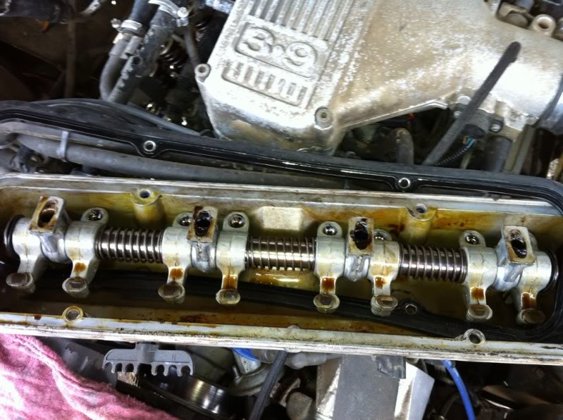

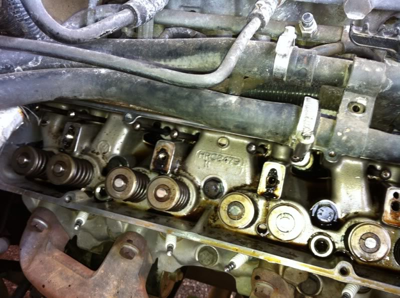

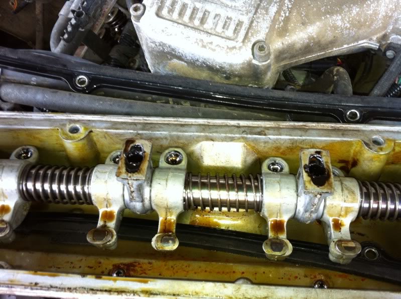

Update. Since it is so easy to pull the valve cover and rocker, I did.
Rocker

Close up of the center of the rocker.

With rocker removed:
Is it just me or are those oil passages by the bolt holes really gunked up?

You didnt say anywhere in your posts the condition of cam or tappets? You can do a head gasket job and not check the cam side of the tappets.
I'd like to see some pics of the cam and cam side of all the tappets.
Edit - Everything in those pics is normal
