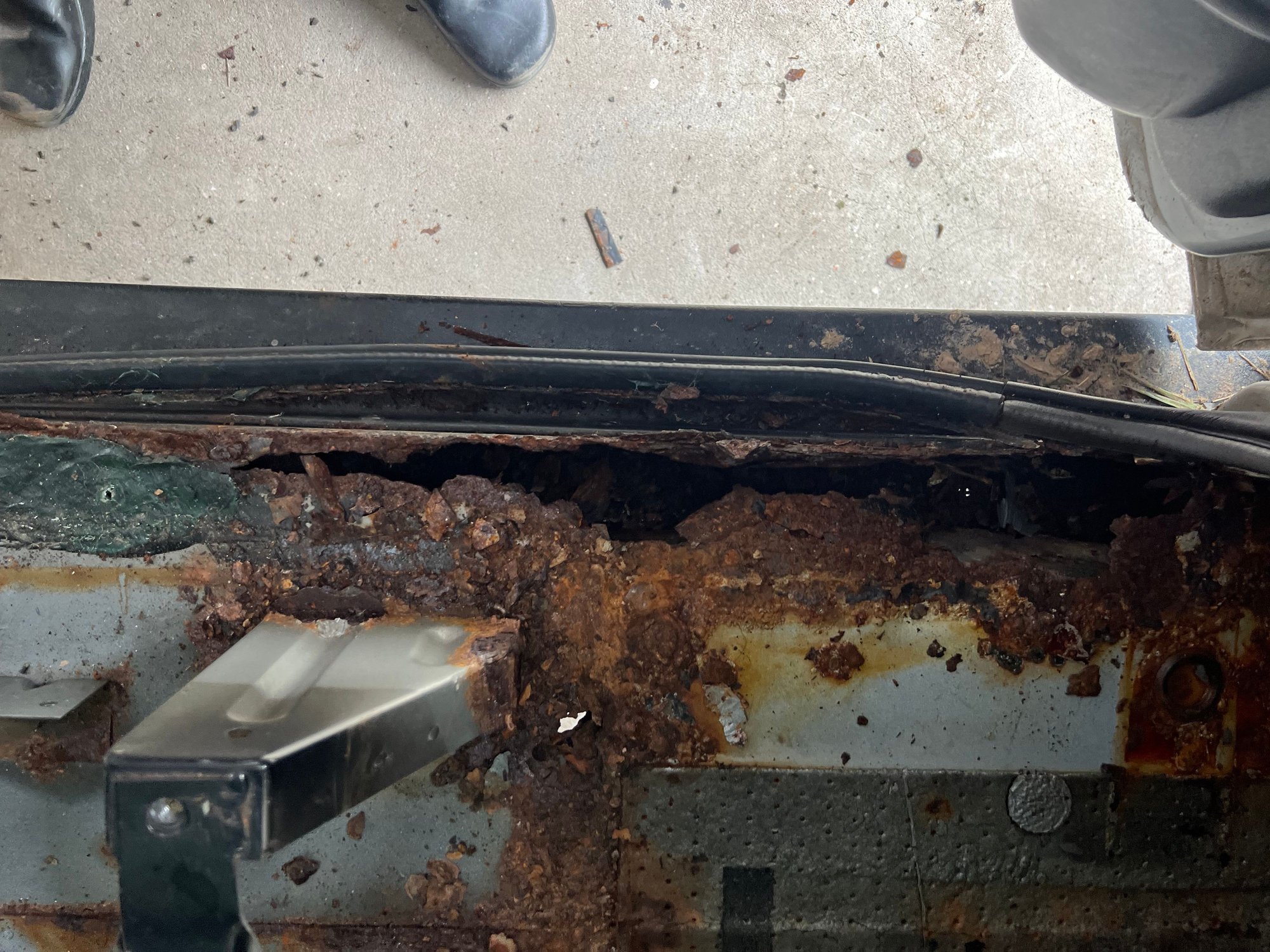

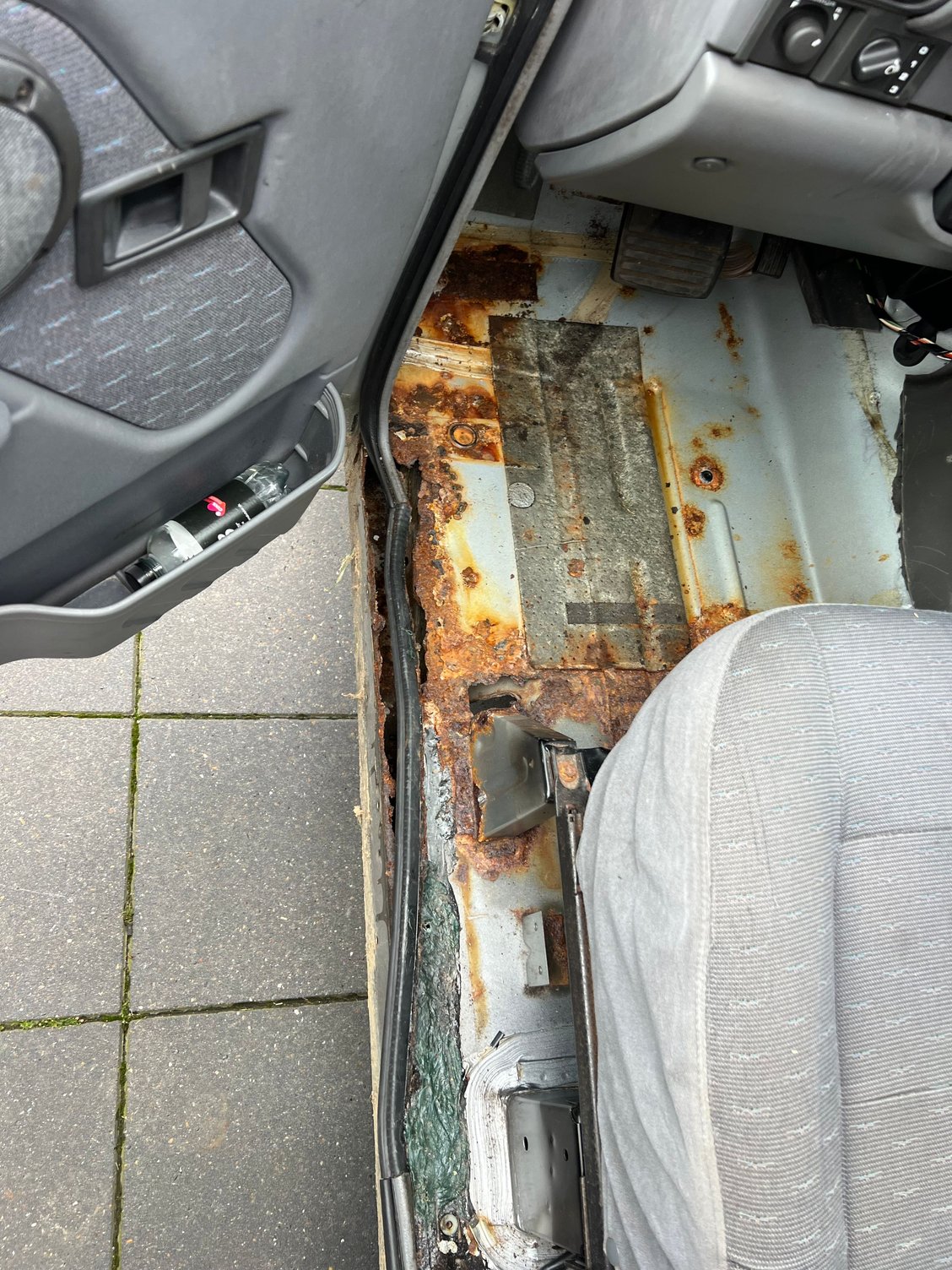

just got my self a 96, 3.9 auto.
I knew that there was rust - just not how much!!
Well, we will just have to sort that out.

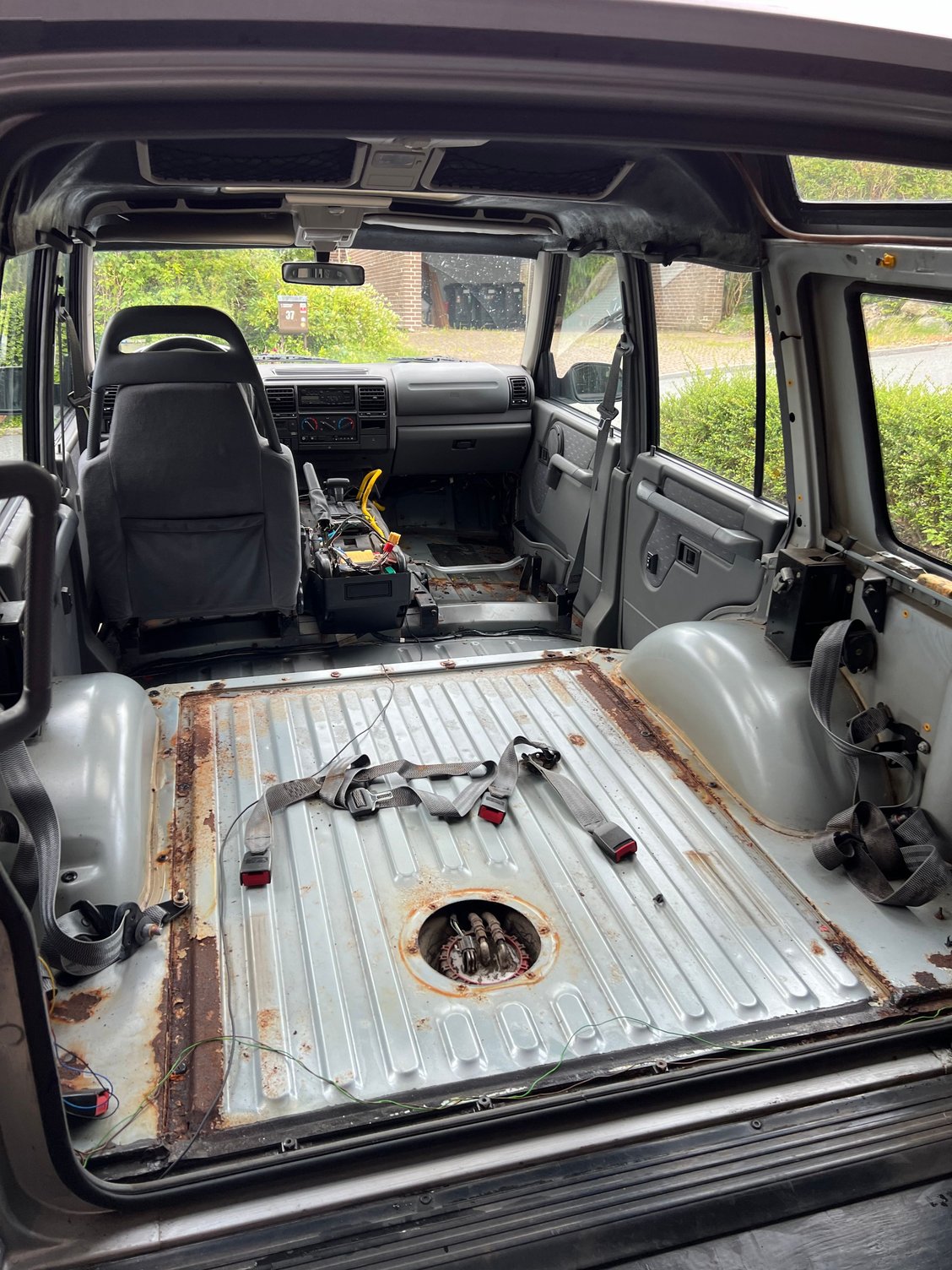

I Can find lots and lots of floor panels for the rear cargo area, but none for the front footwell of the the seat base? Will also need the crossmember under the rear seat?
Am I looking all the wrong places?
THANKS!
Søren

if you have rust there, you likely have it at the lower A, B and C pillars and lower sill.
Remove the plastic trim under the doors to inspect.
I read a thread a while back where someone used box steel for the lower sill - it was a little bit bigger but was far cheaper and then they attached sliders to it - worth looking into if it were me.
Plan on removing the front wings (fenders) and cleaning - inspect for dried/cracked seam sealant and re-seam seal at front inner wing to A pillar connection. Also add sealant to the wire grommet that goes thru the A pillar for the door controls - both outside/inside of the outter part of the grommet as well as within the wires that go thru it. (thats what finally stopped the water incursion to the footwells for mine).
