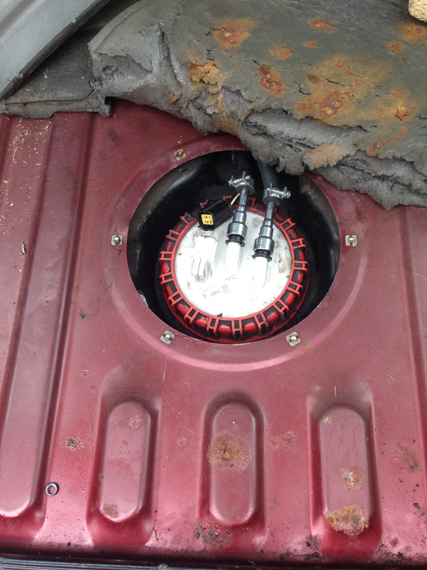

I'd say red but orange is right on, too. I was just surprised, though it would be white or grey at first glance. All that crud!

Check it out!
I want to wait basically forever before cranking because (1) I don't want to be bummed and (2) it's gas fume Heck in there.

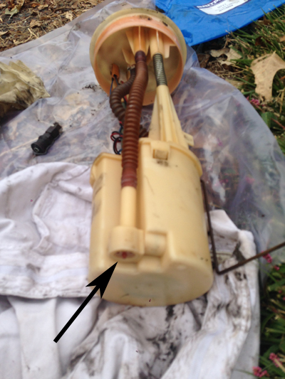

I thiiiiiiink I found the cause of the failure. Where the arrowhead is, the nipple descending was blocked by a piece of pink rubber. I flicked it before documenting, but it was preventing the nipple from clearing that hole. When I flicked it away, the nipple clicked back into place. So I think it had a big blockage. Unless anyone else sees any issues?
