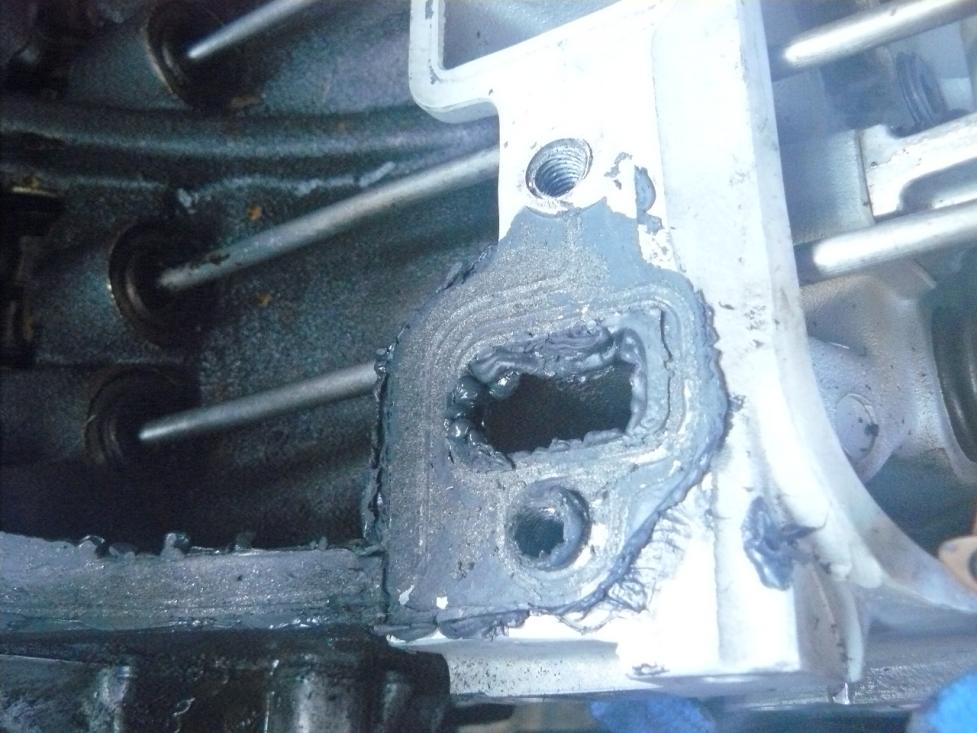

Tuesday - cleaned up intake again, must have used a little too much RTV, spread very thin is the next plan.

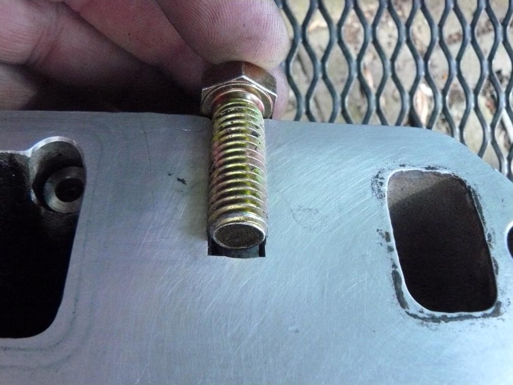

The slot under the water hose connector (no hole) won't pass the 7/16. Will just have to get out my Armstrong Milling Machine (flat bastard file).
Holes in valley pan gasket clear a 7/16, but barely, so alignment would be even more of a problem. Enlarge? Comments from attending partz vulturez on higher branches of the shade tree are encouraged.

I've never used RTV around that coolant passage and I don't think the RAVE calls for it. And none of my valley pan jobs have leaked there. Only goop up the RTV in the corners of the end gaskets.

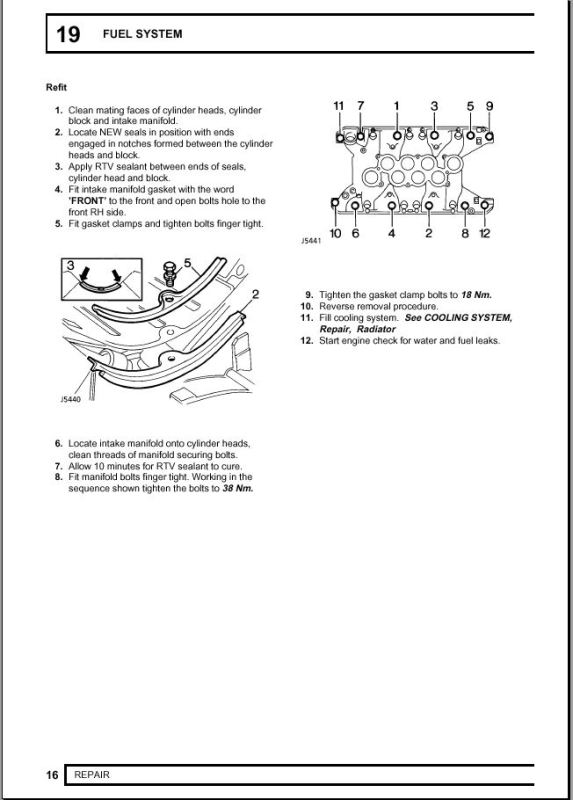

On first try, I had just one that stripped out, so tried the generic helicoil route. I suspect that their stated drill size is for steel, and it stripped out. On second try I had more regular holes strip out and then I "discovered" that torque in RAVE for a D2 and some Rangies is 51 nm and D1 is 38 nm.
Since gaskets didn't line up, I though about using the method on Cannibal's web site
Valley Pan Gasket & End Seals - just used too much. Agree should not need it per RAVE, other than corners, but with alignment I was trying to cover other possibilities.
So now I am set to start tapping, but want to be sure I have right sized bit for aluminum. Like in this reference. Tap Drill Chart
Also wondering what impact larger bolts will have on valley gasket alignment - the existing gasket holes are just a clear drill for the 7/16.

At this point, with new head bolts torqued down, I'd be looking at new bolts for heads I guess, although some will say measure them and re-use as they have not gone thru any heat cycles. Since I now have to drill and tap new holes for intake bolts, enlarging those in the gasket can also be done. Perhaps avoiding second set of new head bolts and re-do of that.

One thing about the RTV, it left a trail that showed gasket was lined up better than I thought.

Buzz,The way it is shown on your link is how I did mine with the ultra black rtv and let sit for a few days to be sure it is cured

The RAVE method has never failed me. And seeing all that RTV cakes inside the intake should tell you something.
