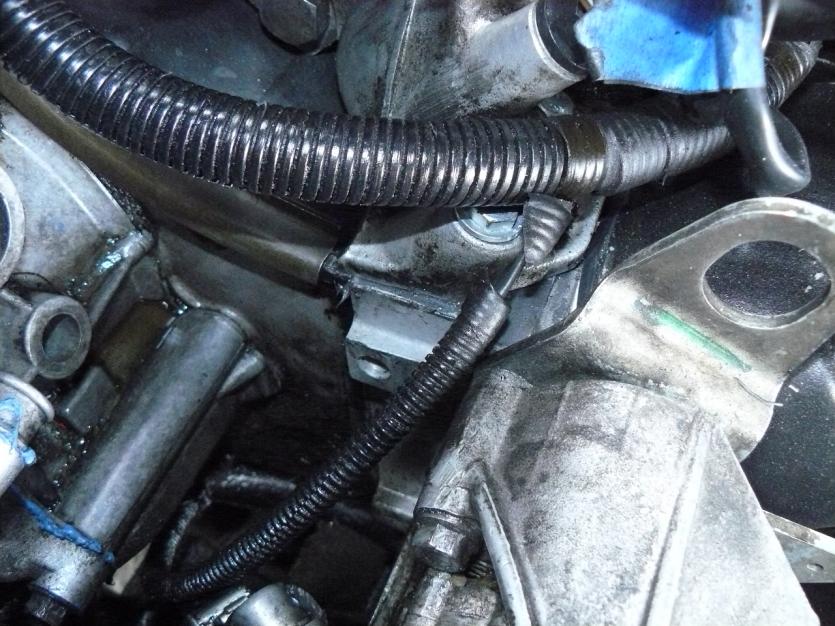

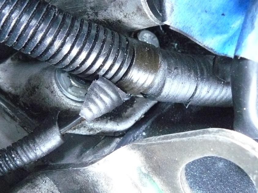

The oil leak continues. Puddles on top of front cover. Think it is coming around the front corner of the intake from valve cover. Suspect the edge of the intake (messed up alignment) is pressing against the VC gasket or VC lip. Will have to pull off throttle body a take a better look. Already snugged up bolts I could get to on VC. Not taking intake off if I can avoid it. This is the one side where I have a single 7/16 bolt....
Guess there should be some space between VC gasket and intake.
And yes, there is that green line on the PS pump bracket, badge of honor from the boneyard, we recycle.
Noobs - Boneyards usually mark their parts with a color, to indicate what month it was bought, in case of a return. Parts with odd splashes of paint or letters drawn in paint may indicate partz vulturez had a hand in keeping your Rover rollin' .

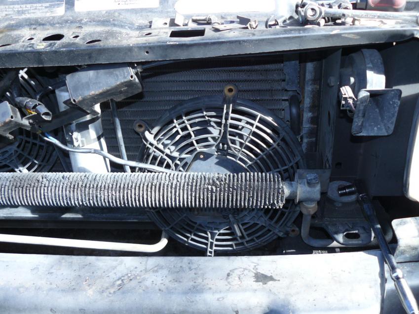

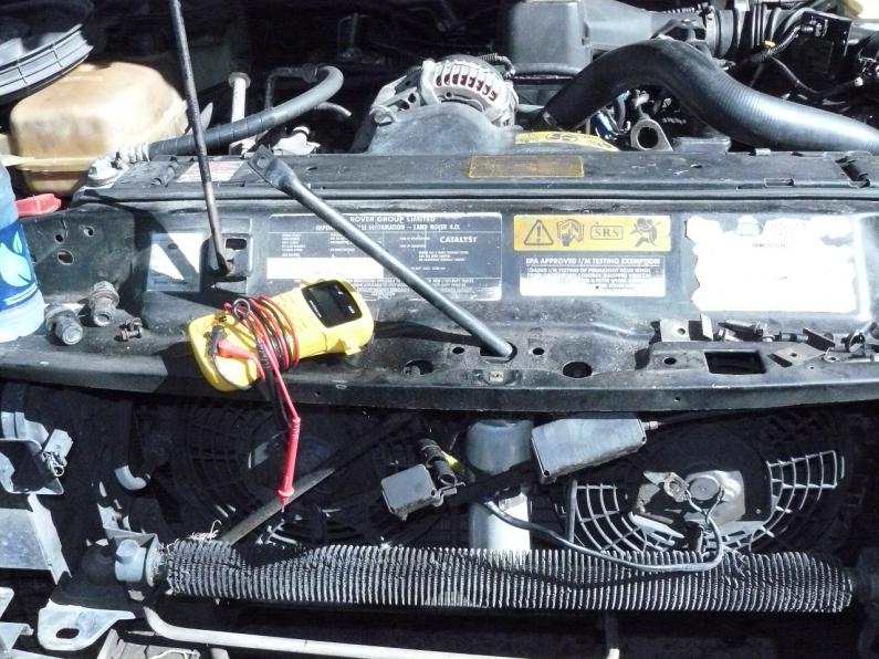

Well... found something upon close inspection. One of the two AC cooling fans was not turning. Poke blade with a long screw driver and it started running, but not with the vim and vigor of the other one. Could stop with screw driver. And until nudged again it would not turn.
So at idle less air flow than expected, and the inoperative fan blocked air flow as well.
I had heard the the "singing" of the AC fans, I had checked with a paper towel to grille, but I had not put the Mark I eyeball on it.
Off with the front guards and grille for this, I have spares on the shelf.

Well, I took mine off, and the oil cooler I unbolted but did not remove. Gave enough space to slide it out thru the top, it would not go out the bottom.
That diagonal crossmember comes out, thru the hood lock hole.
With AC on, outdoor in mid 80s, evening, went for 20 mile ride at 60. Thermsotat stayed at 183F. Slowed down and turned at a light, up to 187, then back down. Parked at idle when home, after 25 minutes it had reached 207F. Seemed to take longer to rise up with second fan running. Will do more tests in daylight tomorrow.
