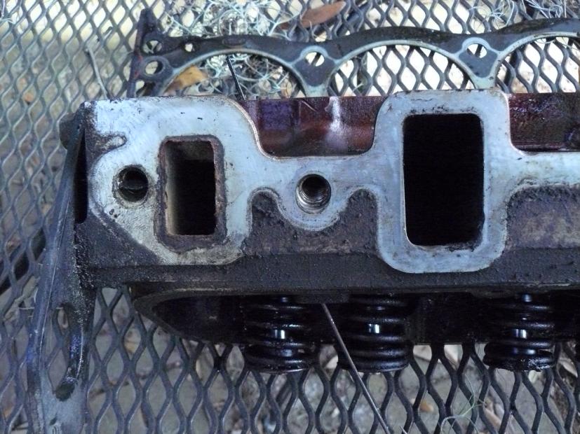

Don't believe we have enough material for those sizes. The head is not continuous, it has open areas to save metal. Note pix of original head before machine shop, and there seems to be some smooth area in that hole as well. From another angle each hole boss is visible, and 1/2 would not leave much.

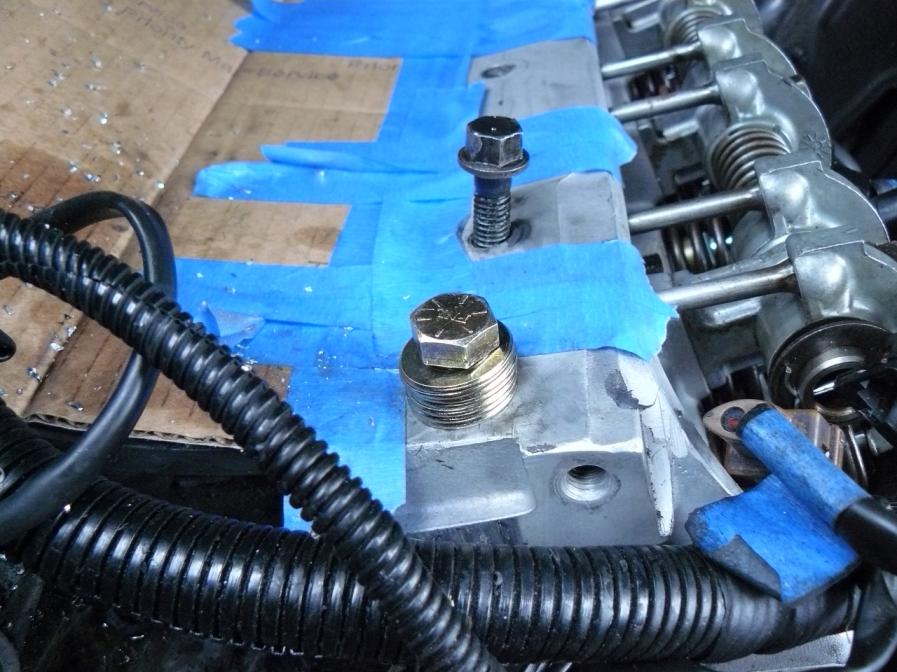

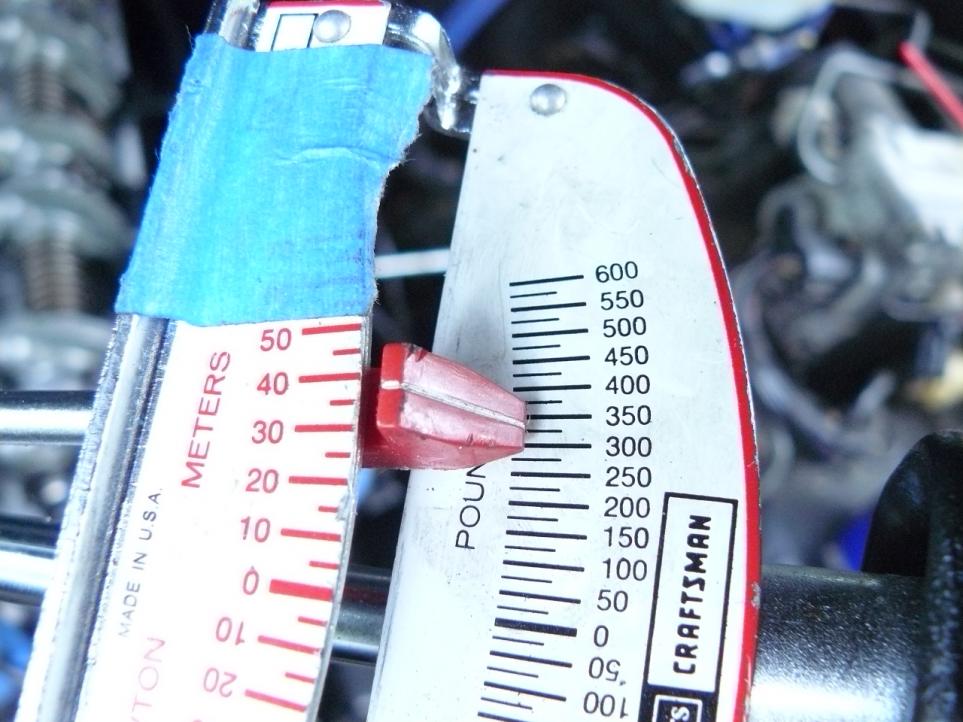

Since only top of hole was stripped, tried a new helicoil all the way to the bottom. Which was threaded with the tap. And a second coil (about 1/2 of that stuck out) on top. Trimmed of below flush. Tested with a bolt and washers, got to 25 NM. Repeated with partial coil removed. Had aluminum on the theads, which must come from the area of the hole where tap had not cut out to full size. I suspect the issue is that the 25/64 original bit is just too large for aluminum...
That metal rod poking thru is the one and only oil channel to each head. A second passage is drilled, but does not exist on the engine block. This allows heads to be universal rather than left or right hand.

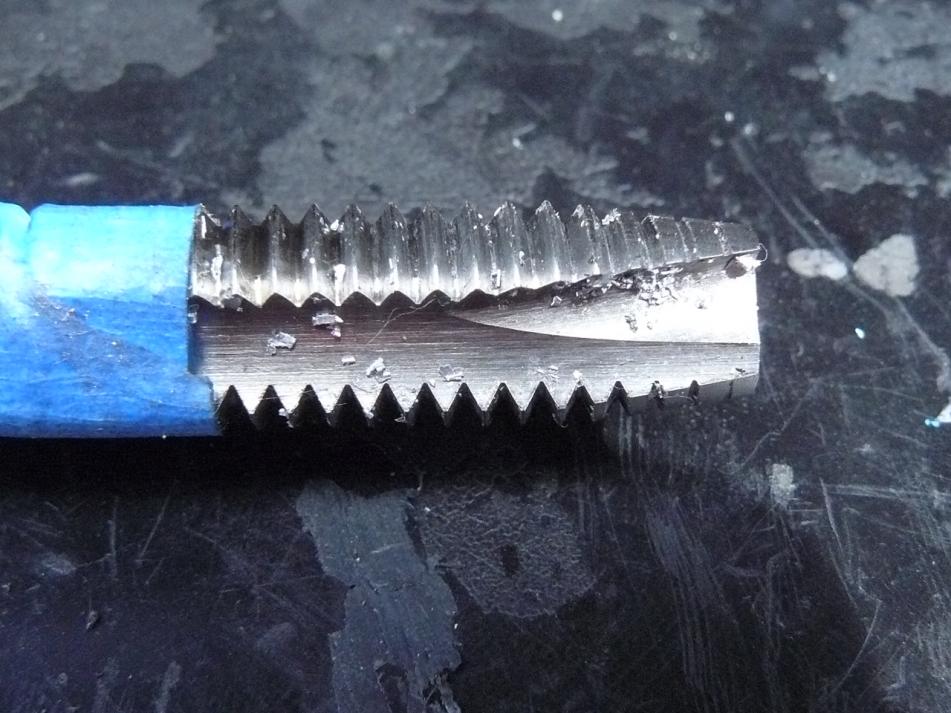

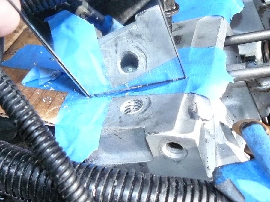

Decided to go with 7/16; drill to size "U"; and thread for new bolts. First one done, and tests to 40 nm. The bolts are drilled slightly off from 90 degrees. This tap is the closest commercial model to what ihscouts described as the way to go.

As I expected, got to the hole that had been drilled and helicoiled for 3/8 with a 25/64th bit. Drilled out with the U bit, and tapped for 7/16. But since hole was too large to start with, I was basically threading a portion on old threads, never a good idea. Result failed at 20 nm with 7/16 bolt. This one I will have to drill out a bit larger and use a 7/16 helicoil (bought today).
