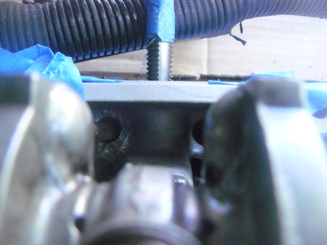

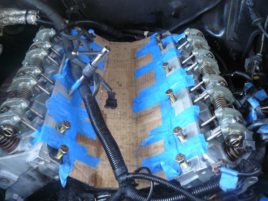

Have made minimal progress due to rain and schedule. Made good progress so far today. 7/16 helicoil went in OK with a 27/64 drill hole. Rest are regular "U" drill size holes and thread for 7/16. If I was doing this again I would have made a "jig" that could be attached to other bolts, to hold bit in alignment, it is not 90 degrees to head surface.
Not a lot of meat to drill into.

That oil separator allows oil laden vapor to be sucked into the intake and burned to reduce pollution. But the vapor has to have fresh air pulled into the engine, this comes from the throttle body side. On my D1 the filtered air from the MAF passes thru a hole in the throttle body just in front of the butter fly valve, out the side, and thru a hose into the driver side (NAS) valve cover. So air goes thru filter and MAF, thru the trottle body, thru driver side valve cover, thru the valley (under the "roof" formed by the valley pan), thru the passenger side valve cover, and into combustion chamber. My oil separator was broken into two pieces, it can't fall down inside because of the metal baffle. I found the second piece on top of the transmission. On my driver side, the port from valve cover to throttle body had gunk the viscosity of vaseline in the throttle body, mushed out with carb cleaner and Qtips. Seem to run smoother back when I did that.
Point is that people need to clean both sides. I guess you can tell from the pix that mine has a lot of time with clogged PCV.
A plus was that stray aluminum shavings that got around cloth and cardboard drapes were easy to find on that baked black background.

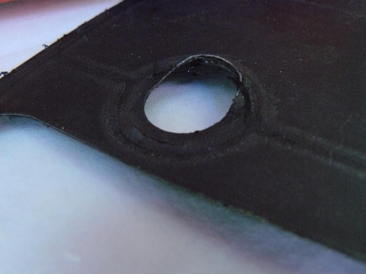

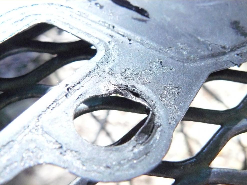

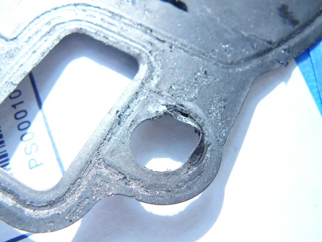

Pucker factor has arrived. See pix of up turned lip on every gasket hole. This is from install with oem 3/8ths bolts. Bolts exit the head at an angle not equal to 90 degrees.
As I am putting in 7/16th bolts, which just clear snuggly these holes, should I enlarge holes?

Buzz, you need to drop $20 on a new valley pan gasket. Maybe use a step bit on the new gasket to cleanly enlarge the holes.

If you dont want to wait for mail and dont mind paying the premium, you may be able to find something local.
I f'ed up my valley gasket the first time too for similar reasons. Was able to get a Reinz at a euro auto parts shop in St Paul for $40.
Old Jul 18, 2013 | 11:08 AM
  #180
Posts: 16,322
From: Savannah Georgia
this gasket is low miles, only torqued on the weekend, etc. lol
$42 at Advance near me, would have to order to get it here by Saturday, my next work opportunity. Really think it won't flatten out?
