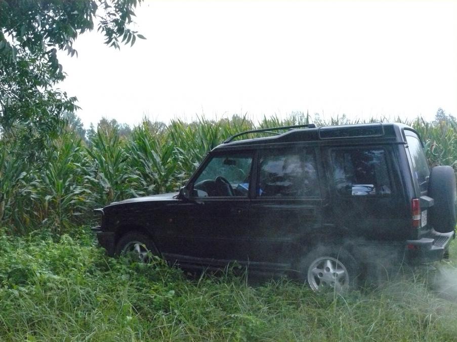

A little morning burnoff of condensation I hope. Stopped shortly after crank up. 180-183F at 55 mph for 5 miles and back. No gurgles, no bubbles under dash at WOT. Oil leak found to be pooling on top of front cover, snugged up front valley end seal bolt. Clean cardboard stayed clean for ten minutes under truck running. Except for those red spots under the steering..... another project.
Farmers owe me big time for having the Rover rain god appear almost daily for the past few weeks.
