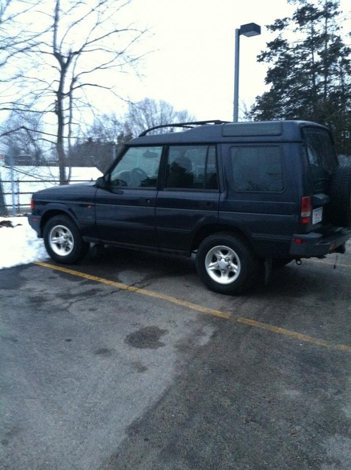

I found the service records for my 97 disco with 97k on it, and there was a lot of work done on it roughly a year 1/2 / 6k miles ago and im wondering what i have left to do on the high mileage service.
heres whats been done:
-Spark Plugs and wires replaced
-Air Fliter Replaced
-Belt replaced
-coolant flushed
-Power steering was flushed and hose from reservoir to pump replaced
-Tranny fluid replaced
-T-case fluid replaced
-rear diff fluid replaced
-and oil was changed no less than a week ago
-the head and valve cover gaskets were also replaced
-the lifters were replaced and a valve job and new valve seals
-right side exhaust manifold was replaced
-front crank seal was replaced
-Cam sensor o-ring replaced
-Steering dampner replaced
-Rear brake pads and rotors replaced
-rear hub grease seals replaced
all this work came out to like 4k because it was done by a indie dealer, i was very shocked to find the documentation on this since i figured the owner was just blowing smoke when he said he had a lot done on it recently, especially since i only paid $500.00 for this disco.
