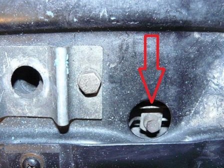

Sounds like you might need a new hood latch return spring (LR014058). AB,RN, etc. has these for about $2. Not the best pic, but you'll get the idea.
And/Or if you have the hood cable with the trunnion, you can adjust the tension on the cable.
