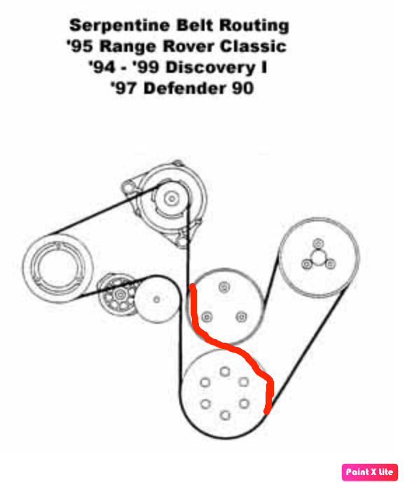

Looks like it might be theoretically possible to bypass the power steering pump by going between the crank and water pump. No idea if it would work practically. Photo attached of what I'm seeing. There is a shorter belt for early discoveries that did not have a/c. Part number ERR2678. Again zero clue how short it would need to be to still make good contact with the pulleys.

Thank you for the help! I think your right. I was able to fix it in the parking lot with a new pump Monday night. But I will measure it and put the length here in case someone else has this problem.
