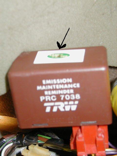

If anyone is looking to reset his or her emissions light on a 94, you will find it underneath the passenger seat in the front. Remove the plastic panel from the side of the seat and there should be a little red box that has an emissions label on it. Poke a hole through the label with a paperclip to jostle the contacts or just remove it from the wiring harness alltogether. I accidently stubmled upon it the other day inspecting the rusty seating frame which now needs to be replaced (awesome). Hope this is helpful to anyone.

here are some small pix
Attached Thumbnails Info on reseting the Emissions Light on a 94 If anyone needs to know-reminder-3.jpg   Info on reseting the Emissions Light on a 94 If anyone needs to know-2006-04-09_235801_image123.jpg   Info on reseting the Emissions Light on a 94 If anyone needs to know-reminder-1.jpg

Take that emissions box and throw it away.
Its sole purpose is to set off that light.

those are little pics. do i just unplug it? i want to get something done today.
Old Jan 9, 2013 | 02:11 PM
Posts: 16,322
From: Savannah Georgia
Just unplug. It is a really long timer inside that turns on the light. About time you did something besides wreckless eyeball the beach creatures.
