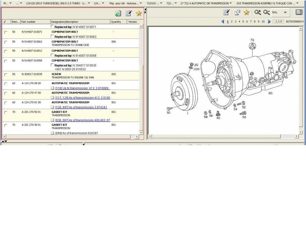

300D of that era would use a 722.418 transmission.
